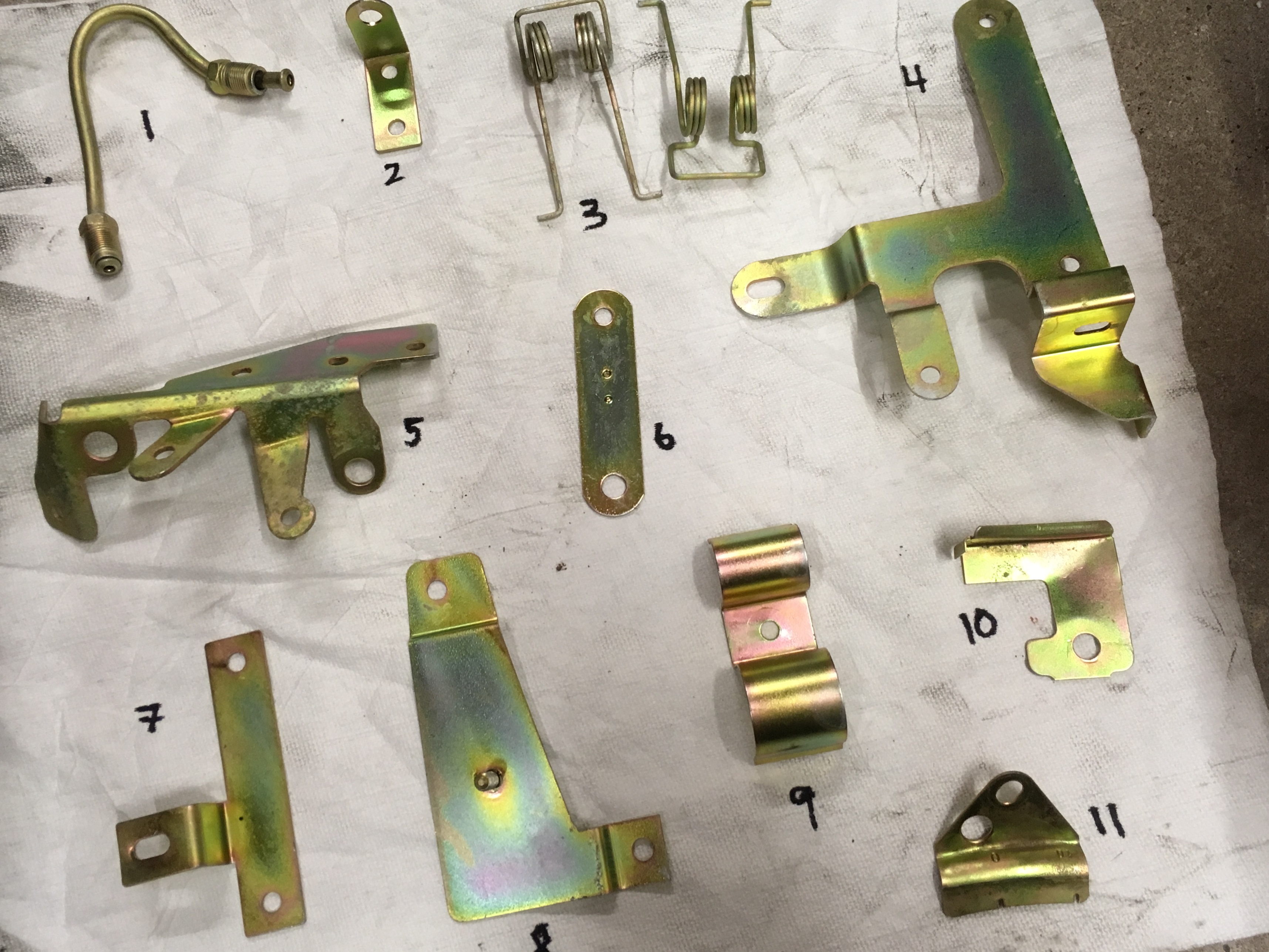

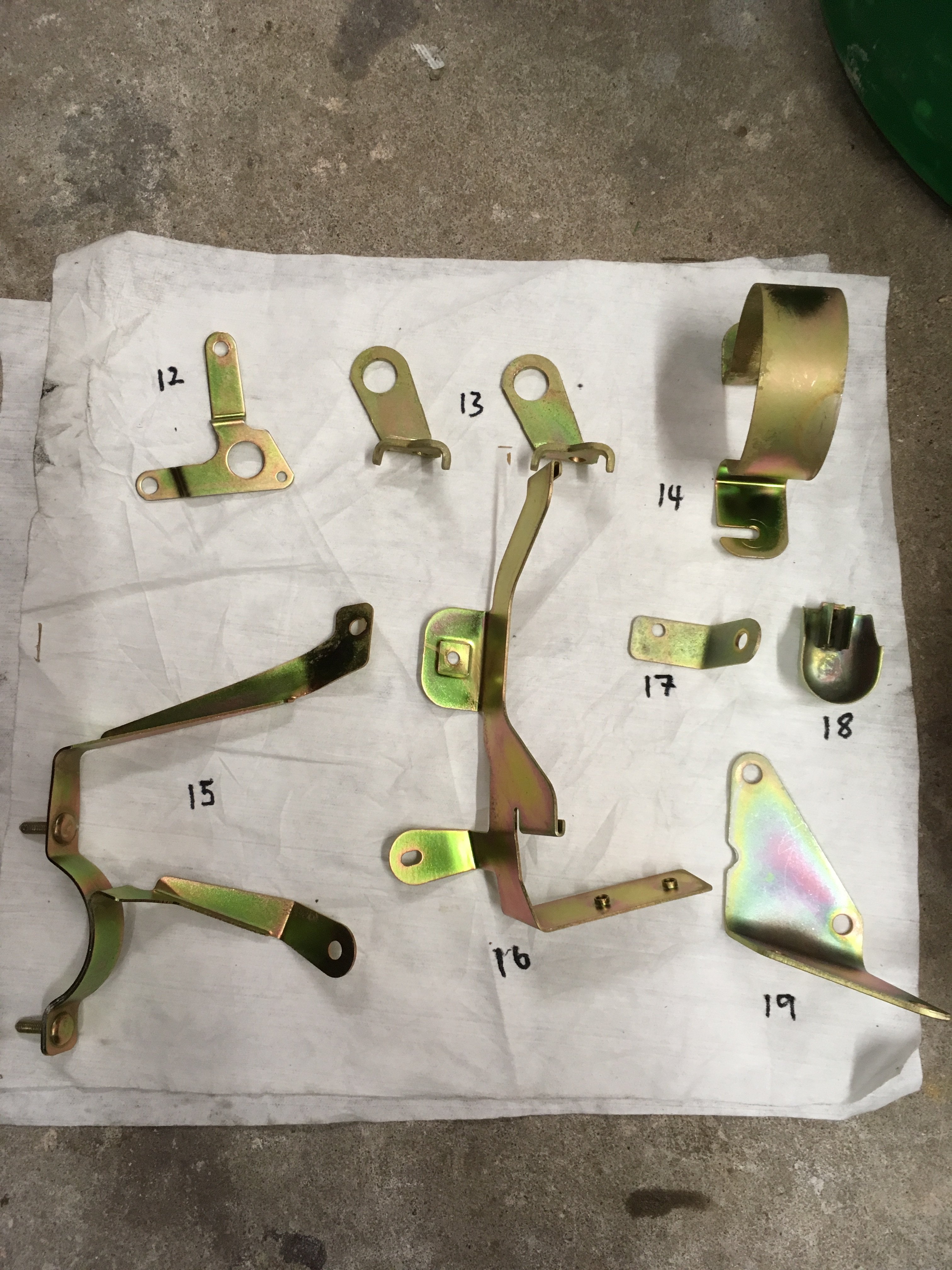

Hi GTI’ers!
So I have bought a 1.6GTI in pieces in a classic unfinished project stylee. The kind chap I bought it from has done loads of good work and had lots of parts zinc plated and powder coated. They are all boxed up lovely but...
I don’t know where most of them go....
Zinc parts only so far readers - powdered bits are still boxed.
Answers if you have them please!
Cheers,
Nobbly

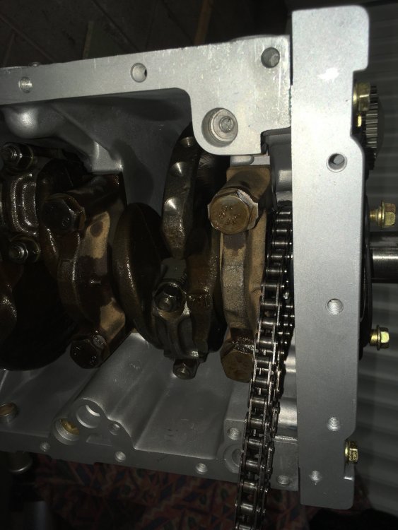

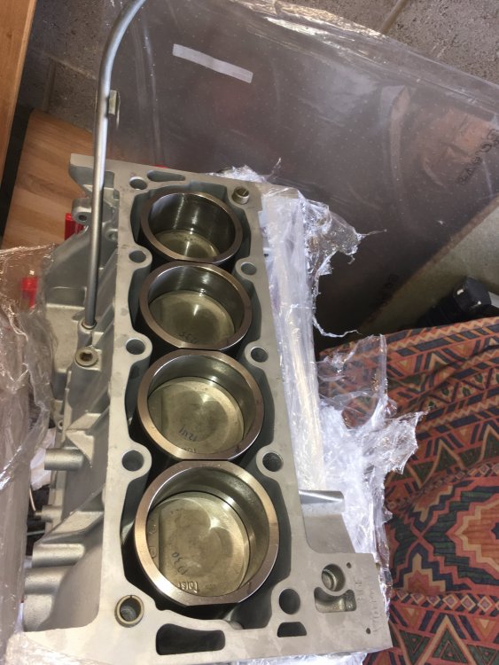

I also think I’m missing a couple of bits...
just about to fit the oil pump and according to servicebox there is a little spacer plate and a seal or something that goes between the pump and the block. I can get the plate but the other bit is NFP, so I need one, whatever it is!
Also seem to be missing the oil strainer that goes in the head to protect the cam journals.
Anyone advise where I can get them??

1 is a power steering pipe that goes from the pinion to the ram on the rack itself.
3 are the top radiator clips.
8 goes on the firewall above the exhaust and 9 clips two coolant hoses to it.
14 is the fuel filter bracket
18 is a gear rod end heat shield I think.
4 holds the relay box on the NS turret
5 fits on the gearbox bolts and carries the wiring loom
6 I think goes behind the dash to carry the wiring loom
7 I recognise but can’t think where it goes
8 & 9 carries the water hoses on the bulkhead
10 is the closure plate to the cambelt cover to the head
11 is the flywheel timing marker
12 throttle cable abutment to inlet manifold
13 engine lifting eyes
14 fuel filter bracket
15 & 16 pas reservoir and shunt box to slam panel
19 is the pas pump to block bracket

the  strainer cant be bought anymore- I just didn't bother fitting mine on my current engine build- I think its only used during the intial start then its bypassed (that's what I believe!)
So keep everything clean and it will be fine.
Telf
have the seals been fitted on the wet liners?
Telf
I've just fitted the oil pump - its an L shaped plate and a metal grommet (that's not the right word! but its name escapes me!) that positions the plate and pump.
The item you cant get is the same as the spacer that you can see on the bottom right and top left of the top of the engine if memory serves.
At least I think that's how it went together- its been a month or so since I built it.

Nobbly
Hi Telf,
Yes, liner heights checked and seals fitted. I’m an ex-truck mechanic so wet liners are familiar to me.
Worth asking the question though!!
Nobbly
Do you mean the locating dowels for the head?

Telf
yep!
Dowel that's the word!

Superb list so far...
2 ???
17 ???
Any answers for number 2 and number 17??

I don't recognise 5 and 7 as I have 309's and they are not fitted on those ( iirc ) but number 2 looks like the bracket fitted to the cam cover bolt nearest the cam pulley , there is a plastic clip that fixes the fuel hose to it .

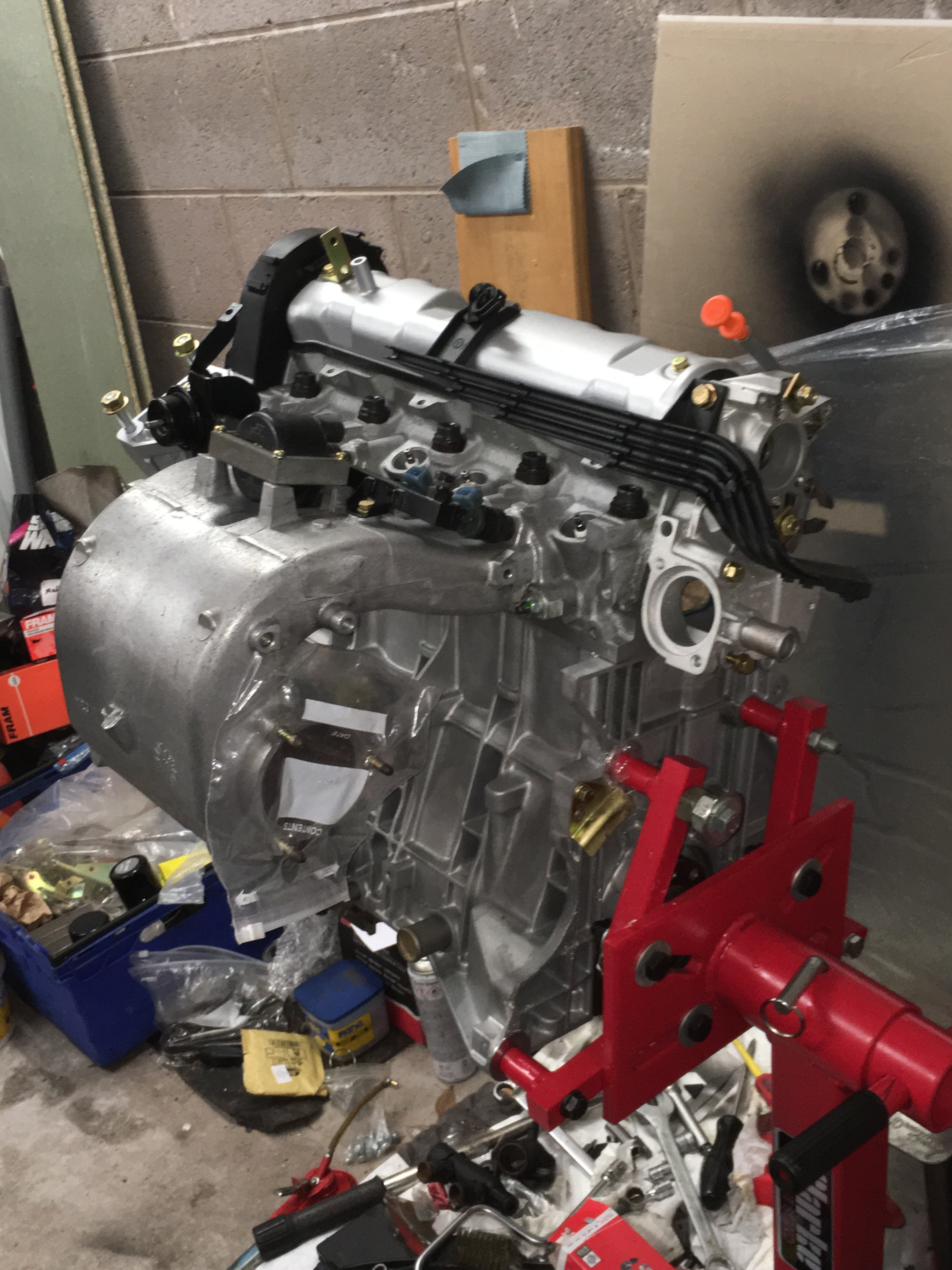

@Telf
The motor does look very twinkly with all its yellow zinc jewellery though ;-)
Leslie green
Looks well that does Nobbly, I see Electroplate uk gets a good few mentions on here , Id like to get some bolts and brackets done for rebuilding my engine soon too , can't beat a bit of bling !
Telf
Yep very nice- it just doesn't do anything for me. I know for a fact mine will be covered in so much crap there is no point in worrying - as long as it performs properly that's good enough for me.
