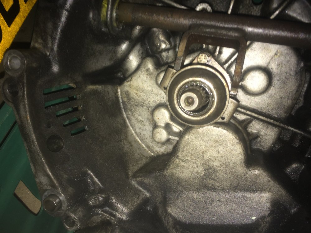

SimonJ 2 Posted January 27, 2018 It's 10 years since I've done this so memory a bit fuzzy. Is there any sort of retaining clip required for the release bearing before putting the box back on? Now I guess it can't go anywhere but what are the holes on either side of it for? Wasn't anything there when I took it off (I think) but that doesn't mean I haven't just been lucky and there should be something. Thanks. Share this post Link to post Share on other sites
pug_ham 245 3 Cars Posted January 27, 2018 No, there's nothing to hold the release bearing in place other than luck when refitting the gearbox but the tabs on the back of the bearing should be slide over the forks & try to hold the fork in place so it doesn't fall off when moving things into place in the engine bay. g Share this post Link to post Share on other sites
welshpug 1,676 Posted January 27, 2018 make sure you have the correct bushes to match the fork you have, if it has a J stamped in the top you need yellow bushes, an X or a plain one needs white bushes. Share this post Link to post Share on other sites
Miles 331 1 Cars Posted January 27, 2018 BE1 bearing on a BE3 shaft does not work, you need the right one Share this post Link to post Share on other sites
SimonJ 2 Posted January 28, 2018 (edited) MIles, This is the setup I've had since the last time the engine was out in 2007 (and I think since I changed from BE1 to BE3 in 2005) but I totally accept I might just have been lucky. The bearing internal diameter does look bigger than the shaft - is that what you mean. Need a bearing with a smaller internal diameter (the hole)? Welshpug - where do the bushes go - I've no idea what they are! If it/they are the yellow thing at the top of the pic then haven't changed them so should be OK. Just changing to the engine I bought from Dan. Edited January 28, 2018 by SimonJ Share this post Link to post Share on other sites
welshpug 1,676 Posted January 28, 2018 bushes are on the shaft, one is in the top corner of the picture, the bearing pictured is incorrect for that clutch fork too as Miles pointed out. it should look like this on the rear. you appear to have a BE1. Share this post Link to post Share on other sites
welshpug 1,676 Posted January 28, 2018 that page shoes all the different BE1/3 push and pull type forks and bearings. Share this post Link to post Share on other sites
