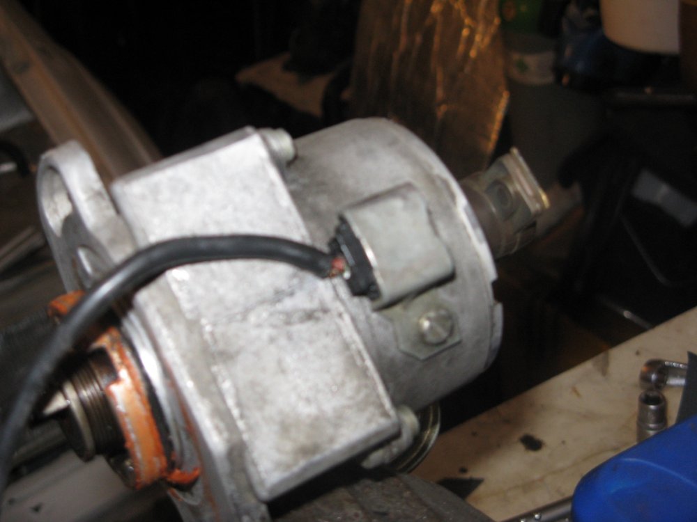

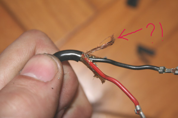

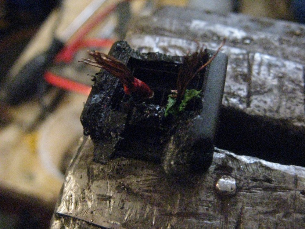

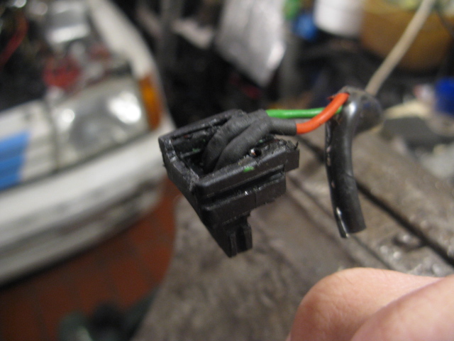

DamirGTI
Now , the first two pics are bosch type dizzy cable , others are ducellier dizzy cable .. but essentially the same/similar .
Undo the screw which holds the cable on the dizzy body and pull out .. wires inside the cable will most often break on the very end when the cable meets the plastic connector - chop off the top of the plastic connector and inspect the wires/terminals inside .. if you find any of the two colored wires broken (ignore the third one which is shielding wire) - re-solder as you would any other car wiring , put some heat shrink tubing , slide back in the connector and reseal with some epoxy glue or similar .
Have fun !
D
