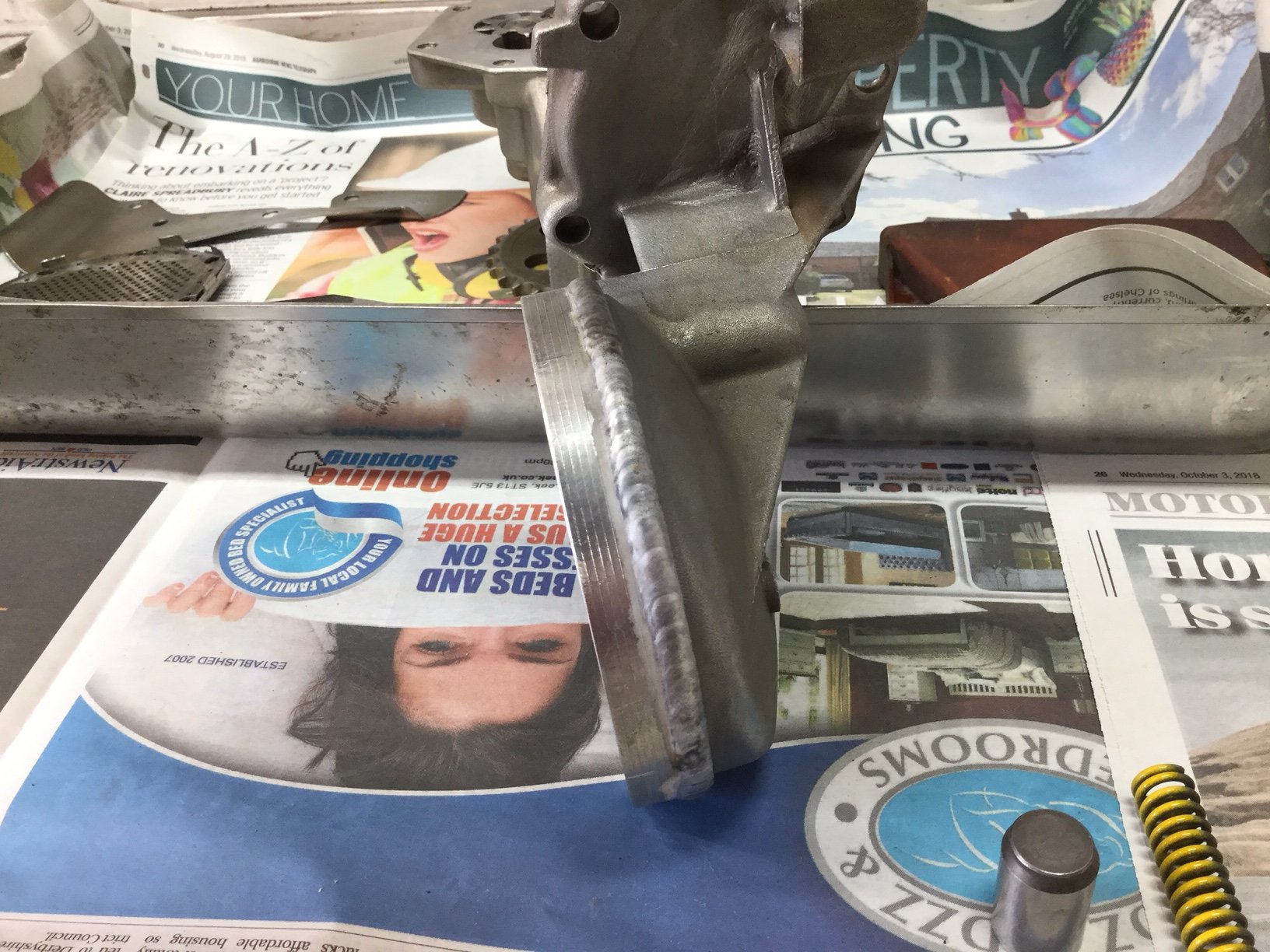

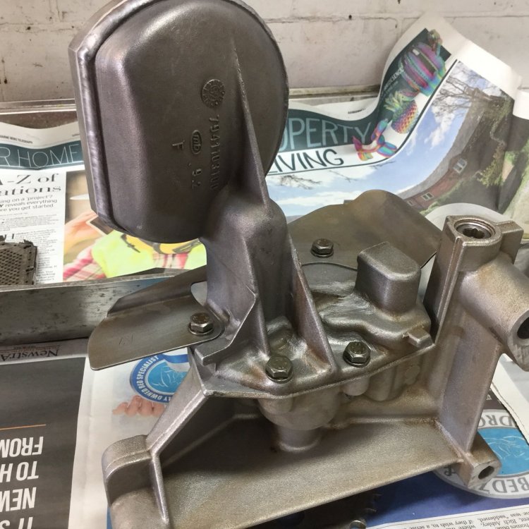

 hope the turbo project is making a bit of progress. I plan to mount the windage tray on the bolts from 2 and 4 main bearing caps  rather like as on the XU10J4 RS but with modified bolts. Engineering company are on that one . So I will end up with a deeper sump ( because of the strengthening plate) extended oil pick up so that oil is collected from the very bottom of the sump, pump chain guard, trapdoor Sump , all more or less as per Peter Taylor’s recommendations on his site

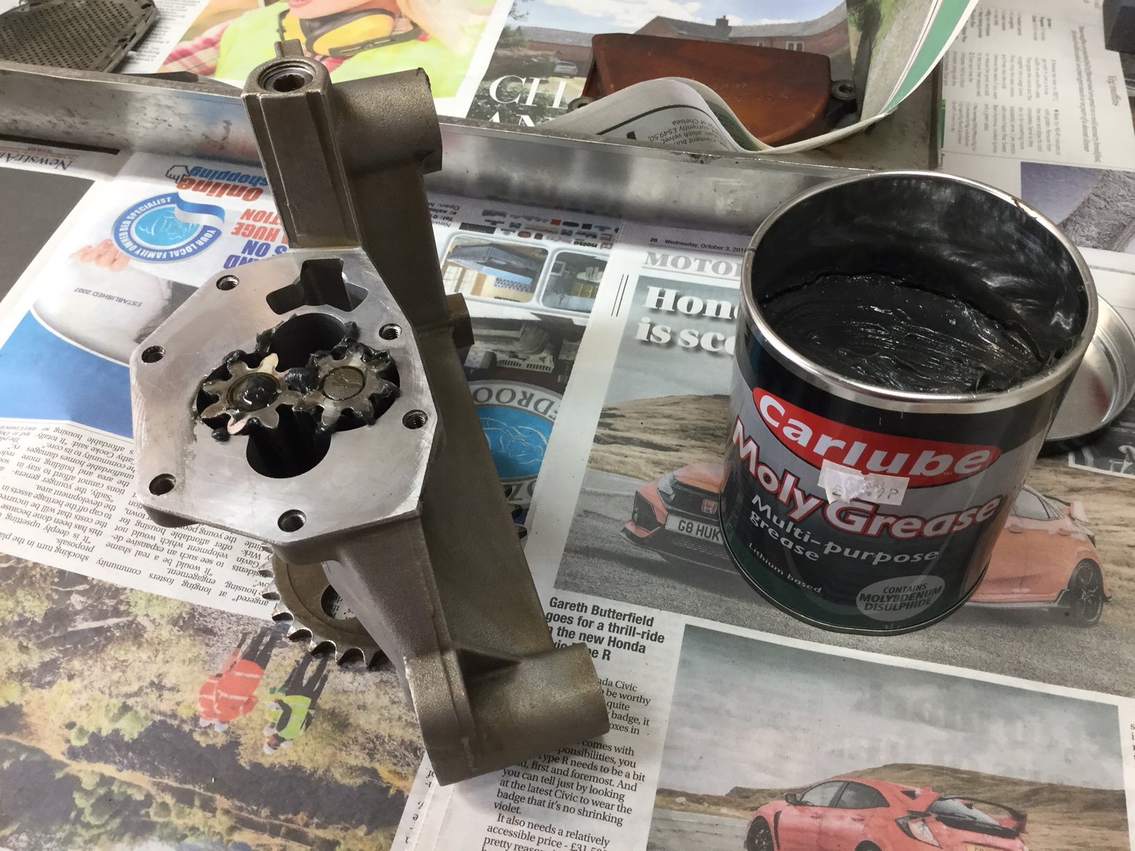

I got in the groove of this pump building lark and completed two more, one from a gti6 ( ie xu10j4rs) and one from an XU9J4 . At least I have condensed two boxes of bits . One or two subtle difference between these pumps. The XU9 one has no tappings  to accept the chain guard and the RS one has a thin metal spacer between the two halves of the pump. In addition, it looks as if oil that is above 6bar bleeds back into the sump on the RS pump. On all the others, it looks as if it is fed back to the gear housing .
 P.s If you read this Speno, yes, I built your pump with the same love, care and attention as I did mine !

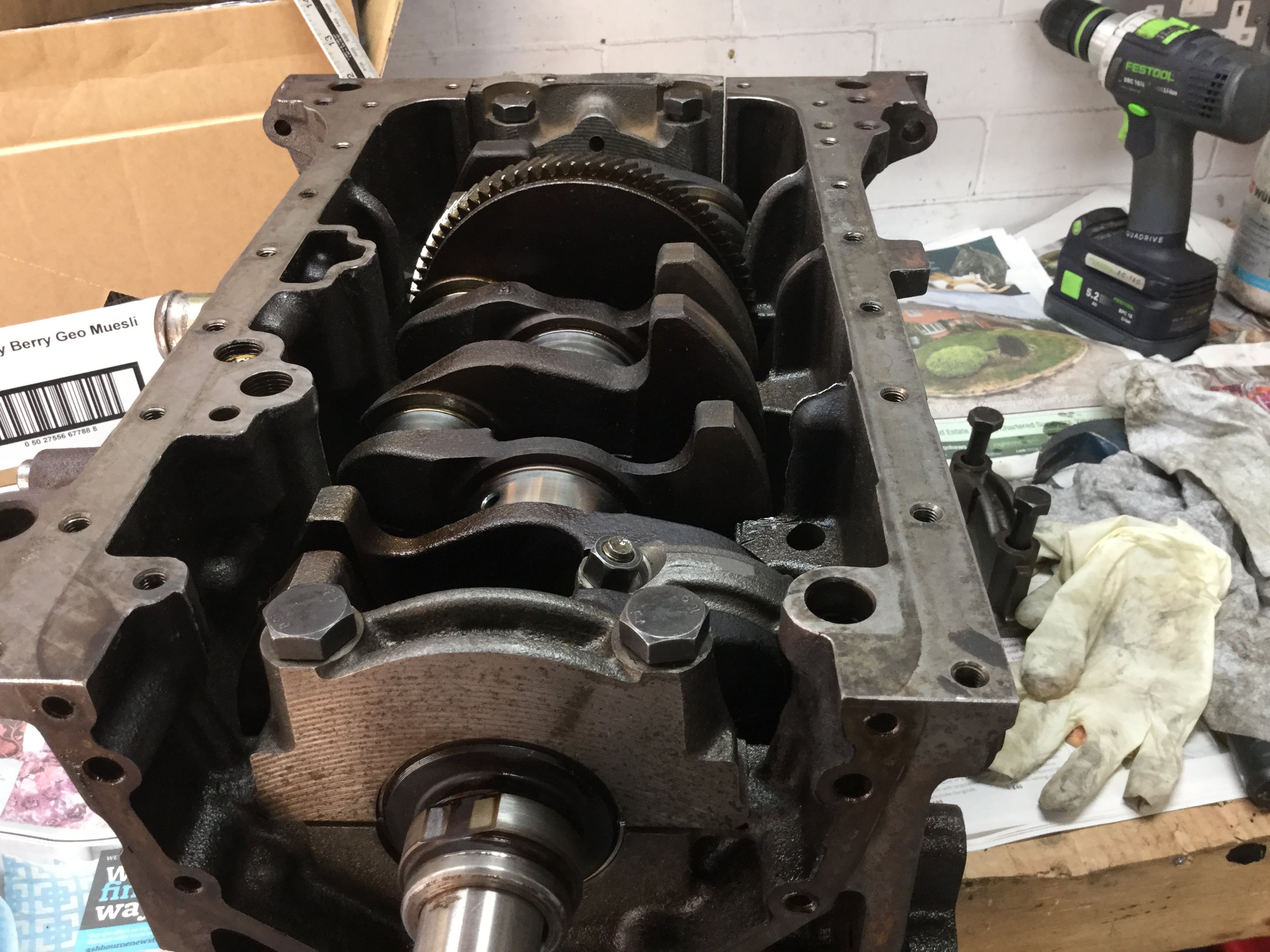

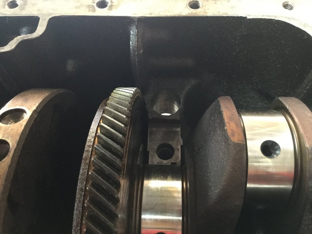

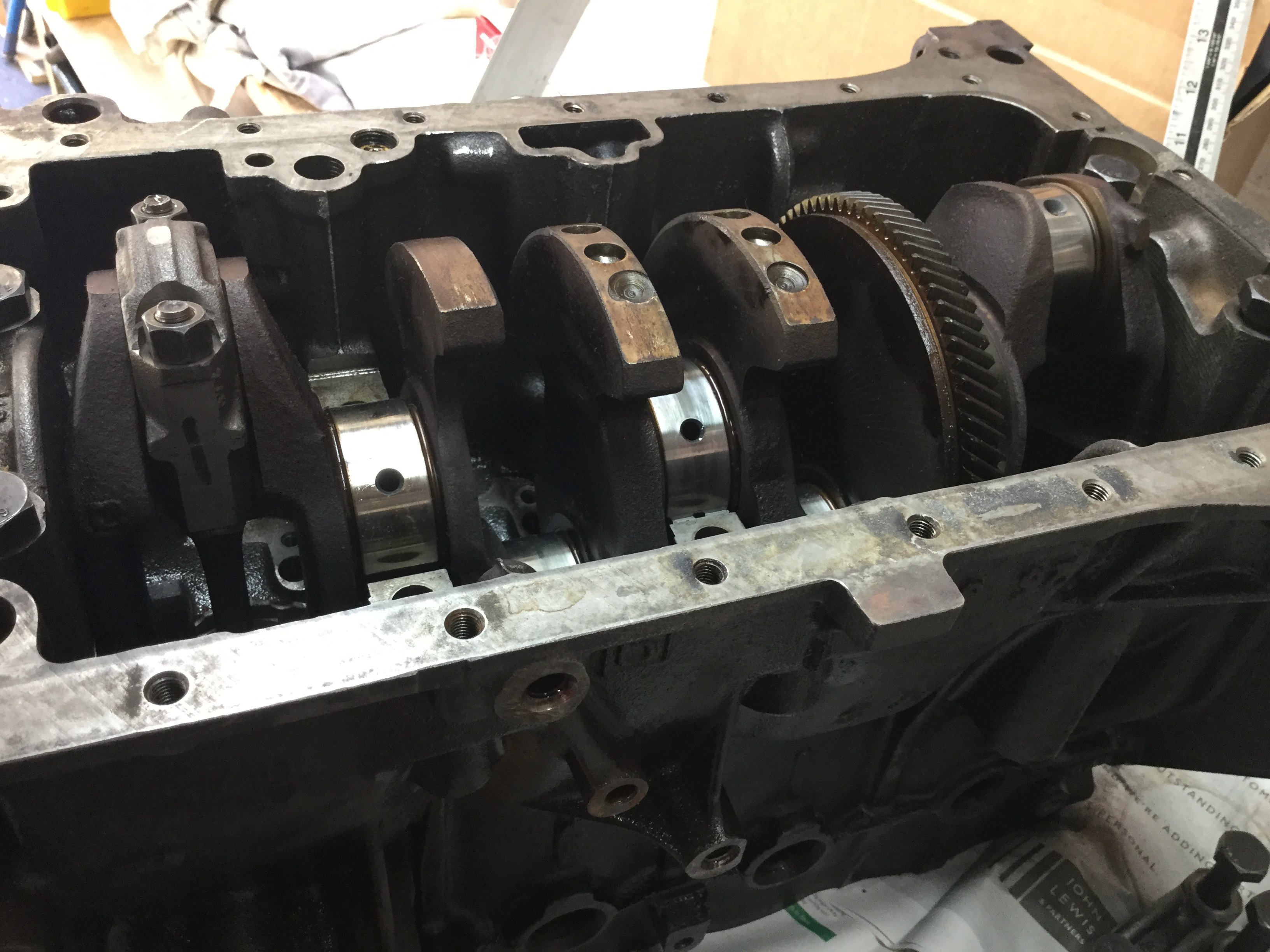

96mm crank from an EW12 arrived this morning ( many thanks Dan ) I got round to offering it up to an Xu10j4 block this afternoon, and then added an Xu10j4 rod and piston for good measure ( rod has a length of 152mm ) . The first snag was the gear that drove the balance shaft on the EW engine. It fouled slightly but a few minutes with a rotary burr solved the problem for the moment . I would like to remove said gear but I am not sure if it is machined as part of the crank or pressed / sweated on rather like flywheel ring gear . The next snag is the clearance between the side of the block and the rod, which at one point gets down to 0.7mm . As I plan to use Honda pistons with a compression height of 30mm, the required bespoke rod will need to be 157mm  which could make this clearance even worse. However, there is some scope for a  bit of work with the rotary burr as there is no water jacket at that point . Bit more thinking and measuring to do here, but the possibility of 87mm bore and 96mm stroke is so tempting I may move to the dark side and shelve my XU9J4 build for a while .
xy8
I used DW12 crankshaft , ring gear for balance shaft was pressed on  also  welded in two spots, easy to remove.
Andy
Yes. Discovered that this afternoon. One hammer, one copper drift and a few blows and the ring jumped off

Good to hear from you. I am pleased that your move had gone well. Finding a 92mm crank was getting tricky. As you know I was offered a full engine for nearly £500, but that really did feel like a step too far . Anyway, it was dcc (Daniel Clarke) who suggested I think about the EW12 crank, and less than a week later , here I am with a 96mm crank and, God forbid, a cast iron block . I am increasingly considering pausing my XU9J4 build with its 85mm bore . I have all the parts for the head which will work on either engine , and nearly 2.3 litres is pretty tempting. I have the spacer , the gti6 Sump, the windage tray, the extended  oil pump . Honda piston from CP are £520 shipped and are almost perfect for my spec, so the only custom item will be the rods, which I will have to spec and get axe. Having said that , they will be a 157mm version of Xu10j4  rods ,  more or less . I think that Robson charge about £650 for a set .

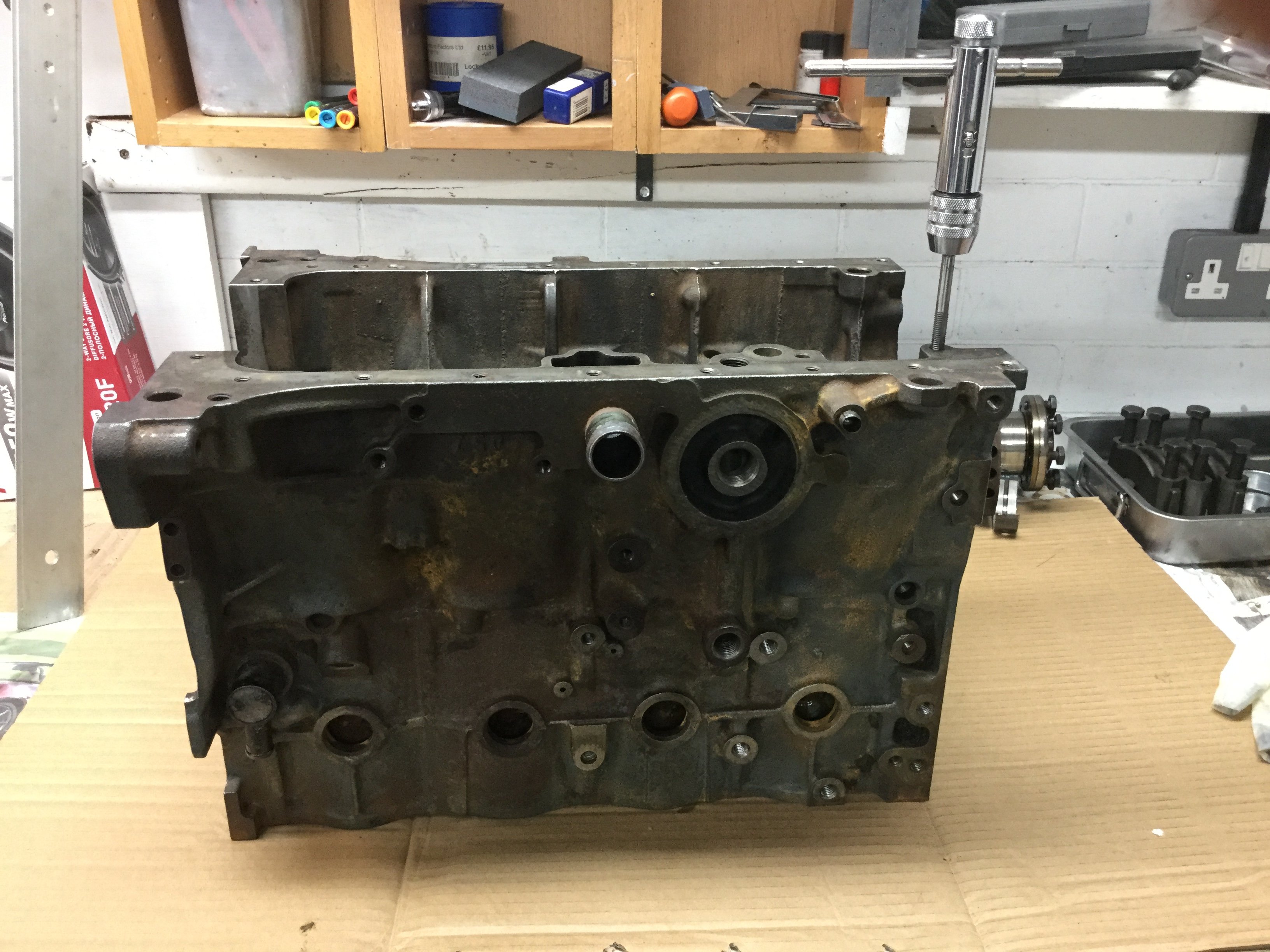

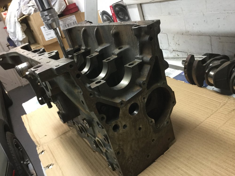

Bit of work on  the Xu10 block ( heavy aren’t they?) . Preliminary degrease, paint stripped from one side and thread cleaning begun. Prepping this block is going to be a long job
I put taps in my battery drill/driver. Set it to the lowest screwdriving torque setting and the clutch will slip before you can break a tap. Makes short work of cleaning threads out.
Andy

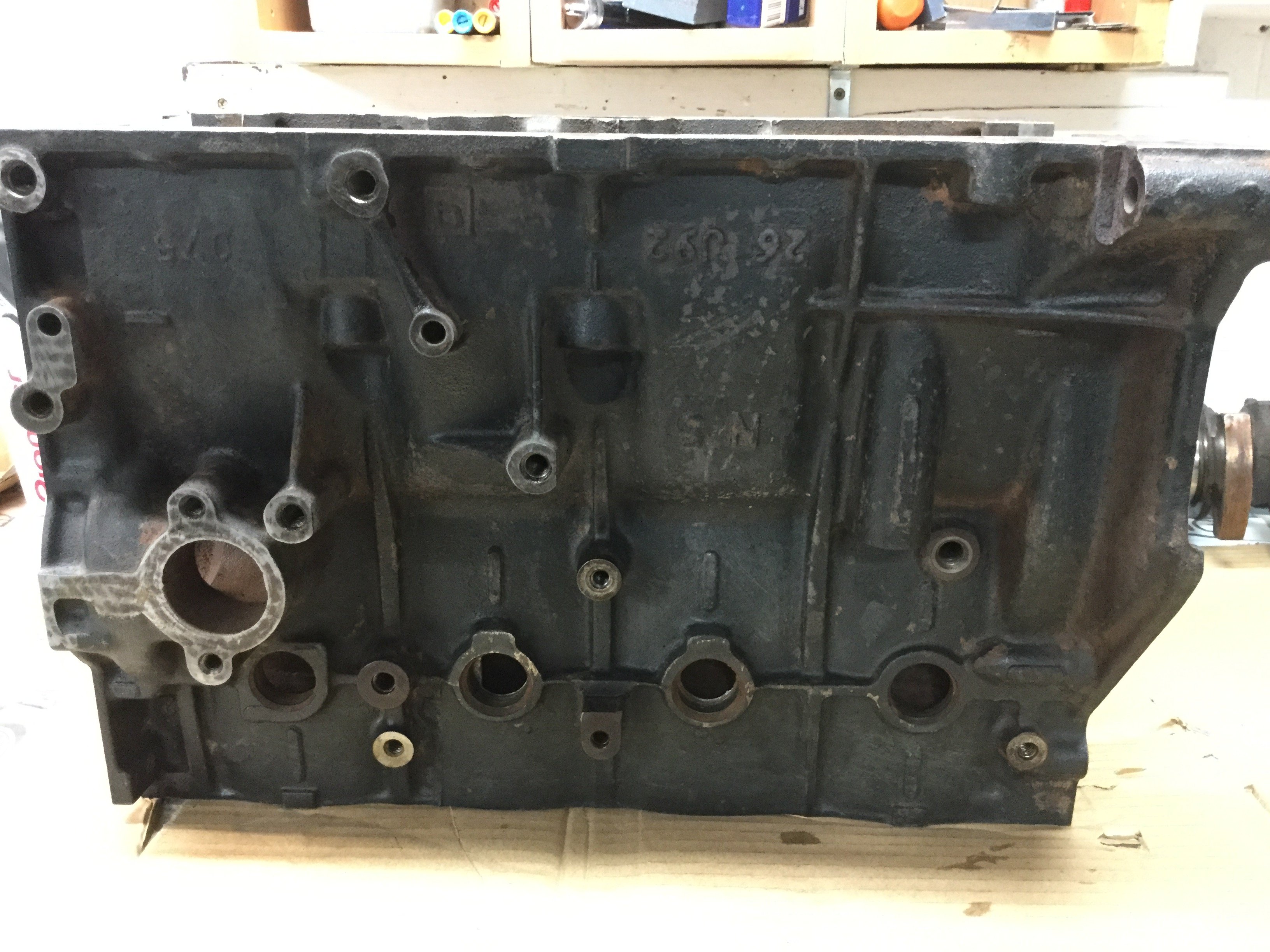

Cheers Tom. I have spent an hour so far and no where near finished. Good idea, but I will be careful . Removing a sheared gap would not be entertaining . Got some more Bilthamber deox C on order so that I can give the b,Oct a long soak in the solution. Brilliant at removing corrosion but all the paint needs to be off first . Oh, rechni al question about the engine mount . I have the iron top mount. I also have the large casting that bolts in to the block side that holds the alternator, probably a power steering pump and weighs just a bit less than the Moon . I also have a much smaller casting that bolts on the  block that just is the engine mounting. That suggests that there must be another bracket that Peugeot made that supported the alternator. I will post a couple of photographs to show what I mean . It would be nice to have the latter rather than the former , which will need an appointment with an angle grinder prior to use
DrSarty
That iron block bracket IS enormous! I cut mine down to a shadow of its former self, and may still have it if you want it?
This is on the proviso that it's solely for the alternator, i.e. no A/C and some other form of power steering source e.g. electric pump or column, where I believe you have the latter.
Also with the iron block, the dip stick is at the rear, so ensure it seals (to avoid pesky leaks) and that you secure the top, possibly off a cam cover bolt with a small bracket.
You may also experience a tight fit with the cam cover near the brake master cylinder.
