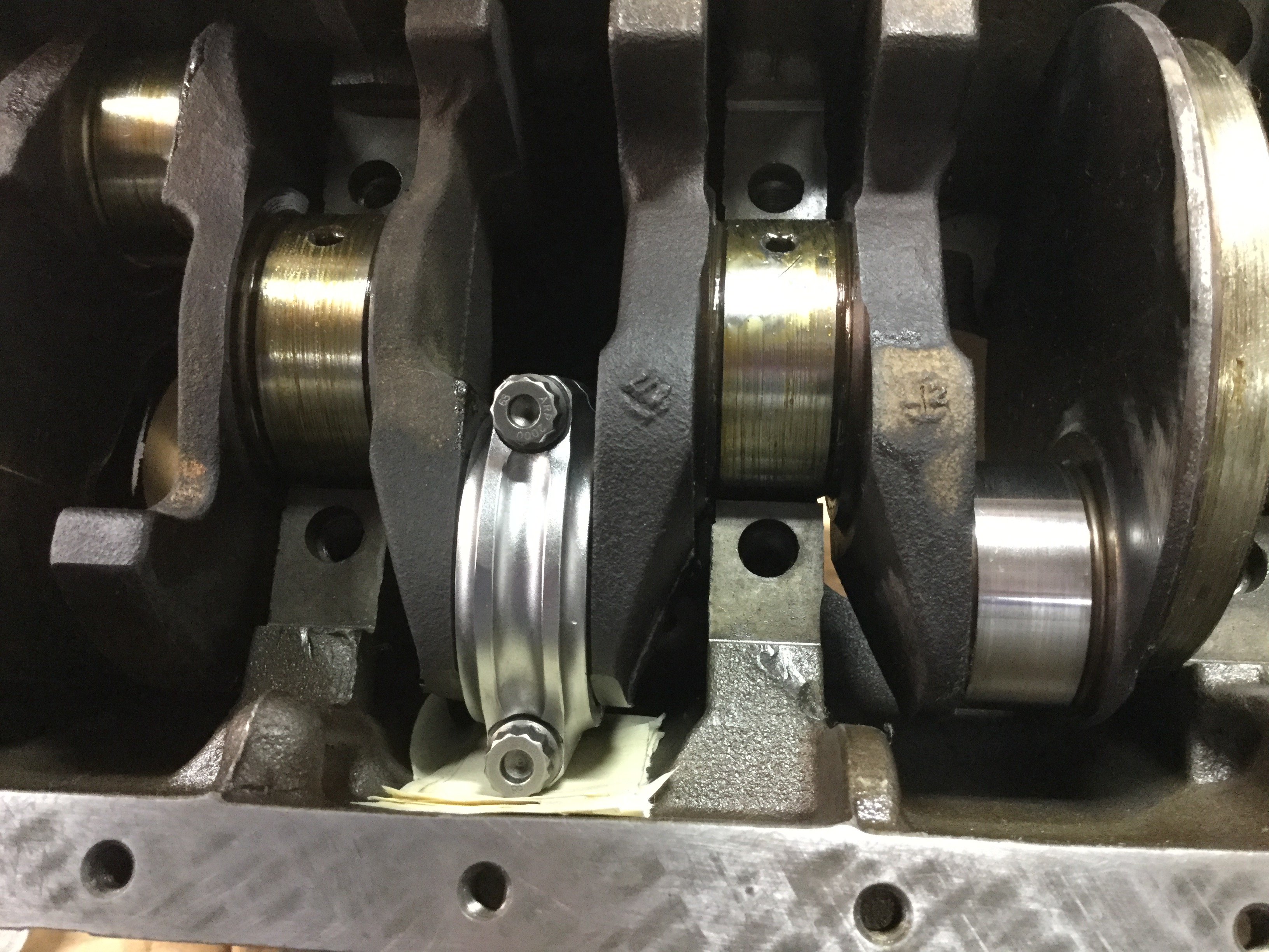

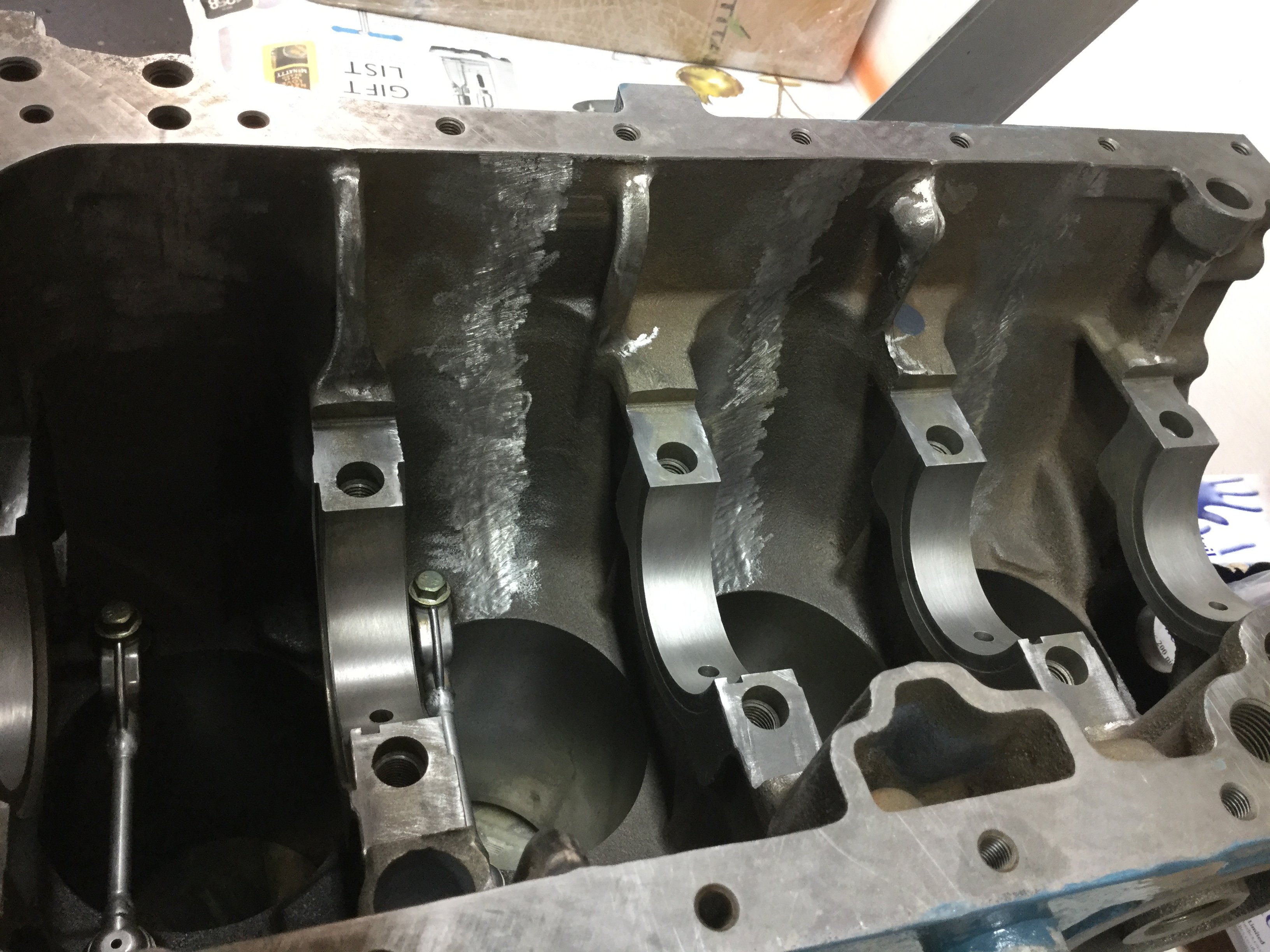

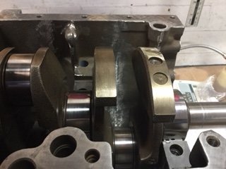

At long last. Engine build begins. First job is to check that my 157.8mm long rods fitted to the 96mm throw crank clear the inside of the block. On no. three, the clearance is 22 layers of masking tape. For those of you not fluent in masking tape units of measurement, that comes to 2.4 mm. Phew. Just got to check the other three cylinders and I can then start demurring the block.

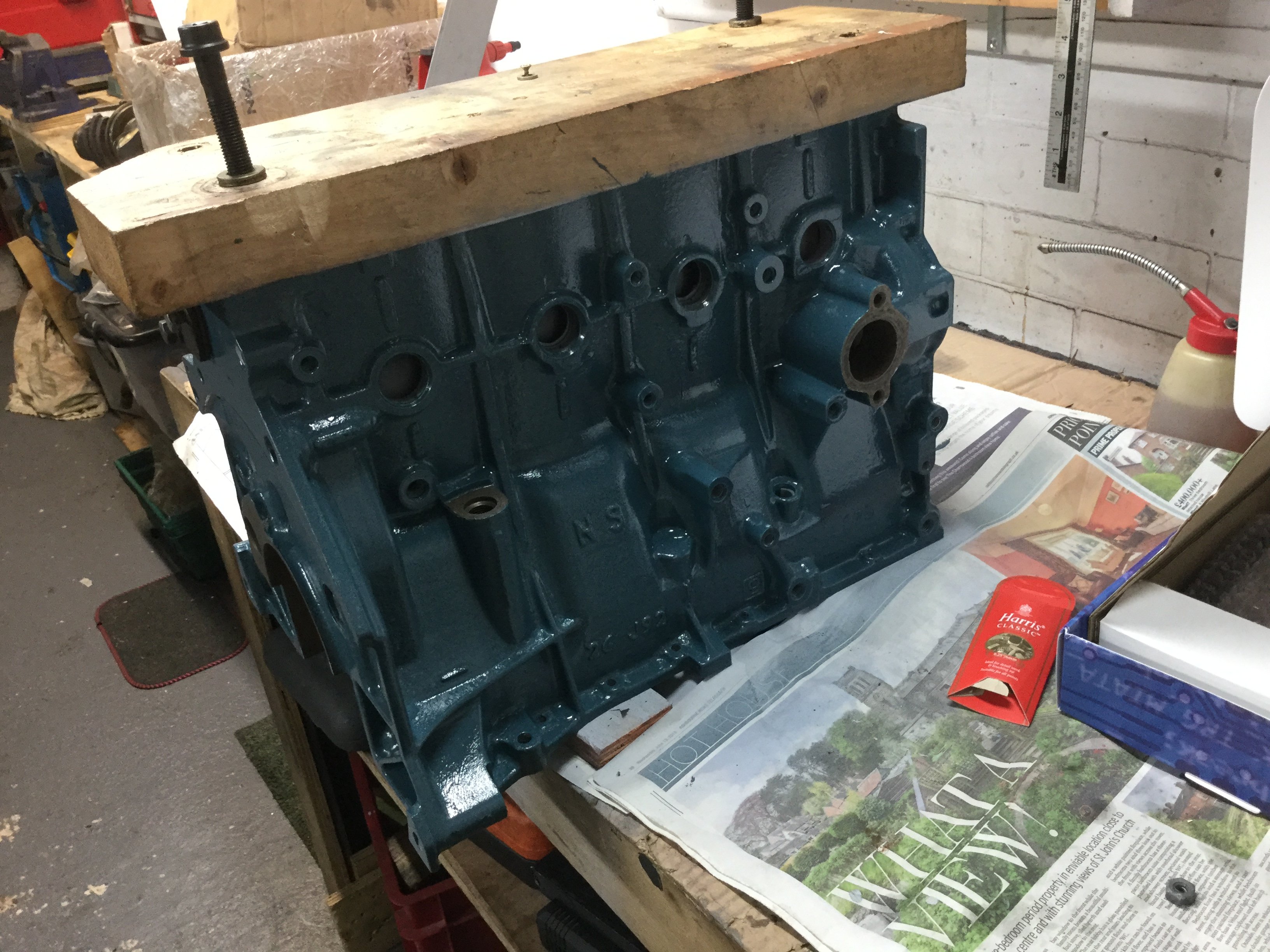

It had to be done. A coat of etch primer followed by a coat of POR 15 engine enamel . At least one person I know likes the colour . Me

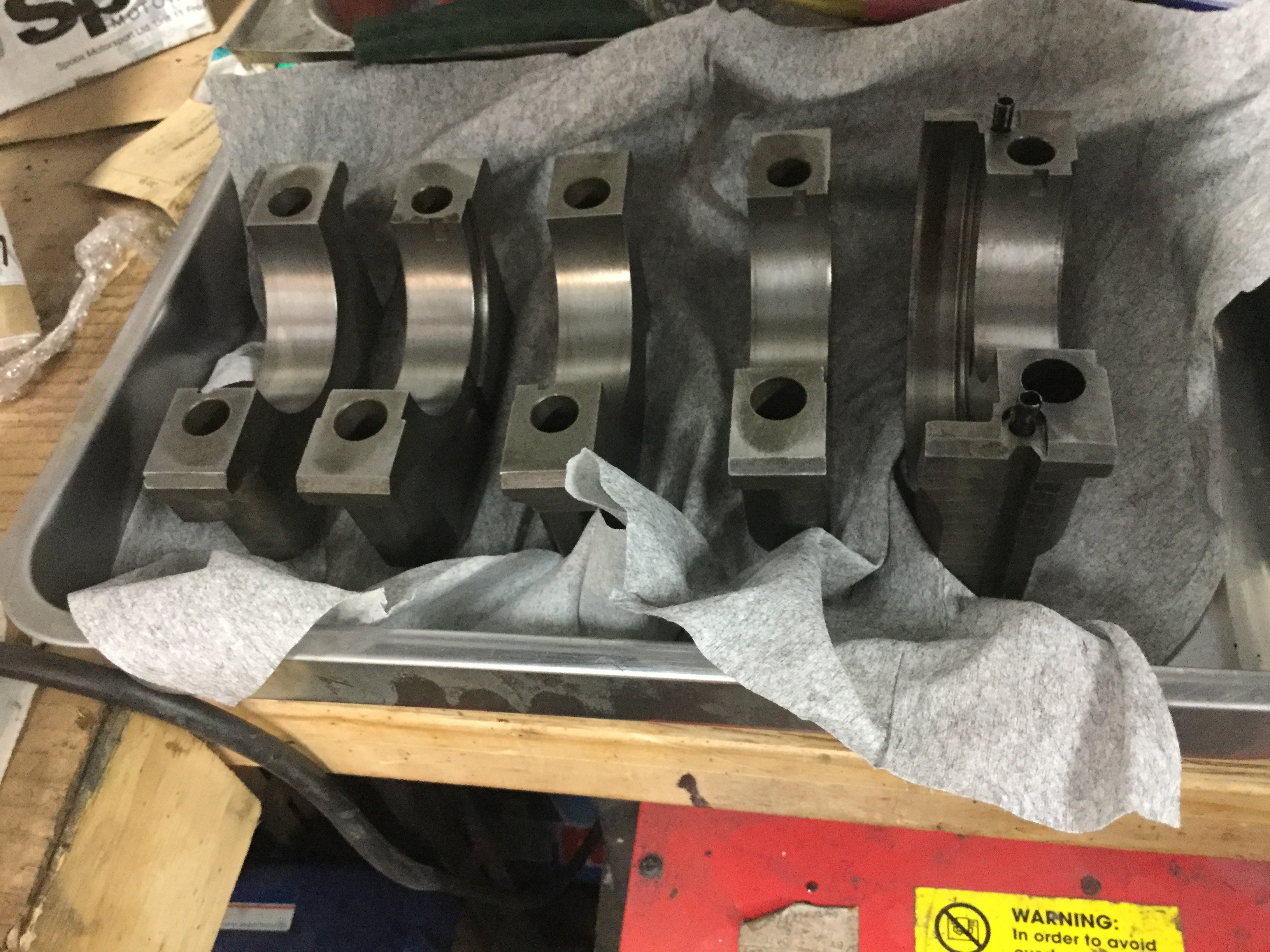

Andy

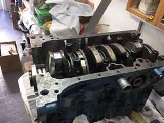

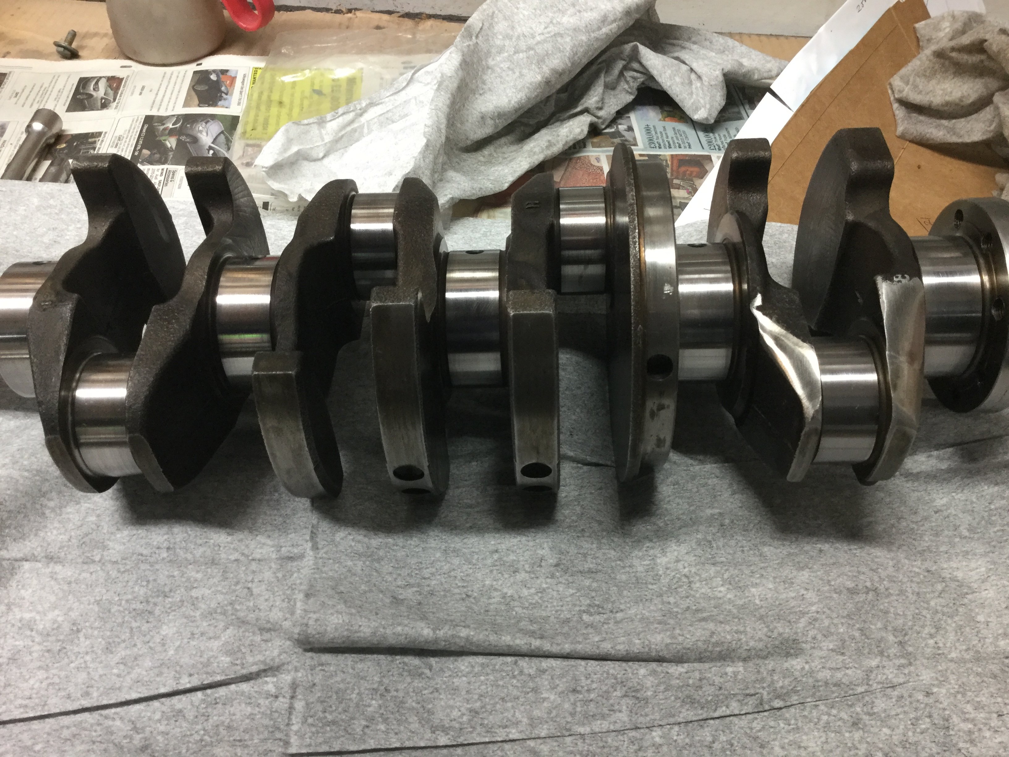

And 4 hours of work later, one set of prepped mains caps, oil spray bars in place and a jizered crank ready for a hot wash ( read dishwasher ) . All rotating and reciprocating parts have been balanced . The crank was  an absolute mile out . Removing the balance shaft drive wheel obviously had more of an impact that anticipated. The Wiseco pistons were within one gram of each other to start with, ditto the Robson rods, so the ‘balance man’ had less to do there .

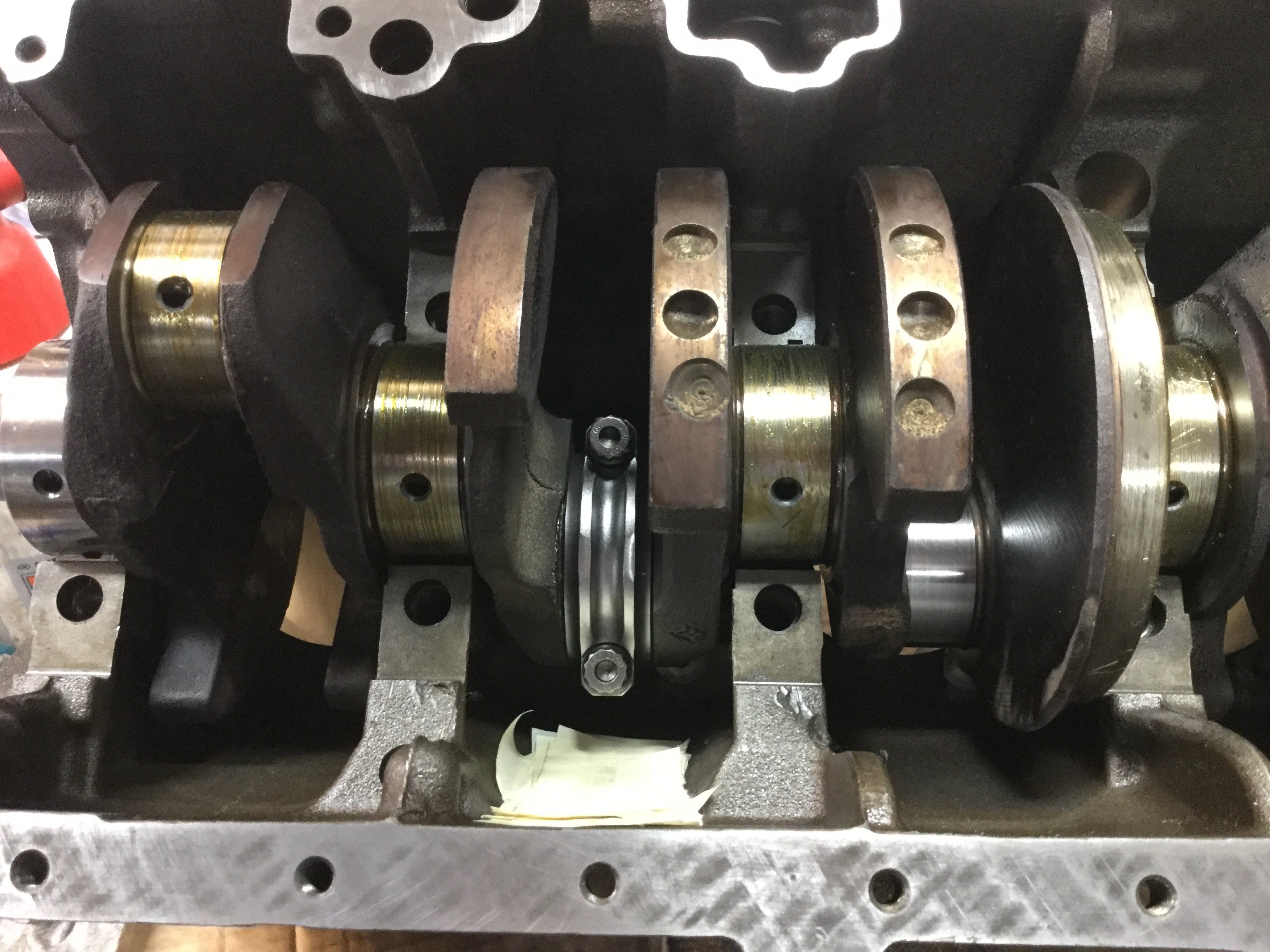

Hit a small snag,I checked the main bearing clearance and , to my disappointment , got 0.075mm across all 5 . Crank measured up perfectly at 59.950 consistently. And here is the snag. Ten minutes on the King bearing catalogue site revealed the problem, The  XU 10 crank should be 59.98-60.00 . The EW 10/12. 59.94-59.96 mm. In addition. The EW bearing housing is 0.025mm smaller in diameter and the combined bearing thickness 0.03mm greater than the respective XU dimensions .
So , risk 3 thou main bearing clearance or regrind  the mains to 0.3mm undersize to remove the problem . 2.4 thou clearance is about the top limit ,  but I would be interested to hear others thoughts on this one . Dropping an EW12 crank into an XU10 block is not quite as easy as I thought !!,,,,

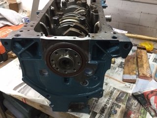

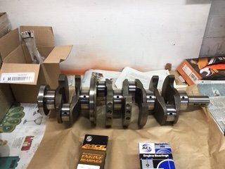

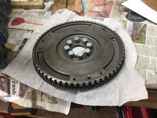

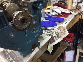

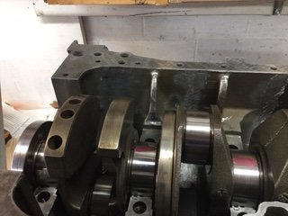

A bit more progress. Crank back from the machine shop with 59.70mm mains  , 50.00 mm big ends and some ACl  bearings to go with it. Plastigauged the mains , although a bit of an academic exercise given that the micrometer did not lie . Crank rear seal and hockey sticks in place , and the crank turns very nicely, all 96mm stroke of it . Flywheel cleaned and ready to bolt on with new bolts from Peugeot ( they also provided the core plugs, cam drive bolts, tensioner bolts and a few other sundry items . God bless service box )
 As soon as the flywheel and clutch are on, I will get the block onto the stand for the remainder of the build .

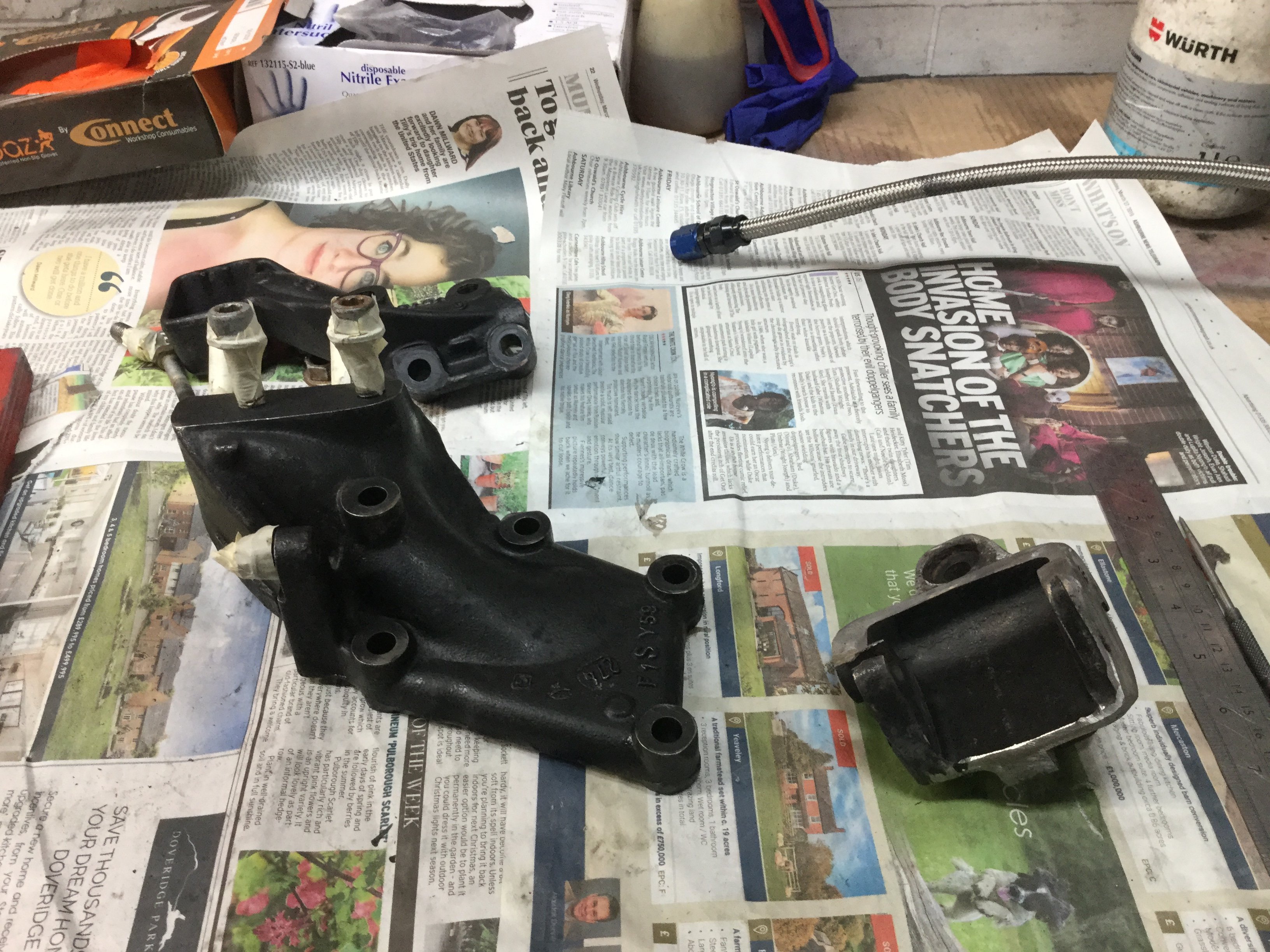

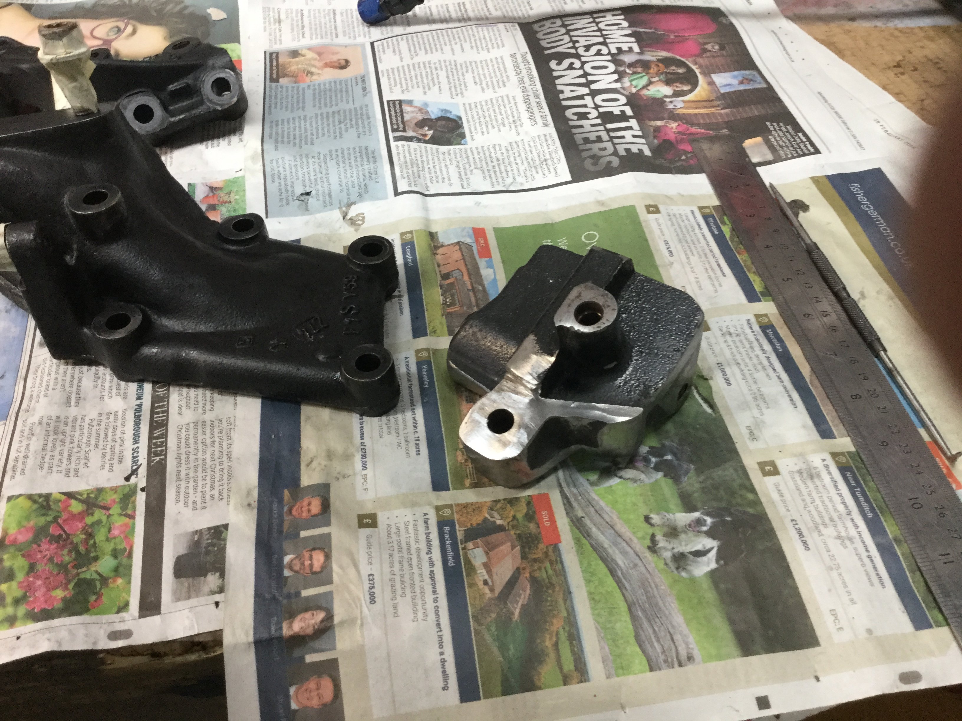

Pause for cylinder head, so went onto alternator mounting round two. I have an engine mounting from an Xu10j4 engine. No idea what car it came from, but it is a neat mounting. Also have a full  fat Gti6  mounts everything to everything bracket which weighs slightly more than the Moon . Well, it did . Now I just have the alternator mounting bracket, but cutting it down was a bit of a chore, and I had to double up on one fixing so that one of the five engine mounting bolts also clamps the alternator bracket, with a dowel pin offering secondary location. The photographs put it better. One coat of paint, and all I will need is a Gti6 alternator . Lots of choice there, from 70A upwards,

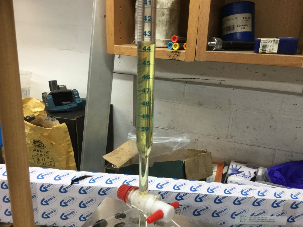

Update. Valve clearance at tdc is fine. Inlet has 4.6mm and exhaust 5.2mm. Given that the inlet has a lift of 2.4mm at tdc and the exhaust about 1.95mm, I think I have enough clearance there. A bit more of a worry is the combustion chamber volume. I had assumed 39.1 cc and did all my calculations on this assumption, including the Wiseco piston spec. Having just measured said volume and got 43.5cc , my carefully engineered CR of  11.2 has tumbled down to 10.6 . And this is on a Cometic gasket 1.00mm thick . Serves me right for sorting the pistons before having the head finished .I will sleep on this one
Wow, 43.5cc is quite big. Guy must have had a field day in there. They do look nice. How close is the inlet seat to the head gasket face?  Perhaps you can sneak a bit with a head skim?

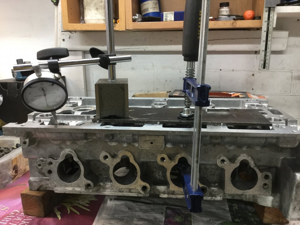

Update. Started measuring the installed spring height. All inlets done . Up to 0.5mm difference between valves, which, if not corrected via a shim, would be 2.5kg difference in spring preload . That is a lot, so this really is worth doing .
Also spent half an hour with the die grinder making room for those inlet cam lobes
M6 countersunk screws work better than F clamps.
Andy
Of course! Why did I not think of that ! I have been scratching about using the damn clamp on about 5 head builds now. Screwing the baseplate to the head would be much better. Thanks for that tip.
