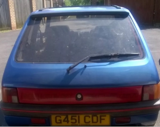

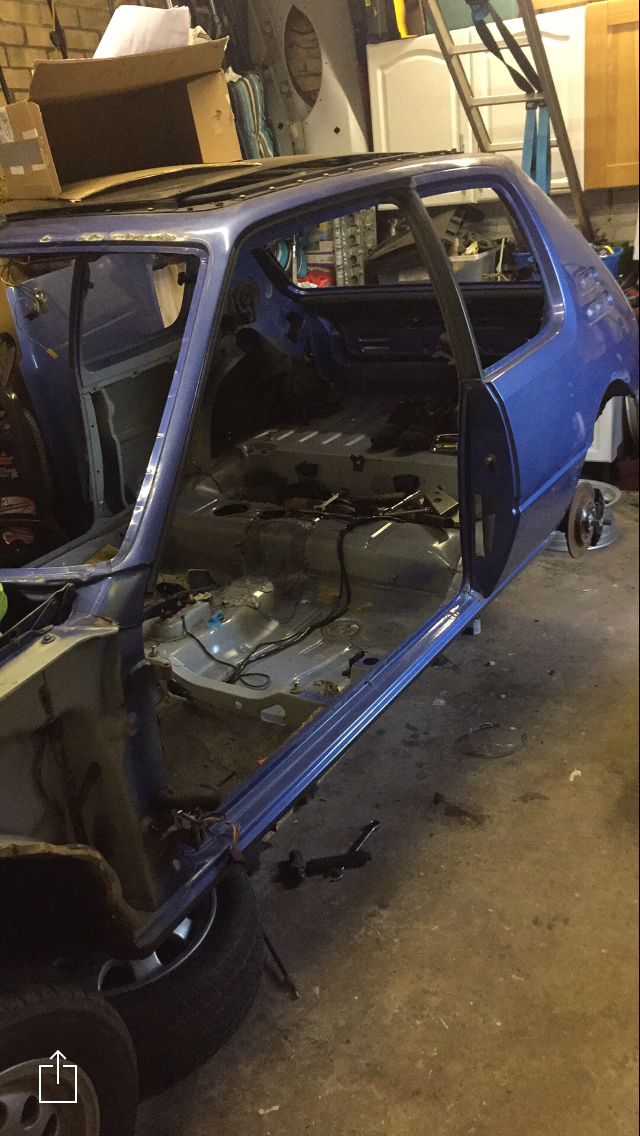

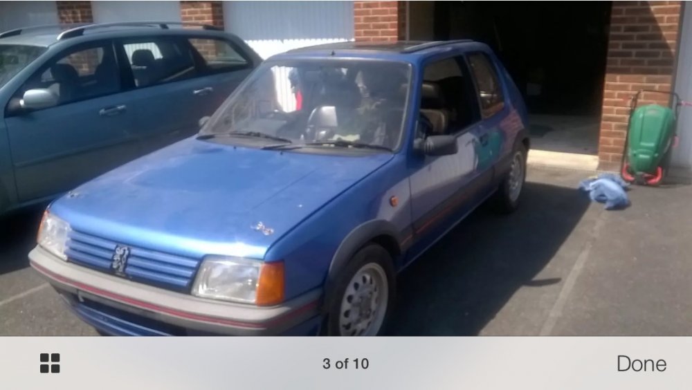

Redjam007
Here you go , a picture of my “special edition “ prior to rebuild and one of how it currently is prior to body shop
