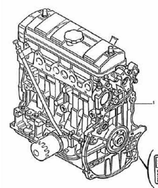

Dear members,
Regarding the cooling system flush I plan to do I need to know the location of the Cylinder block drain plug. Would someone please indicate it's location in the attached picture? And possible locations on bleed screws of the cooling system.
According to Haynes:
On TU series engines, the drain plug is located at the front left-hand side of the cylinder block.
Also, what is Haynes perspective of left and right. From the driver or from the mechanic standing in front of the engine bay?
Many thanks,

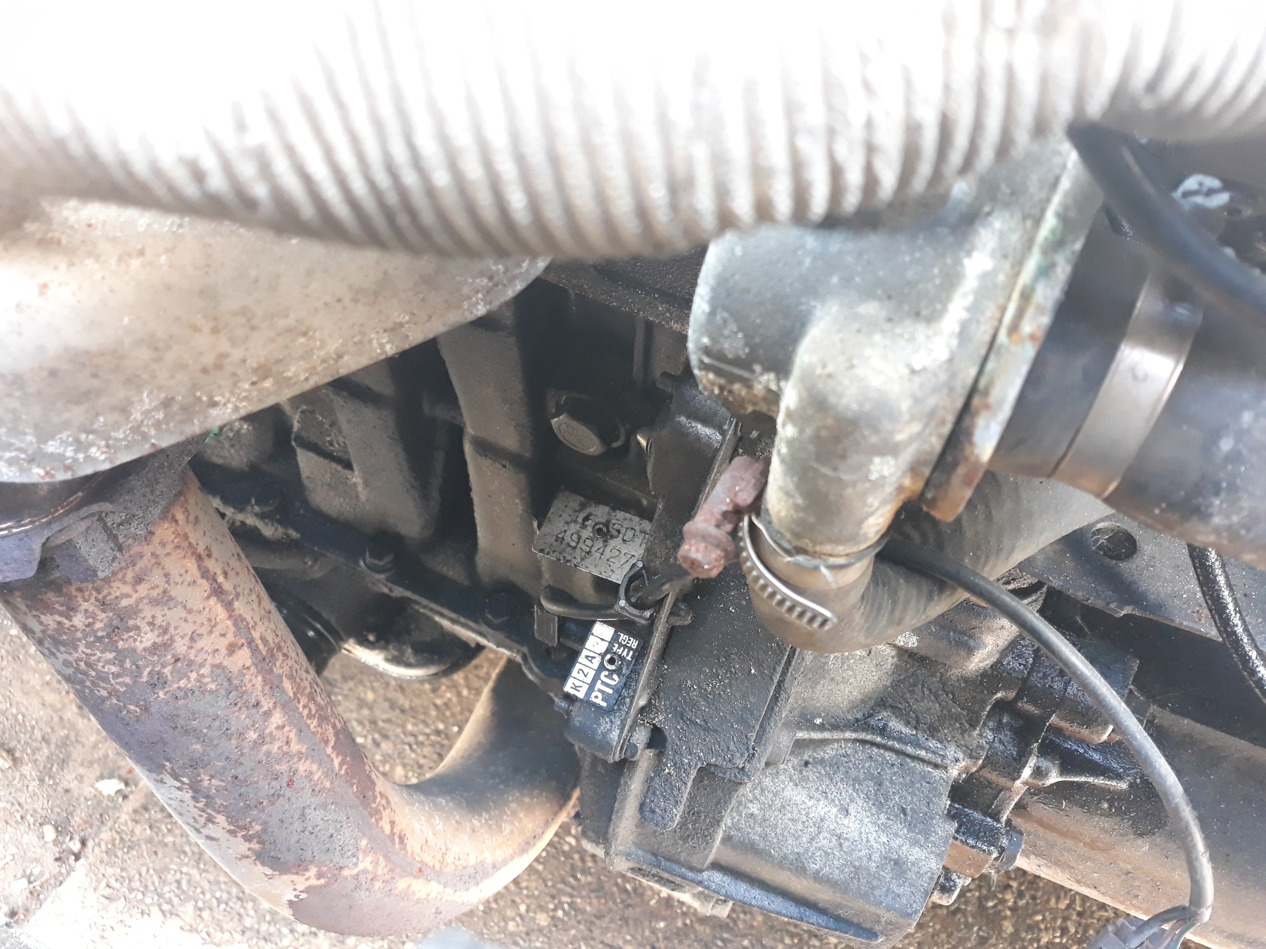

Hi, I'm new on here so hope I'm ok replying to this old thread. Thing is it's closest I've found on the forum on someone asking about the position of TU cylinder block drain plug. I've bought a GT model recently with the later TU3s engine and am thinking about draining the cylinder block. So if I follow the Haynes manual guidance (left being from the driver's seat) this is the closest I can find to what may be the drain plug (centre of the photo). Is this right folks?
Gohn
not a TU owner but looks like you've spotted the drain plug, wind it out and see if any coolant shoots out
but L and R : sit in the car and look out thru the windscreen ,same as you do when driving
your Left is the left side of the car and your Right is right side
