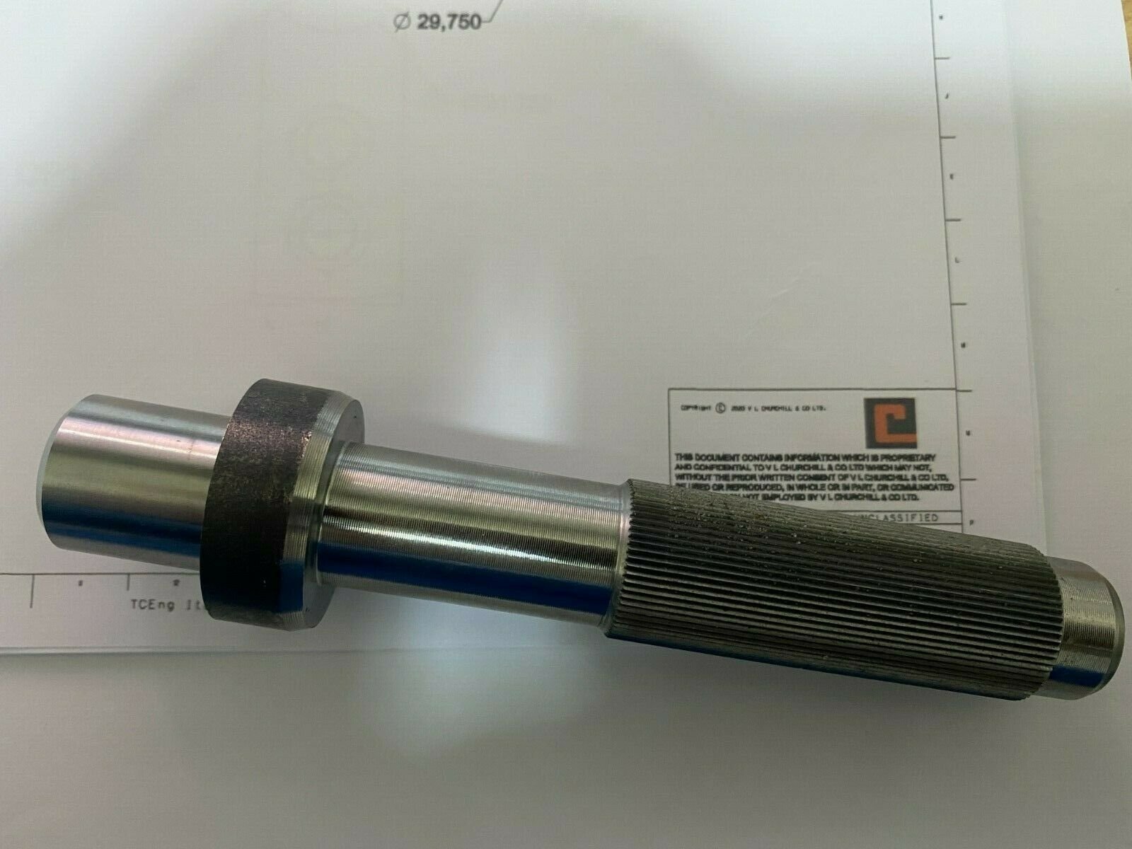

The thing you need to be careful of now is when re installing the bearings. You need to support the rollers with a mandrel at diameter while carefully pushing the outer race into the tube. If you don't do this carefully then you will deform the outer shell of the bearing which in turn will nip the rollers and stop them being able to move freely. The impacts from driving will then indent the hard bearing rollers into the arm shaft. Thus your rebuilt beam will have play in it quickly. I've done hundreds of beams and have seen this often from well meaning folk trying to rebuild them. With the bearing installed you should be able to easily spin the cage and rollers with your finger. If you can't, cut them out and start again. Easy to check the outers, not so the inners.

DamirGTI
Interesting , does make sense .
The installation tool should be made/machined to something like this one right ? :

Yes Tom I see what you mean the rollers on the ones I knocked out have been nipped at the bottom  with the housing being bent in , that was due to the use of the 1 inch bar I sharpened into a sloped point  and was just battering them to get them out  fisrt try  I checked today and a 1 3/8 inch  3/4 drive socket i( 46mm  approx) and would be perfect to drive the new ones in and with the pressure all the way round it should be fine. Not really anything more I could do without  getting something made  on a lathe.
dcc I can well believe some take 20 tons I was beat yesterday with all that effort , the amount of times I've decided I needed a press but still haven't bought one !!!!!
Pitcrew that looks expensive !!! , if I had plenty of axles to do I get something made but  will have to improvise for now.
