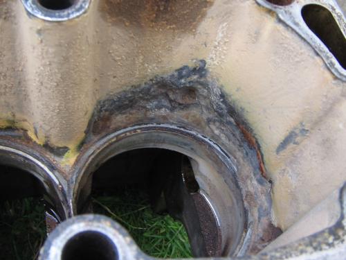

You'll find the crack will be due to corrosion inside the water jacket that has thinned the area. Remember the head bolts put a lot of load into the block in this area.
I'm not saying if couldn't be welded, but I've tried and failed in the past.
Leslie green
I see Tom, I thought it was frost damage , I haven't seen inside the engine but its been without water for possibly 10 years now so could be a right mess inside.

Telf
Leslie, here is a pic of the corrosion in one of the blocks I stripped- as Tom says it can be quite bad even with a serviceable replacement.
I had to reject this one for a rebuild even though it was a known good engine.
Leslie green
Can see that's a bit dodgy by the liner seat alright Telf. No engines have surfaced locally yet but got other jobs to do anyway .
