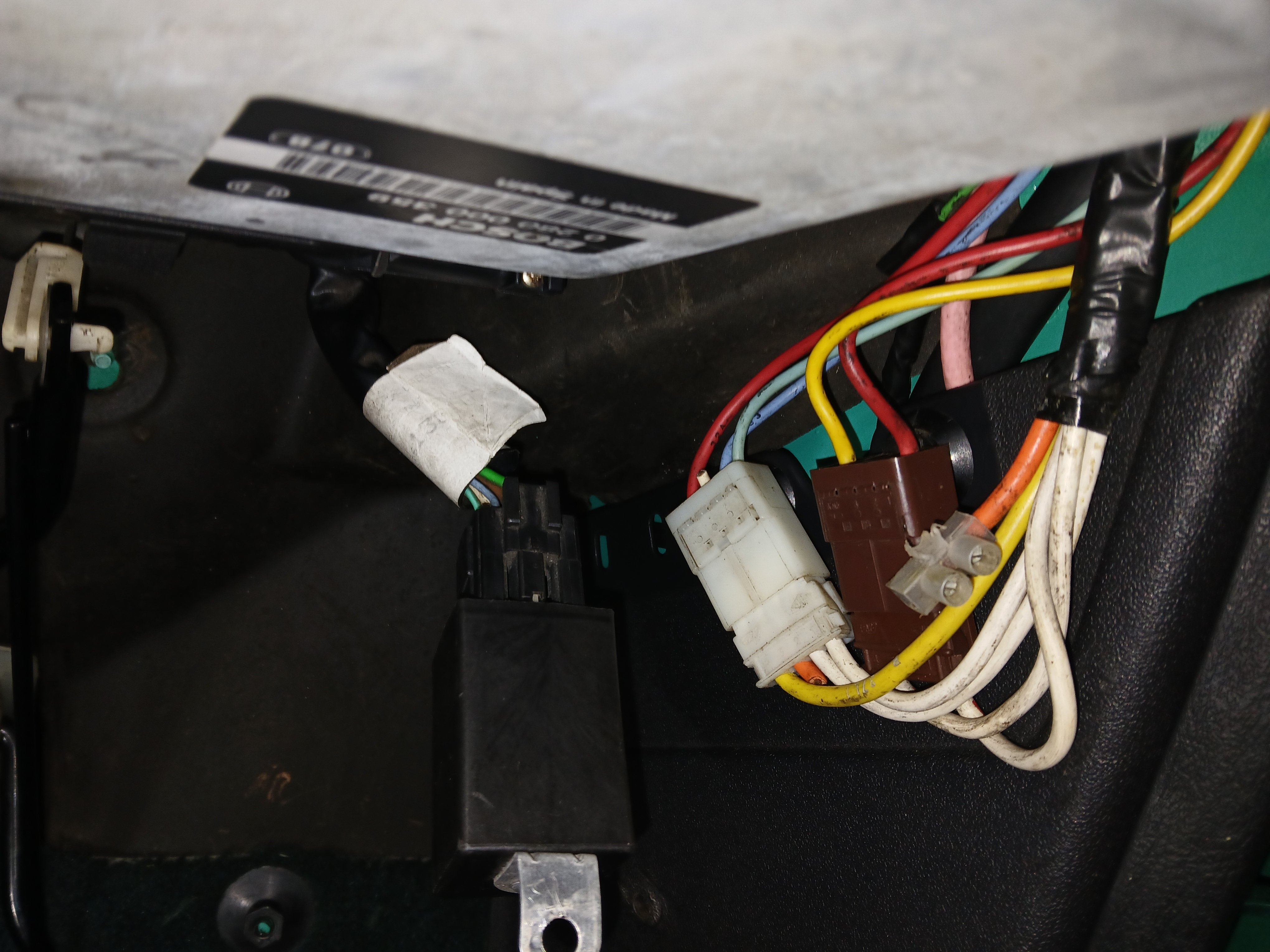

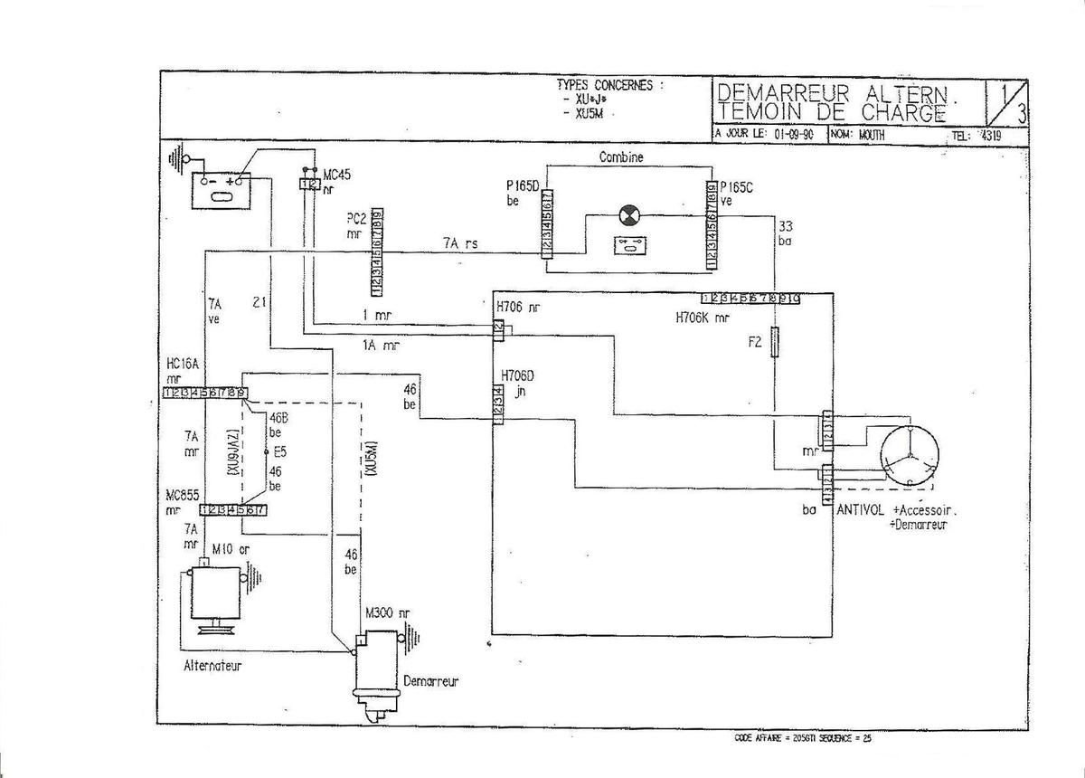

I have ohmed the solenoid contact wire all the way back to the brown 9 pin plug under the dash and its zero ohms . Not sure where it goes from there somewhere in the fuse box but I now thing there may be an issue at the ignition switch wiring as the gauges drop to zero and dash warning lights go out when you go from position 2 on the key to position 3 . It worked before I took it apart but that was many years ago. There are some dodgy looking connections in the fusebox where an alarm was probably fitted just taped them up for now as they are joined ok . There is a little brown single wire with a plug on going nowhere either not sure what its for yet if anything .
Will check the ignition switch wiring next week when back down .

Not a huge amount to it, sometimes you’ll get that lights going off when trying to start if the earth is not securely fastened, but I’m sure you’ve checked all that.
Leslie green
Thanks Donald I've had a poke under the dash at the ignition barrel and found the offending wire which was no doubt cut for the alarm years ago and has pulled out when fitting back in. Just joined it for now and yes it spins over but the battery is done and that's probably why the dash gauges etc still go off as there isn't enough power now

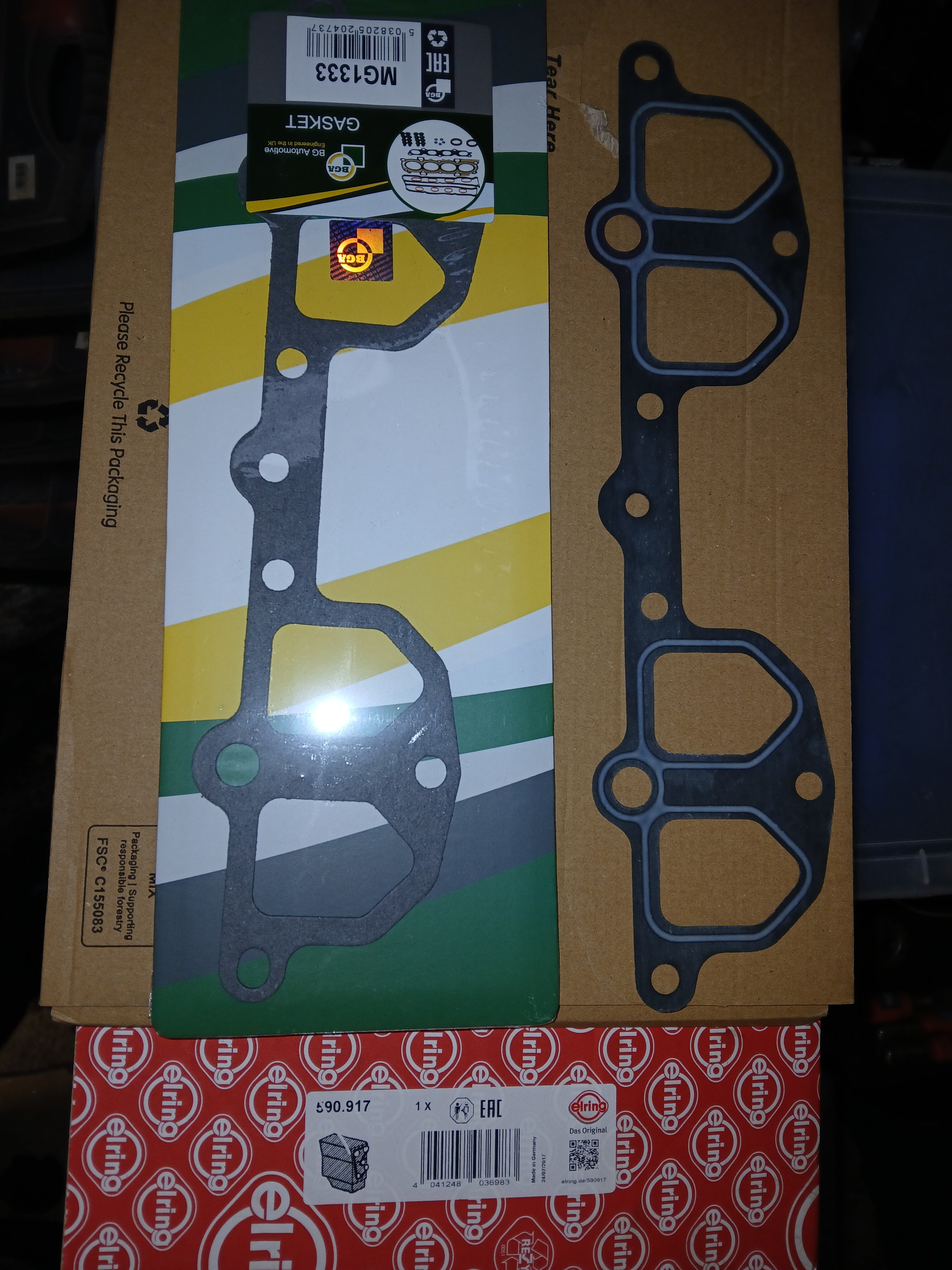

    I got a new inlet gasket but its nowhere near the quality of the elring one I had fitted ,this came in a full gasket kit and has the silicon trace round the ports unlike the cheaper ones. I can't find it outside a kit on its own so will just reuse the one I had in , the engine never ran and there are no depressions in it , looks like brand new which it is .

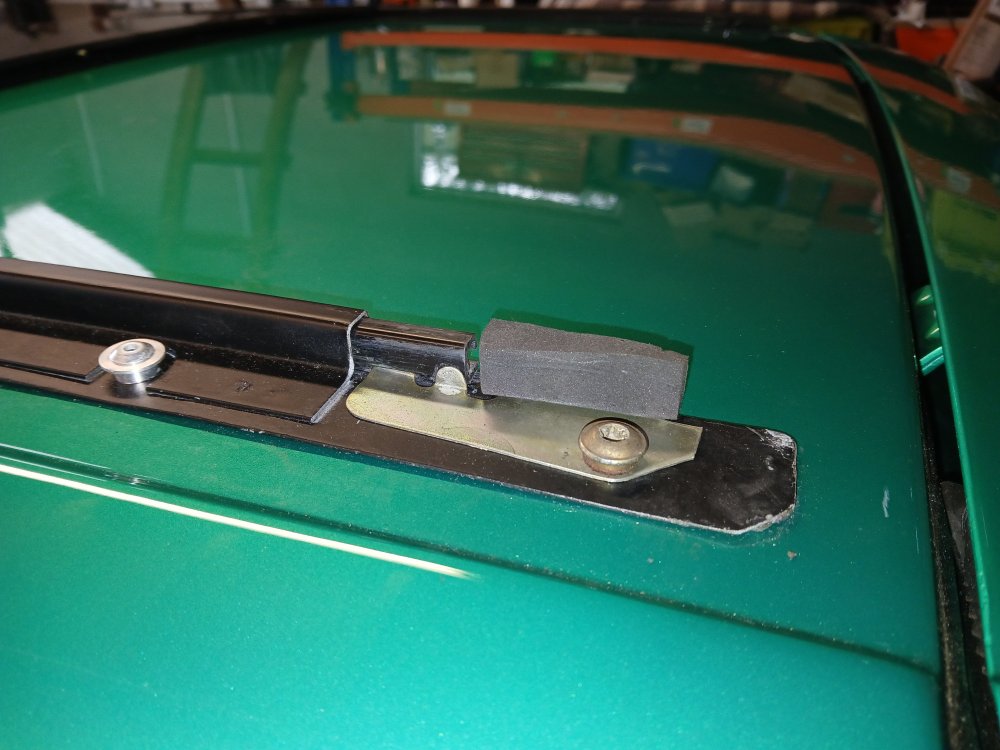

    Having a problem with the sunroof cable its still not releasing one side but I think I must had put the 2 wires to the latches the wrong way round as the drivers side is too loose and the handle pin is under too much strain  so will check that at a later date.

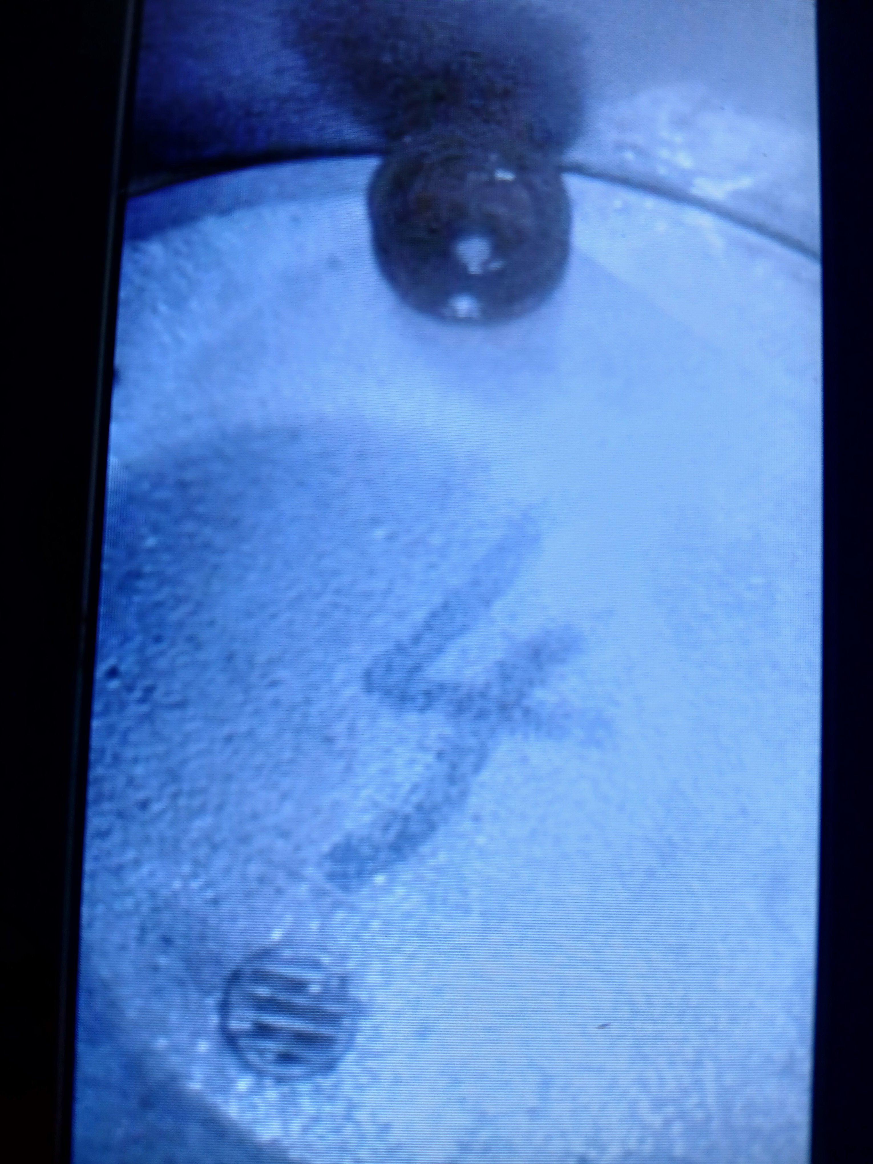

I turned over the engine on the crank pulley a coupe of turns  and as I wasn't sure if it was actually in there as with the plug out I couldn't see it , I spun it over on the starter with the plug out to see if it would come out the plug hole . In my haste I forgot the spanner was still on the crank pulley and it wound  the crank bolt right out 2 inches . Fortunately the pulley stayed on and the woodruff key kept the belt from jumping the timing . I went home after that as things were going from bad to worse lol
New day and went down to my mechanic mate who lent me a cheap borescope and sure enough it was in there ! After about 2 hours and trying a length of thin hose on the hoover and dropping in multiple times  I got it moved around under the plughole and one of those 3 legged grabber tools got a hold of it but it was slightly too big for the plughole but in the end a good shove had it out .

The brake  fluid cap pin was stuck down but appears to have sorted itself out with the heat so onto the sunroof and no matter what I do the cable seems 1/2 inch too short and the tension on it is way too tight and the clip pings of the pin . I thought the 2 wires to each latch were on wrong way round but they are both same length so its not that . Its the original cable , latch is new but they are all the same . stuck wit that one for now .... The pulley can really only go in one place and the cables the same and the cable can't have shrank , confused .com ......

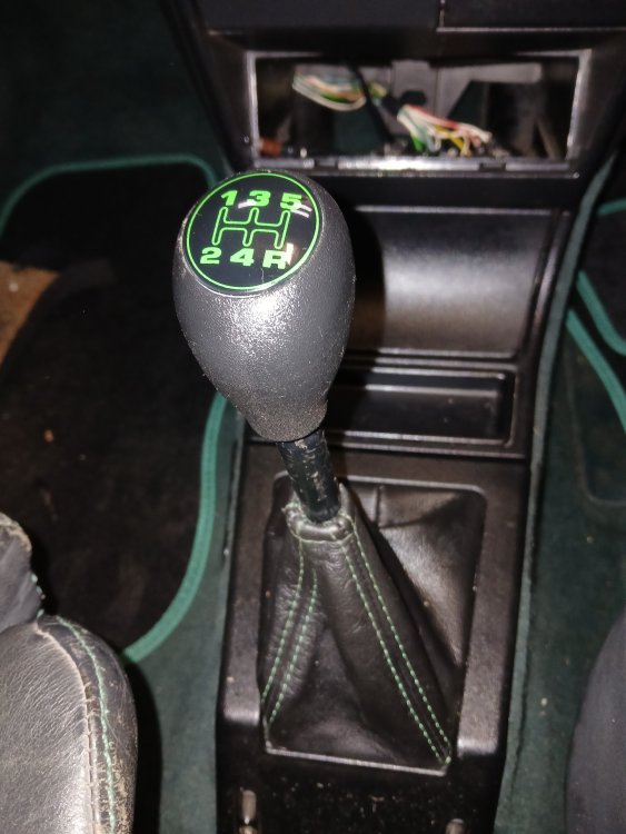

Had a little drive over the grass field to a carpark , was correct speedo isn't working , drove round a bit for 5 mins bedding in handbrake and on way back engine cut out and won/t restart ,thought id run out of fuel so went and got another 10 litre but no difference , now battery flat , had to get the tractor out and drag it backwards with 2 tight turns round a big trailer with very little room , had the handbrake up a couple of notches so it didn't hit the tractor , they freewheeled it backwards down to the shed .

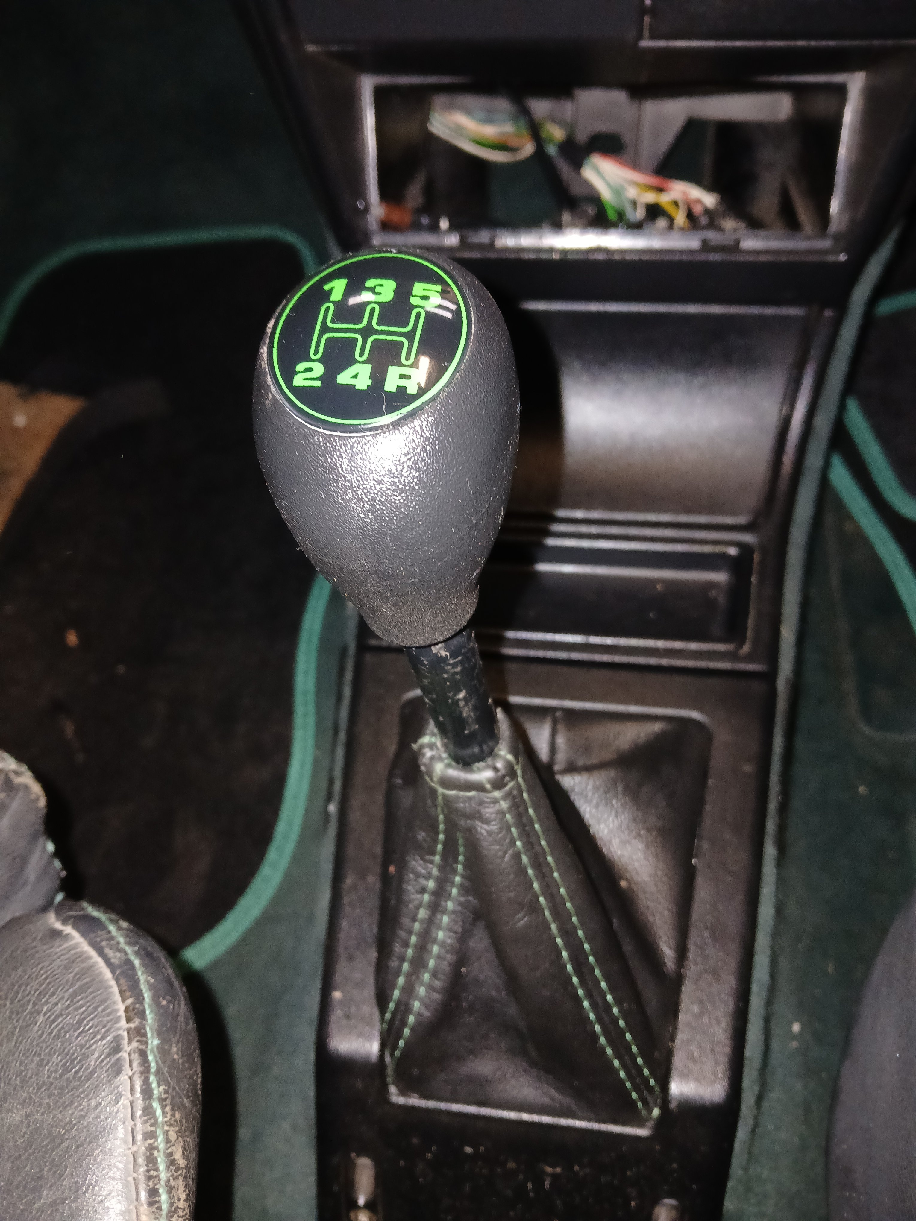

     Got the green stitched gear lever gator and Griffe gearknob fitted , I put a couple of small rivets in to hold the 2 plastic pieces together as when I got a better stabler it just bust the aged plastic . The gator was a super tight fit and didn't want to go down past the nylon sleeve on the gearstick and the gear knob was tricky to fit also , wrapped a towel over it and gave it a whacking with a bit of wood in the end after warning it with a hairdryer first. It was sold as genuine but given the amount the seller has sold I doubt it !  I also got a little bump stop made for the sunroof out of rubber  and got the wiring under the dash soldered for ignition feed. 2 steps forward and 1 back lol
