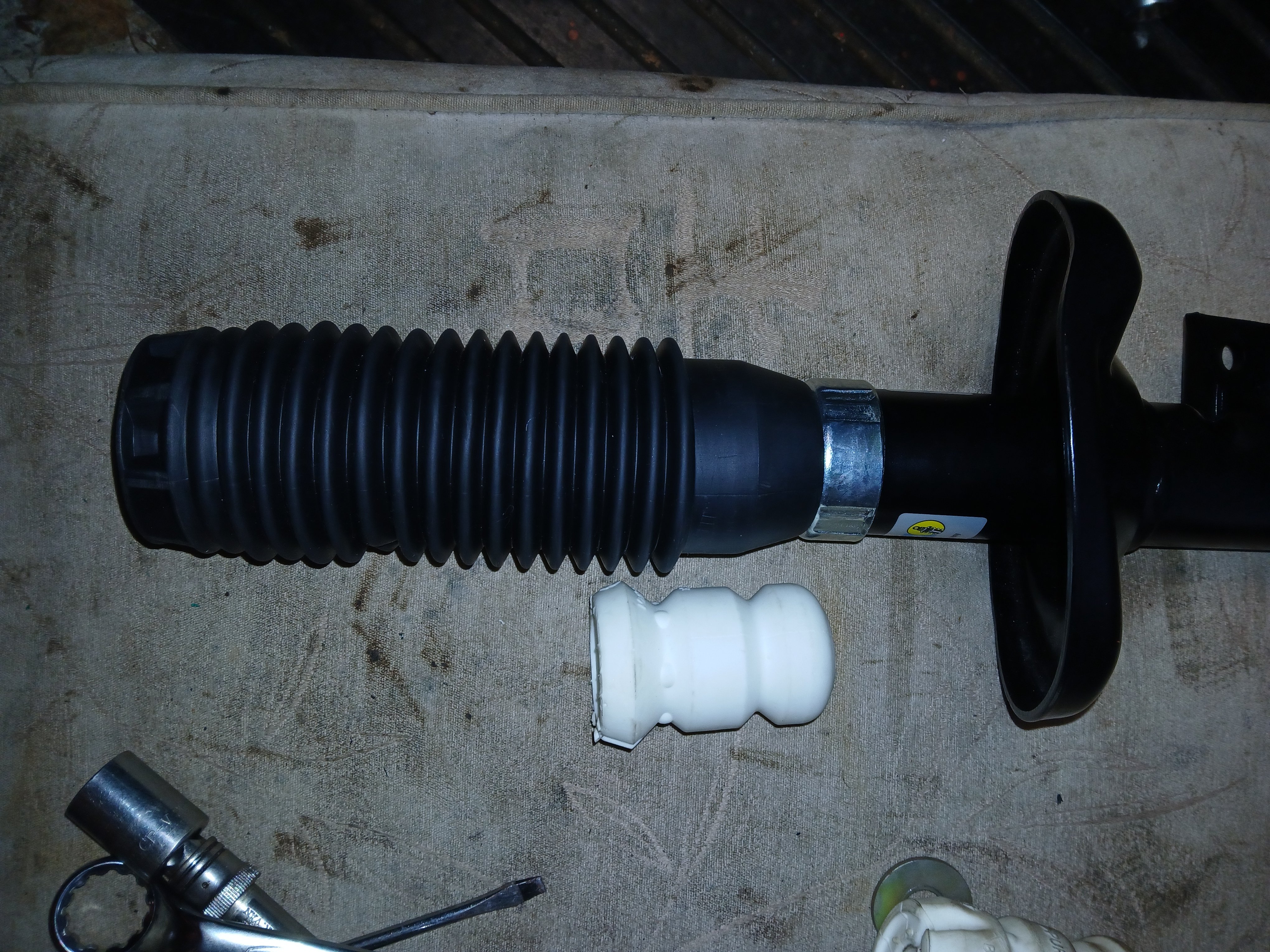

Thanks fitted today and shock back off to fit these new dust boots,still only one bas arrived, but can't decide what way they go again ,couldn't go either way and seem worse located than last ones .does the domed bit go up as there is no way to hold it up there ? This way up it will lock into topmount but looks wrong ...
Edited by Leslie green
jord294
Rod protector is upside down. Don't forget the large washer after you've slid bump stop over
Leslie green
Cheers  these are going to just float about as there is nothing to hold it , might just fit the others back on , the bump stops came with these are shorter so will use those .
The bump stop holds them up.

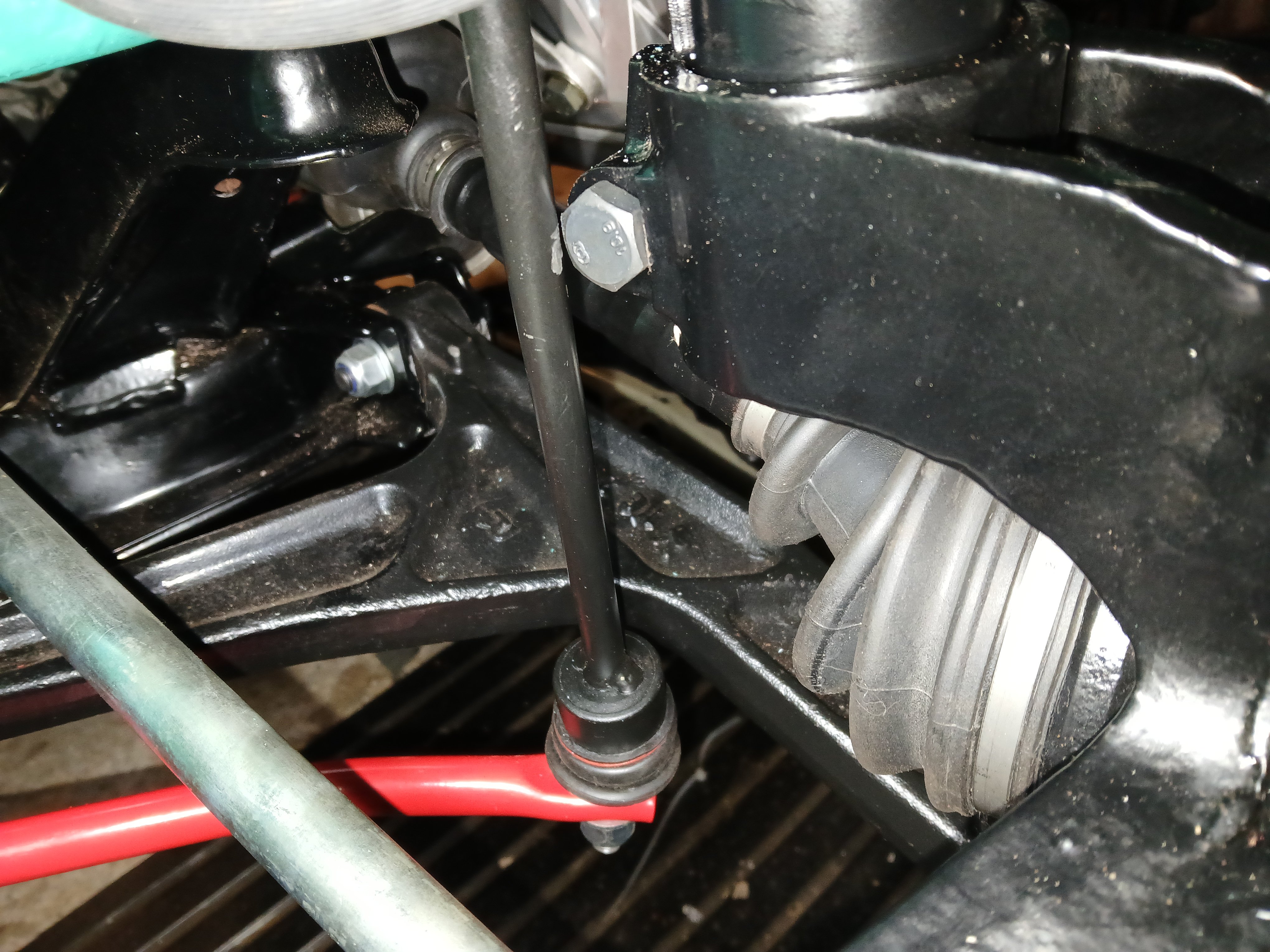

Thanks just one of those things with the pins , I've another issue fitted the droplinks for front antiroll bar and on lock both sides are catching the strut bolt ,at first i had the nut on the other side and thought that was the issue but its still catching . They seem to be same length as the originals so not sure whats up .
i have seen this quite a few times, a washer or two between the droplink and the tab on the damper to space it out is usually enough, I think either the droplink tab is welded at the wrong angle or the locating tab.
 I have also seen the locator tab welded too low on the damper body making the damper not sit fully in the Hub carrier clamp, not a huge issue on the 205 hub carrier but the 96 on 306 had a hollow casting so the damper was only clamped by the upper section :blink:    after a decent impact the bottom of the damper bend and came out of the hub.
Leslie green
That's doesn't sound good about the 306, the dampers  seem to be sitting fully down the same amount each side on this  . I have one original droplink the tapered type but it looks well worn and it just tapers to the same diameter as these so its not the rod diameter is the issue  , most likely is these are not made quite right and a coupe of washers is an easy fix.
