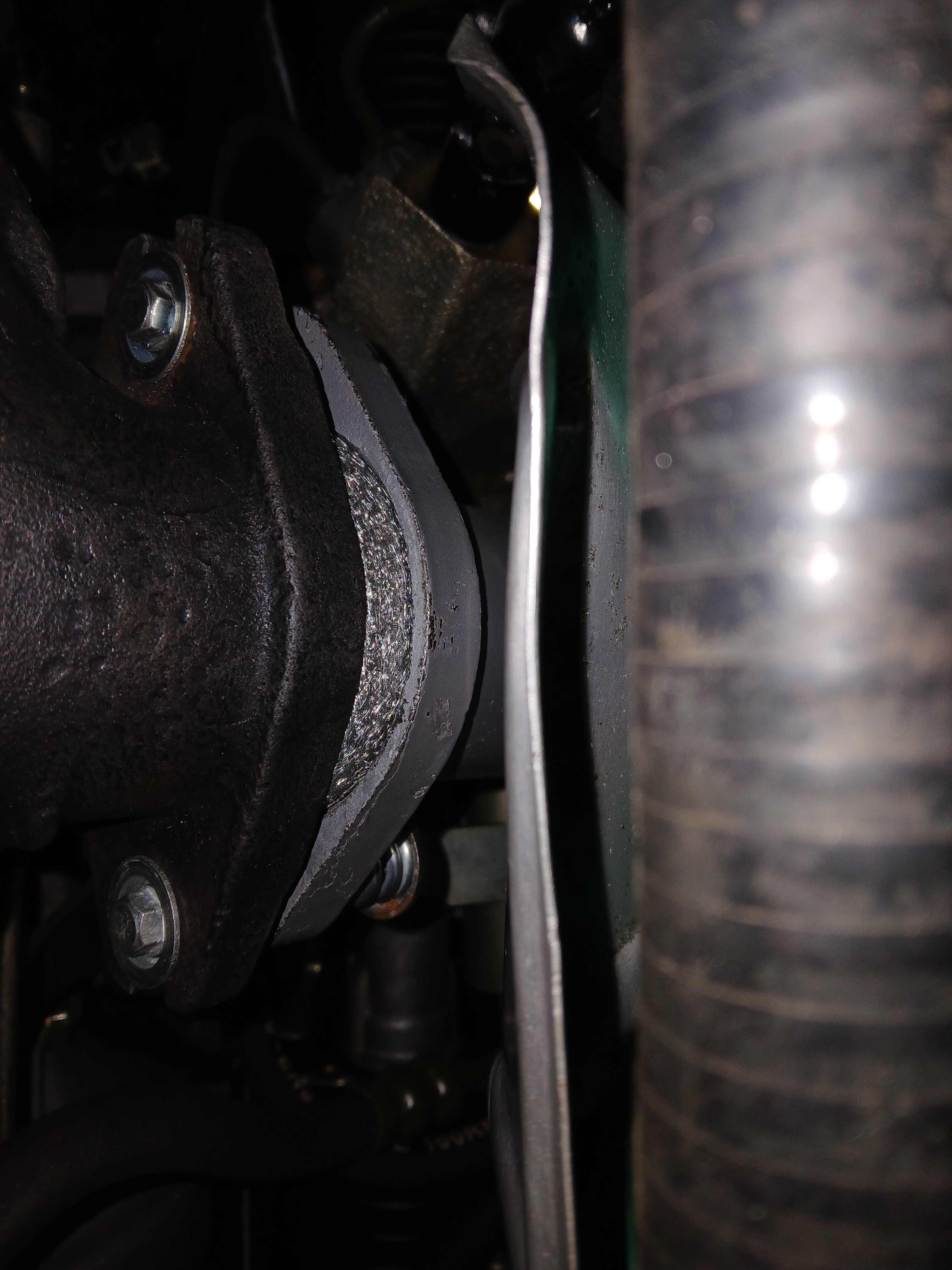

Was removing the exhaust manifold nuts and nearly had a disaster , one flipped out of my fingers and into the port , I turned the engine upside down on the stand and shook it about a bit and luckily it fell back out again..phew !  Ports were blanked with rags after that .
