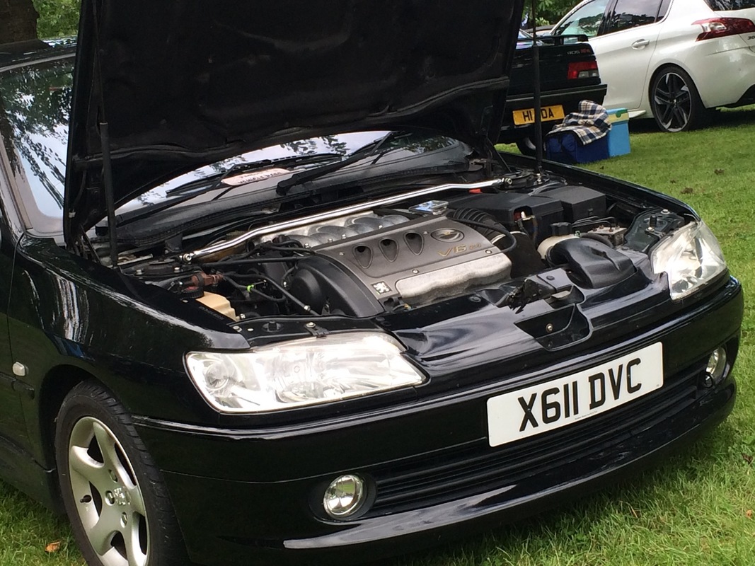

Here is mine at Pugfest last year.
I will be fitting the later ES9J4S engine later this year.
