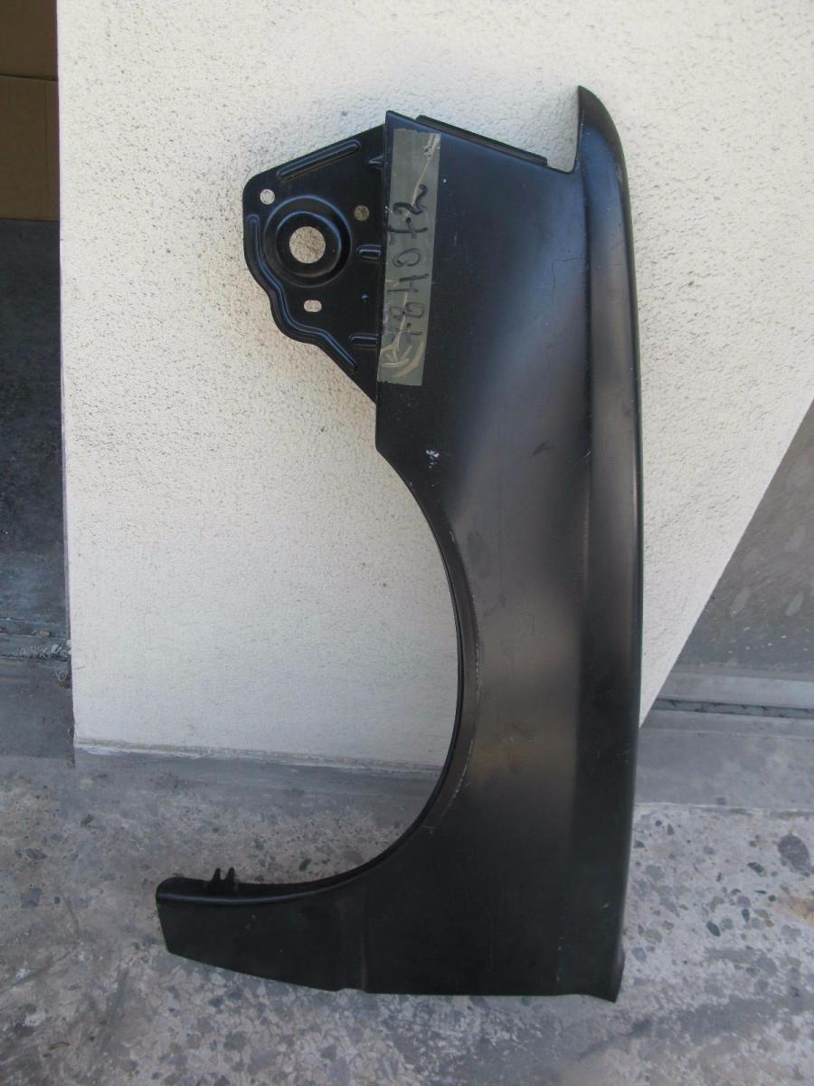

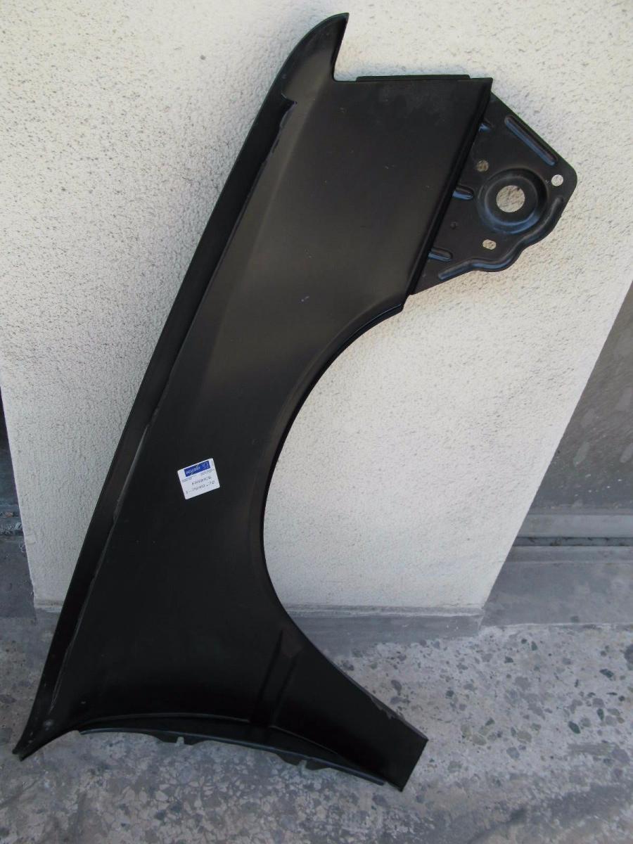

idoari 10 Posted May 10, 2017 Hi , what is the diffrences between the base model front wing and the GTi one? except from the the obvious , means - the trim holes , the indicator hole. i talking about the fitment of the wing. will it be different? and if it would, where i need to cut to make it work (please be specific). thanks Ido p.s. i adding a picture of Genuine Base model wing Share this post Link to post Share on other sites
steve@cornwall 100 Posted May 10, 2017 Will bolt straight on. Apart from trim holes the profile of the arch is different. A little trimming is needed, but best bet is to offer up the arch trim, mark the wing and trim it accordingly. Share this post Link to post Share on other sites

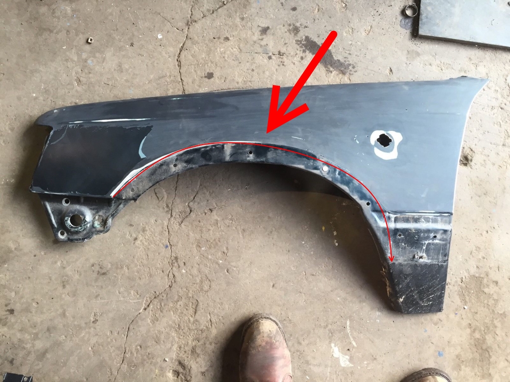

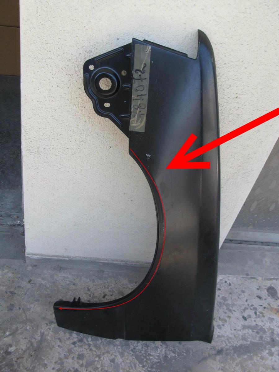

idoari 10 Posted May 11, 2017 thanks. another question , i search a picures of the genuine GTI wing and i found this one base GTI is the bend (mark in red) the same as GTI ? in the picture it looks like it's diffrent but maybe it's the dirt and paint thanks Share this post Link to post Share on other sites

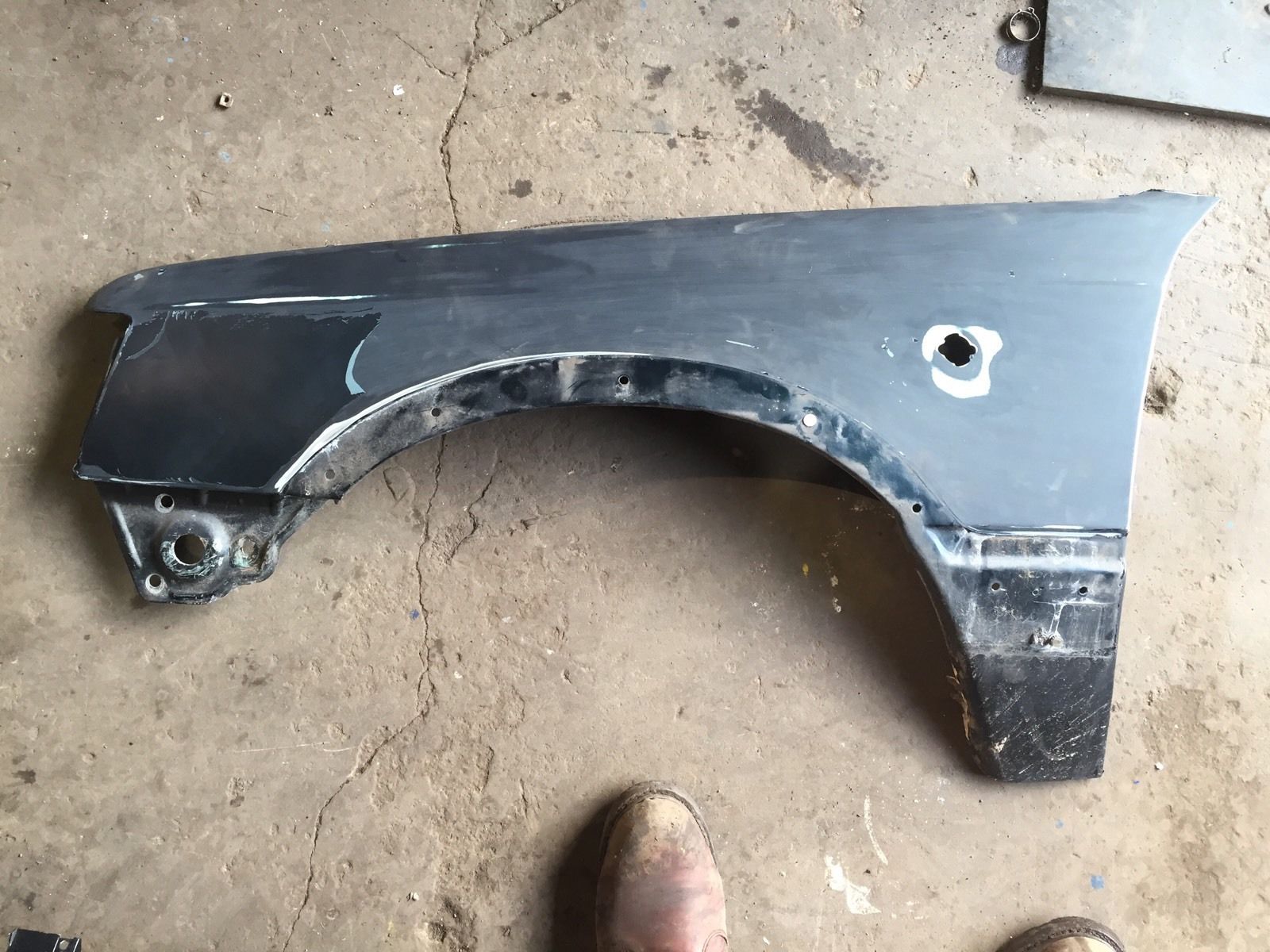

steve@cornwall 100 Posted May 11, 2017 Don't think there's any difference at all. I think that's just a line where the arch used to be. Here's one I did Share this post Link to post Share on other sites
