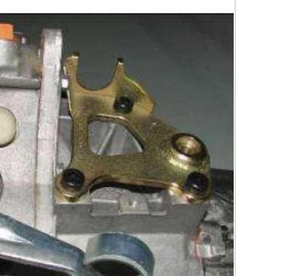

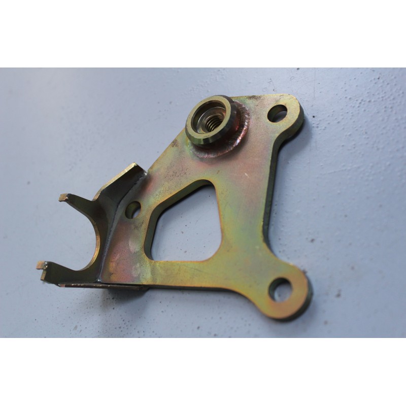

I have secured a 20DP32 box. Any clues where I'd find one these adaptors? If not, it's a great job for the new plasma cutter and I can make a few.

The threaded part isn't on the right place for a 205, also a brand new one is 210€ + shipping down under.
carter-d-embrayage-mv-mvs-ew-206-rc-gra.
