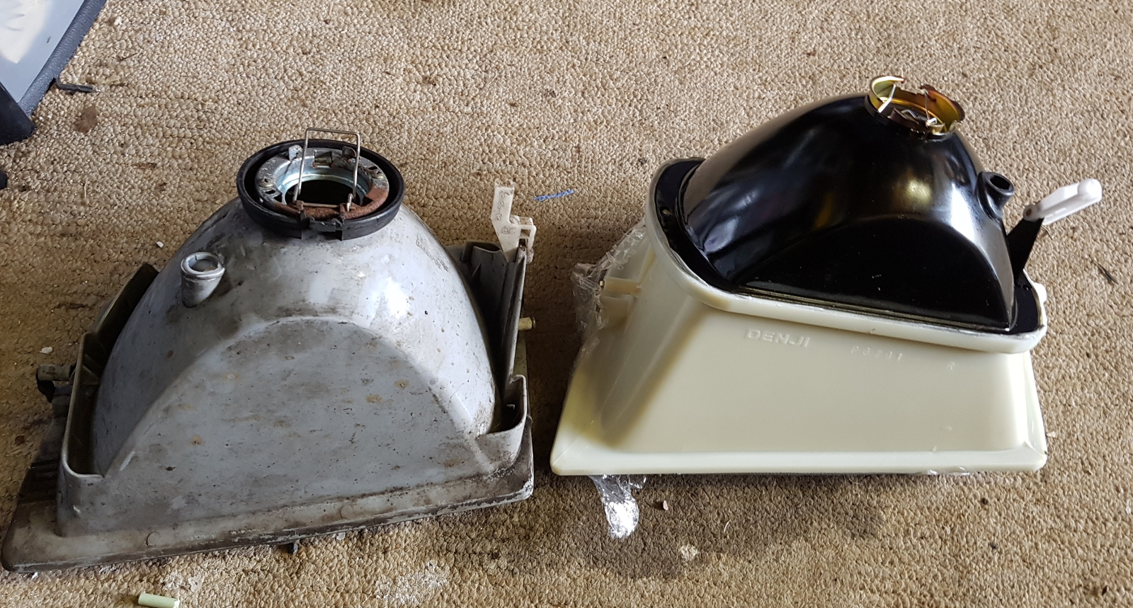

davemar 16 Posted March 19, 2017 I've just bought a RHS headlight from GSF and was all ready to fit it when I noticed it didn't look quite right. The photo shows my original Lucas on the left and the new Denji one on the right. You'll see the two main problems are the sidelight is on the opposite side of the body, and the ball-joint clip is round the wrong way (socket in the Lucas one faces away from you, whereas the Denji socket faces towards you). There's no way this going to fit in the car, so it'll need to be sent back. Anyone else experienced this from GSF and had any luck getting a suitable replacement? Share this post Link to post Share on other sites
welshpug 1,676 Posted March 19, 2017 that'll fit fine, its just an earlier type of headlamp, originally made by Marchal, the balljoint link can easily be turned round if you cant get it to clip on. Share this post Link to post Share on other sites
Miles 331 1 Cars Posted March 19, 2017 As above, but they are pattern parts and not always going to fit well, you need to remember GSF just buy them in a sell them on without any knowledge of fitment, Even the Lucus ones are not quite as good as the Valeo units Share this post Link to post Share on other sites
murtaghp 3 Posted March 20, 2017 I had the exact same headlights from GSF about a year ago but returned them as the lens pattern was all wrong and they were not "e" marked anywhere. They did have some markings on the box but it turns out they were some American standard. They took them back no problems although I did have to pay return postage. Share this post Link to post Share on other sites
