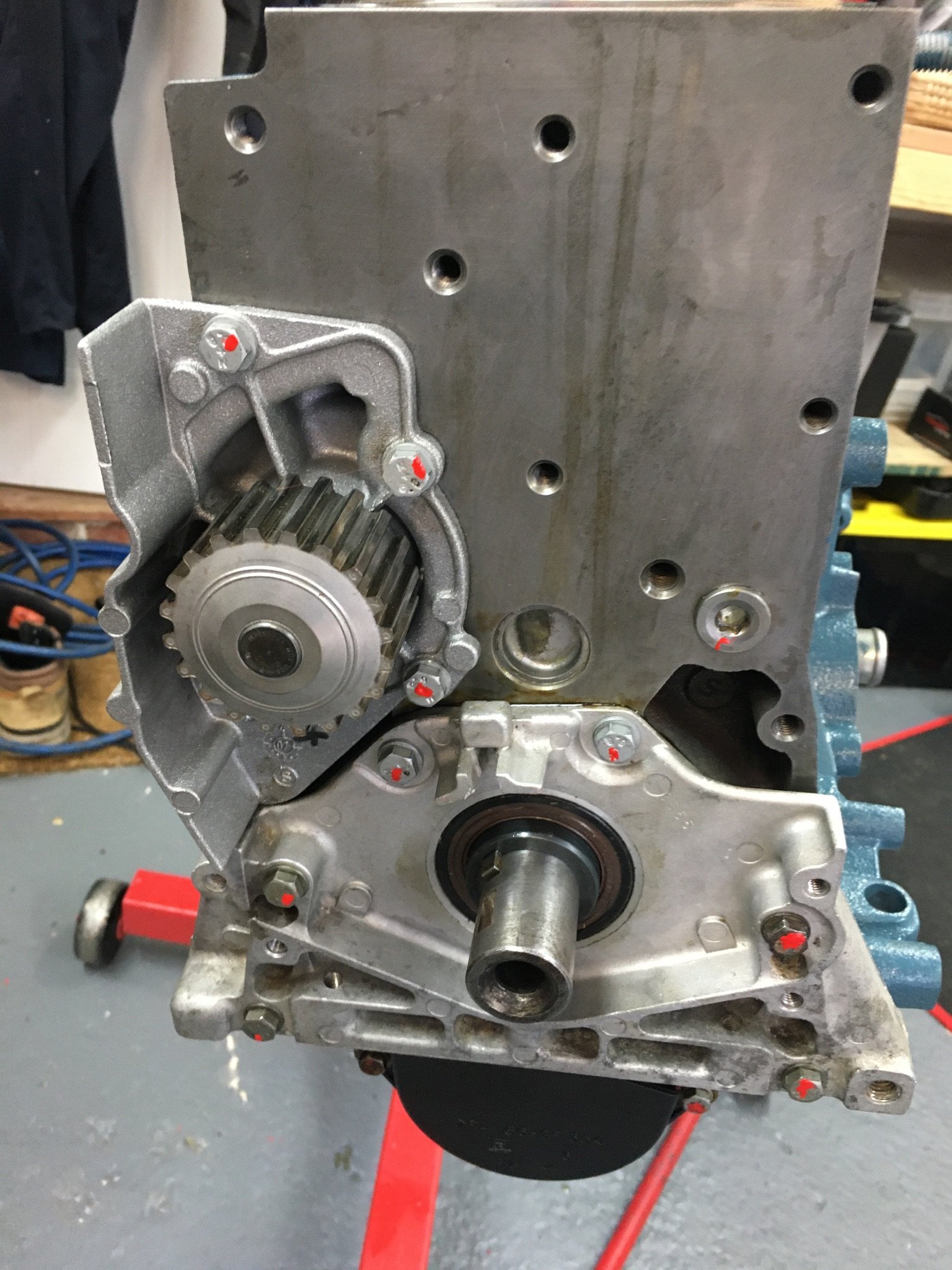

Andy
My attempt at a few pictures

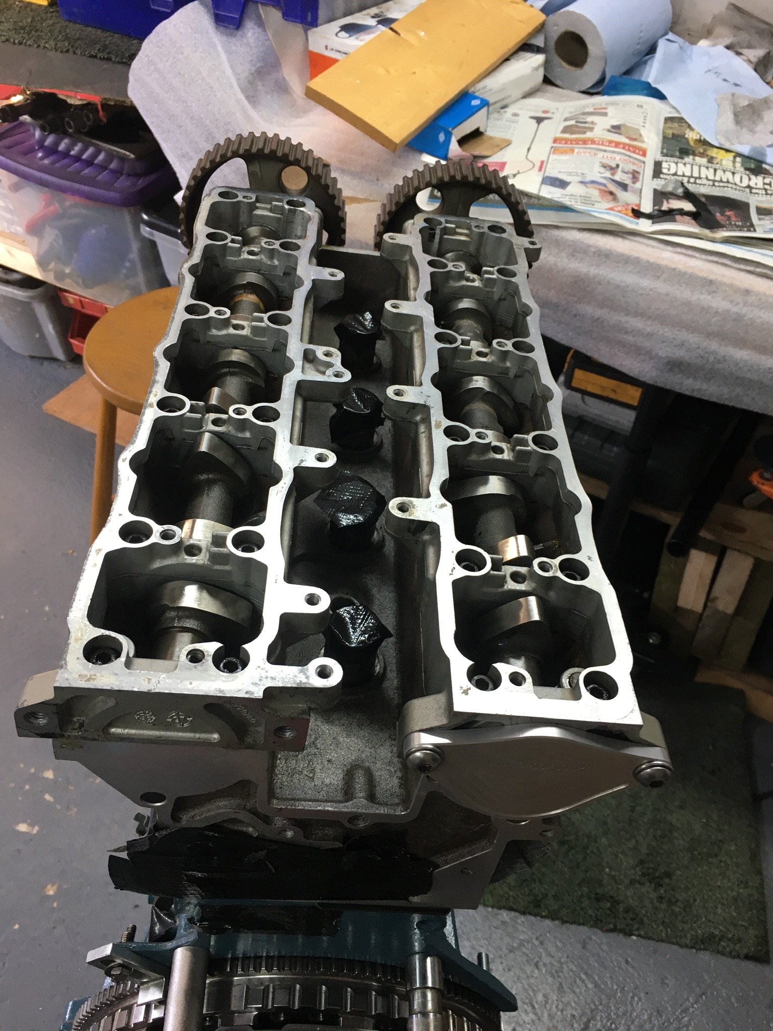

Andy
And my attempt at an extra couple .Richard is now just waiting for the arrival of his rebuilt box with LSD and between us we will get the engine and box on first name terms and he will then insert into Xsara .

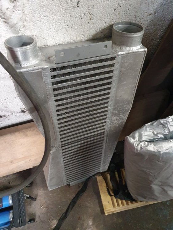

The water & oil cooling systems are going in now, & we start plumbing in the intercooler next weekend. The new turbo SHOULD just drop in, but will still need some mods to the downpipe & exhaust manifold flanges.

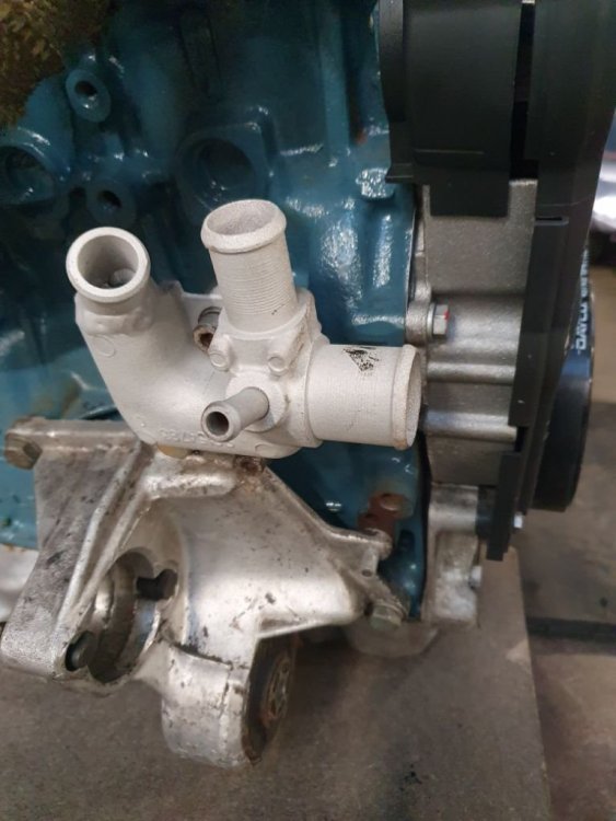

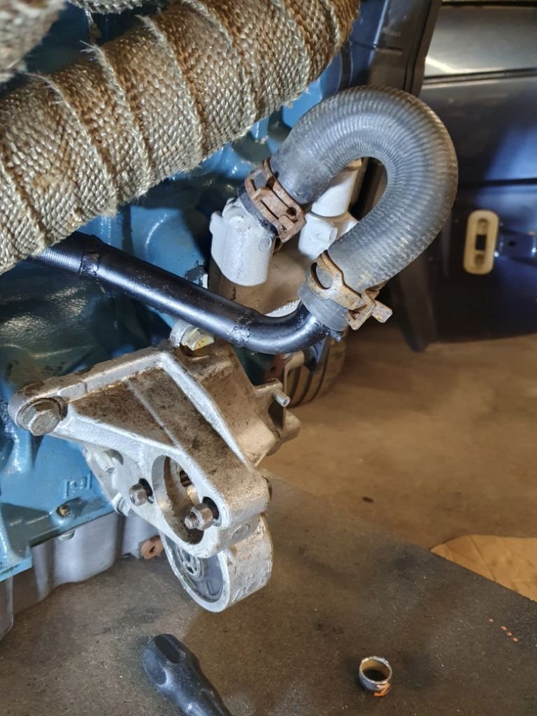

While plumbing in the lower coolant hose that joins the bottom of the rad, via the right hand inner wing with the water manifold on the back of the block, we noticed that a chassis cross member had a nasty crease from where the previous owner probably smacked a kerb or something.
George & another one of his customers just waded in, ground things back, welded on tabs, slide hammered & dollied things back into place, primed & painted things & all I could do was watch in admiration & keep the place tidy.

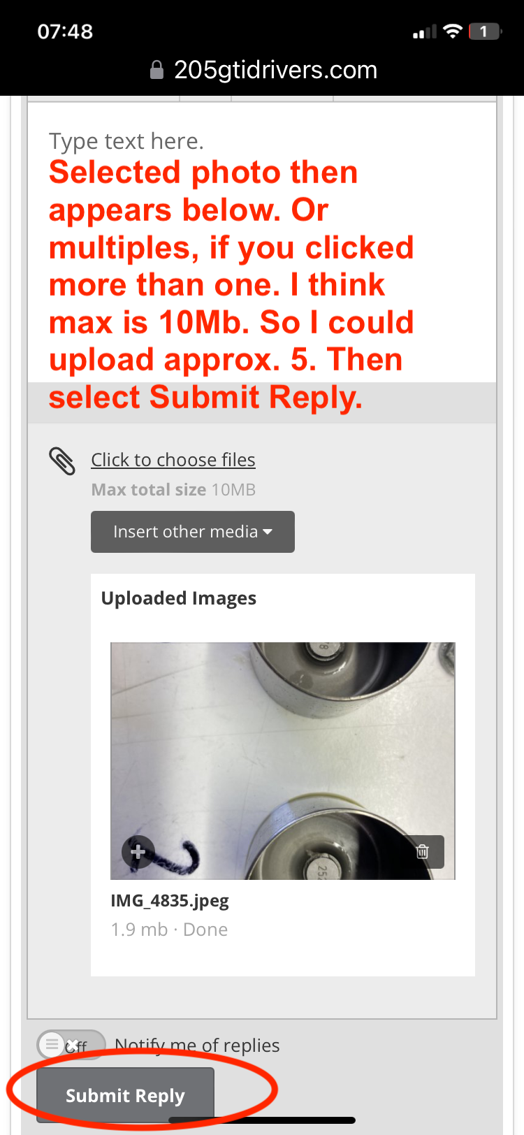

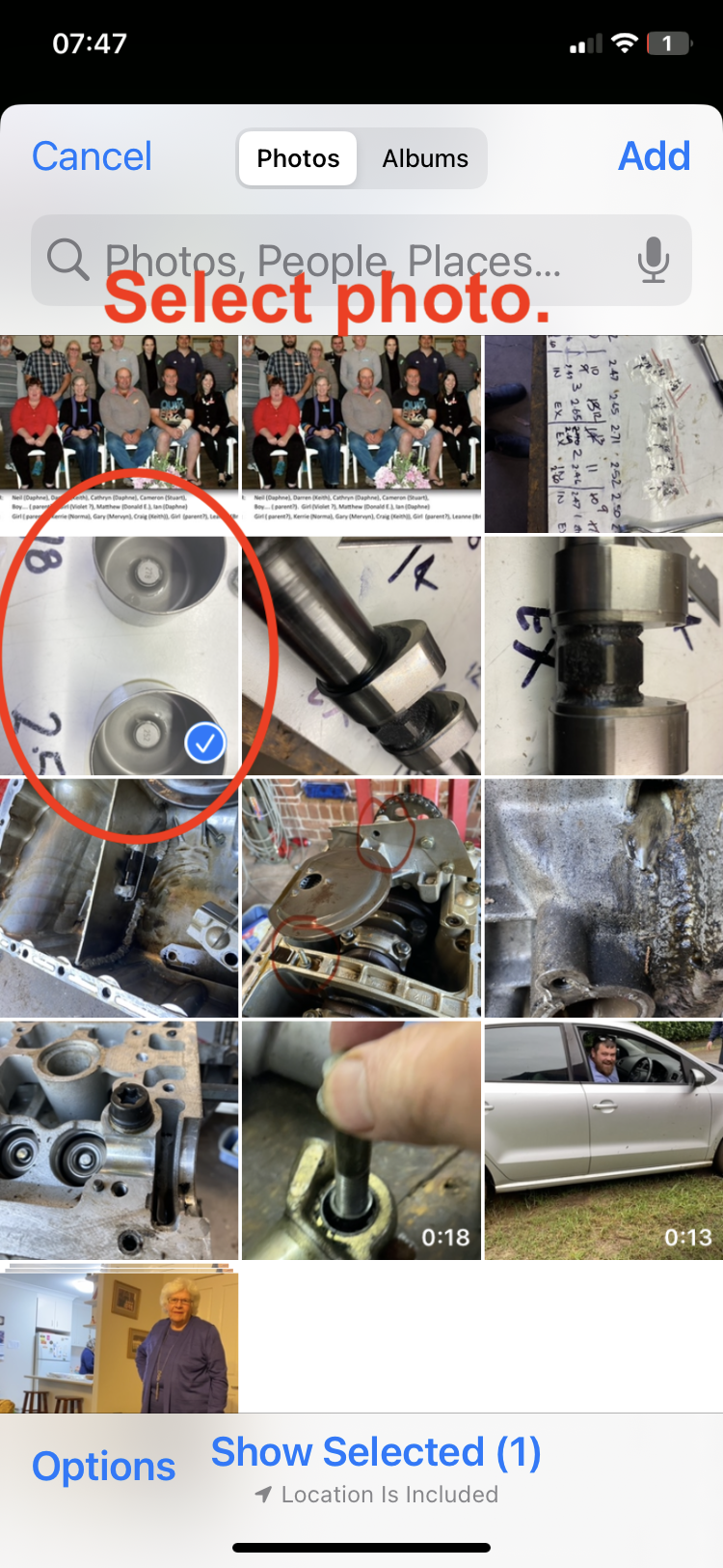

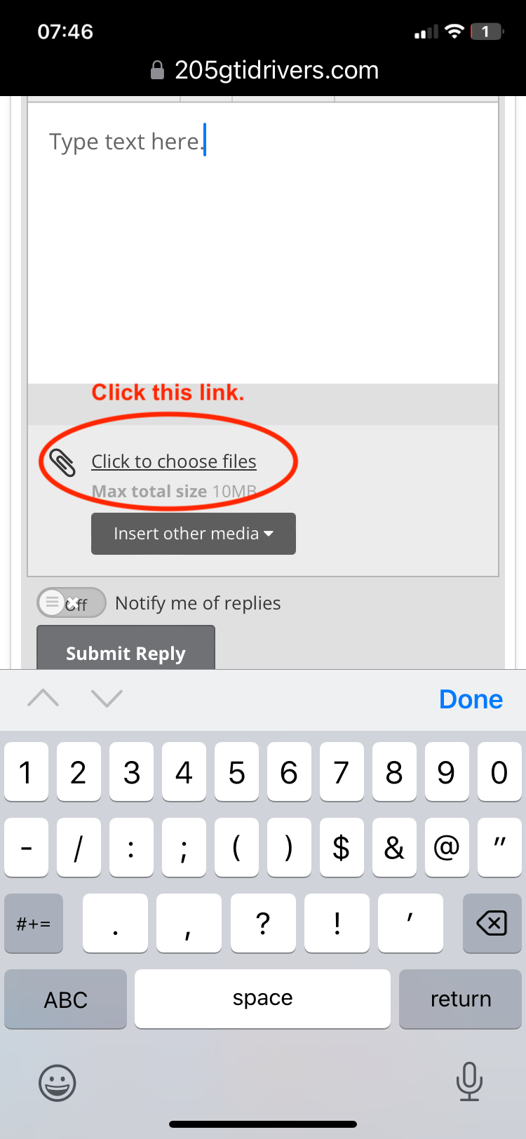

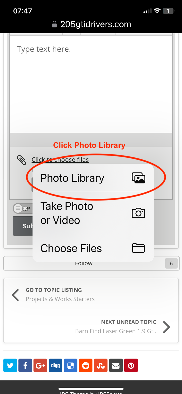

Right!!! Someone treat me like a complete idiot & tell me how to include images. Not as links but showing in the post.
I used to upload to Photobucket but I've ditched that, then copy the *.img link & it appeared; job done.
That was all on PC. Now I'm trying to do it from a 'smartphone' (!!!), & I'm an IT project manager too (!!!!)... so I now feel thick as f*ck!
Tell me how to do it please.
P.S. Sorry.
Hi Rich, don't be sorry. I think my turbo build is also slipping, with my wife not working. Here are the four steps I just did on my iPhone, in order. Sorry, no idea about others.
DrSarty
Good. Looks like it worked & was a simple as that. I thought that button was for adding attachments eg a document to download rather than include images.

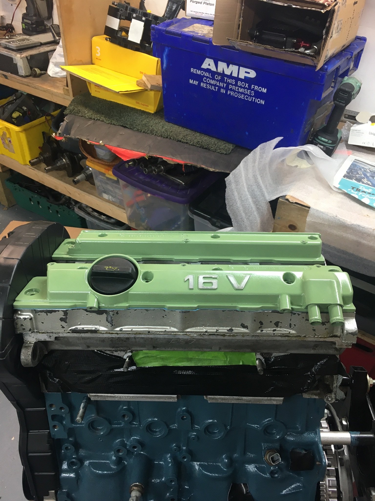

Anyway:

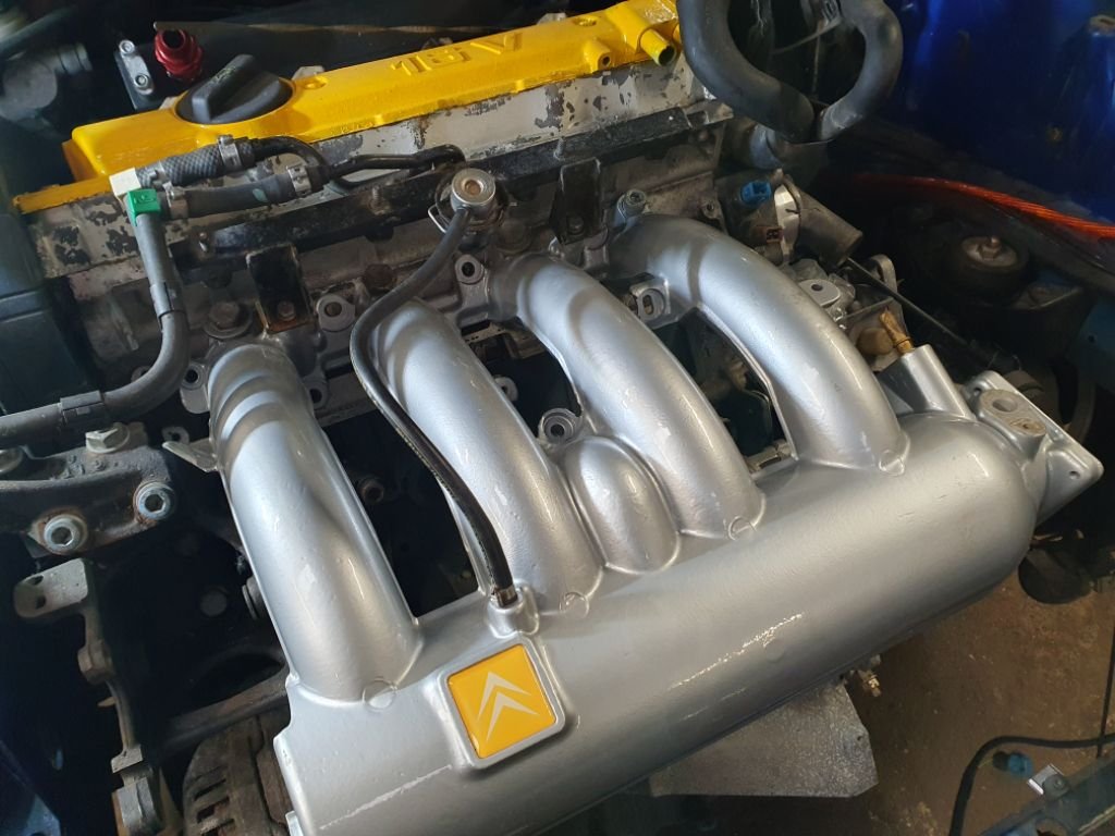

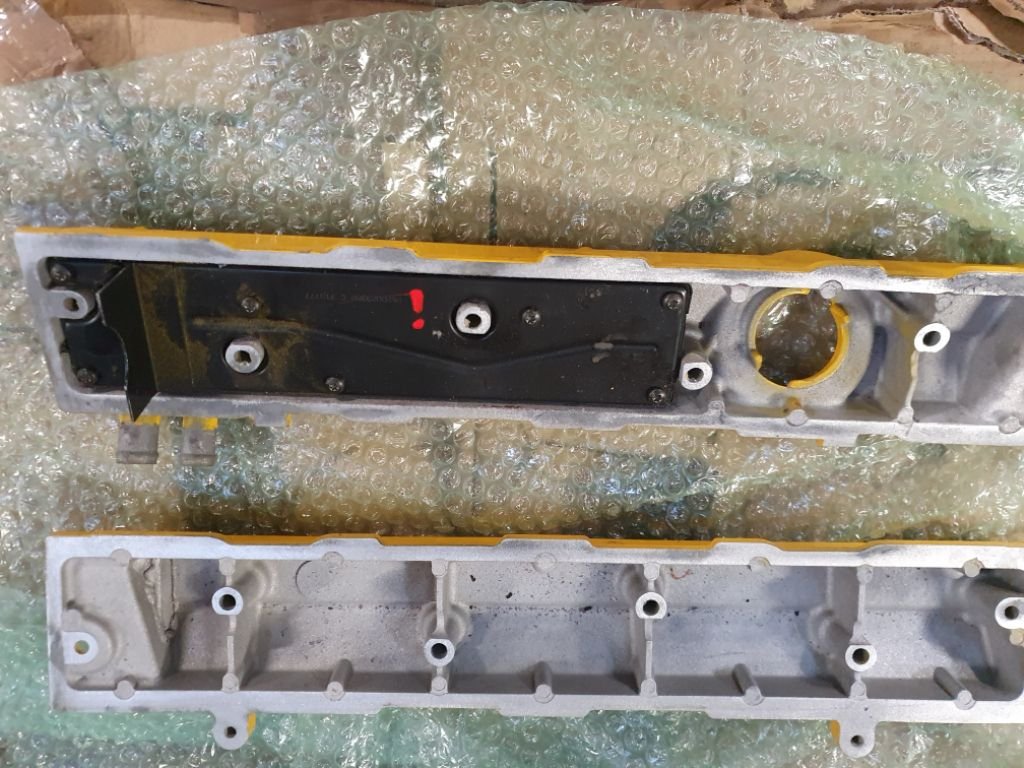

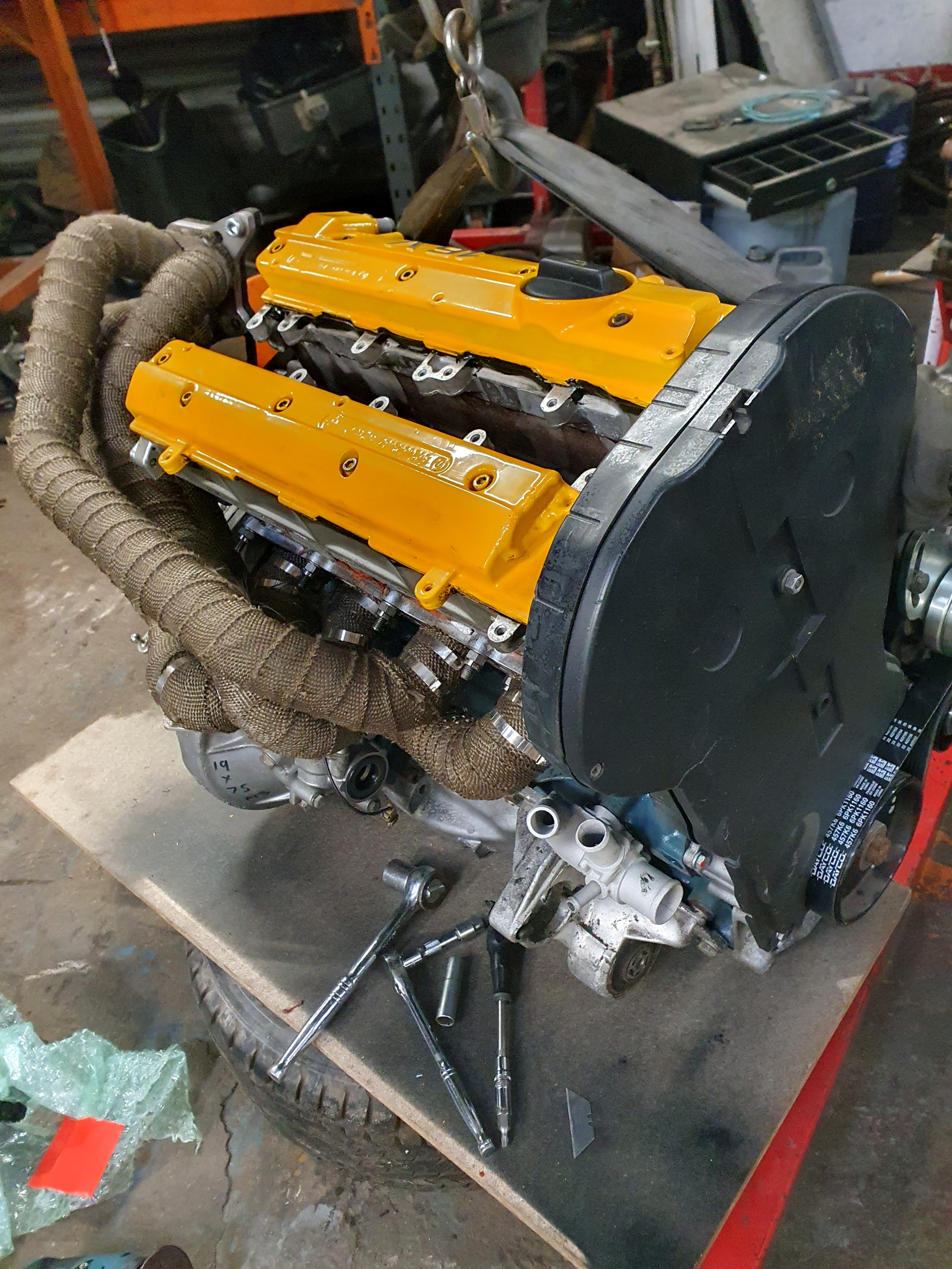

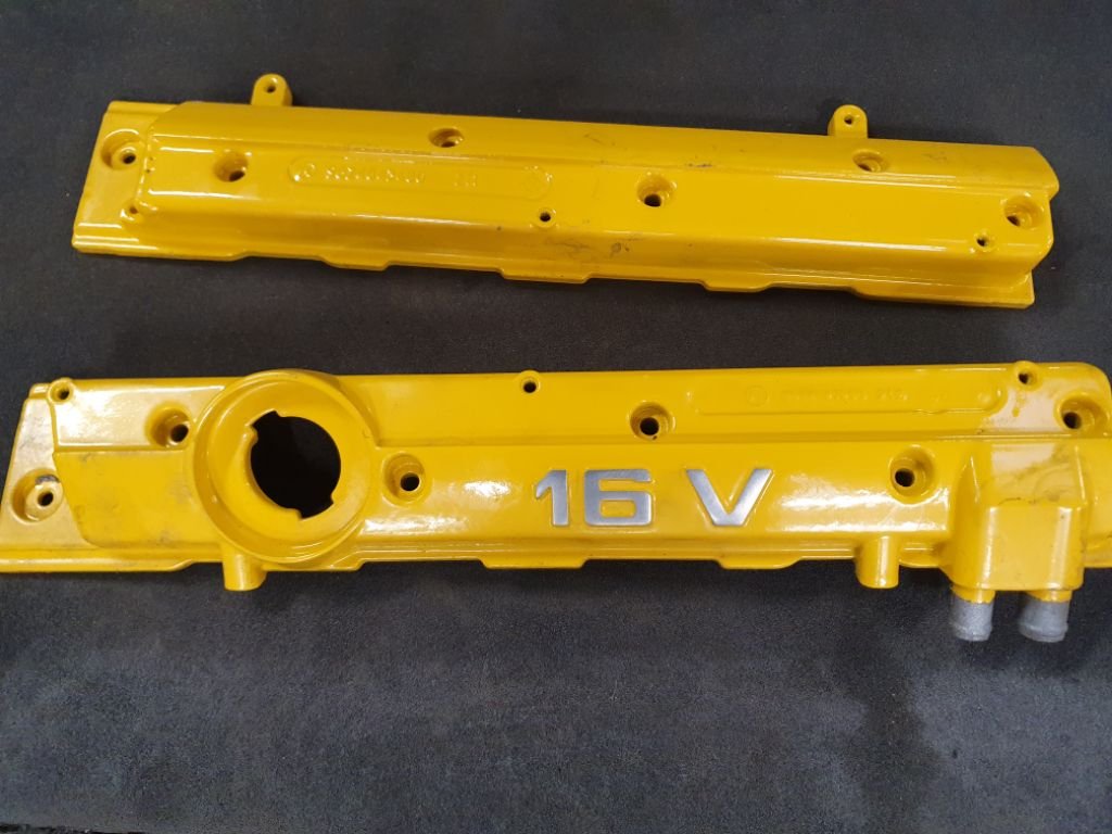

George insisted on blasting & powder coating my cam covers. I'm glad he did.
Also shown is the non-George powder coated inlet manifold, complete with eBay badge.

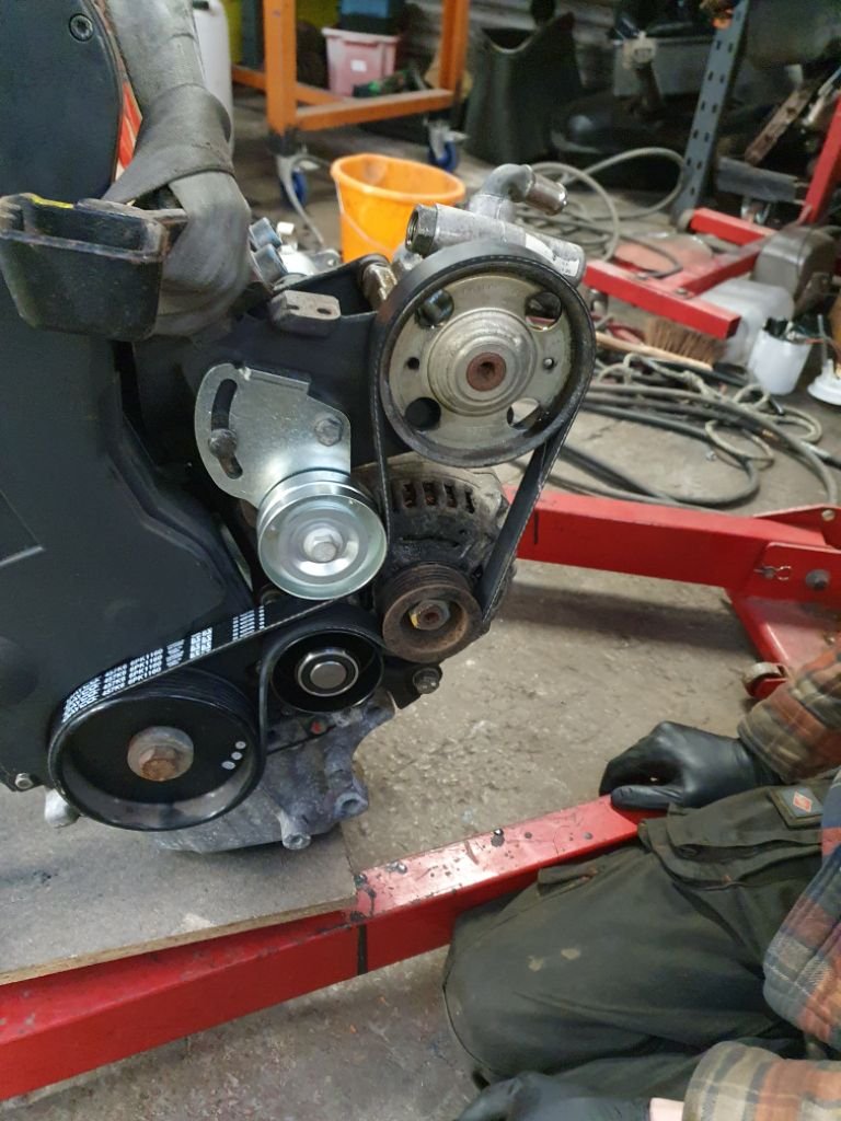

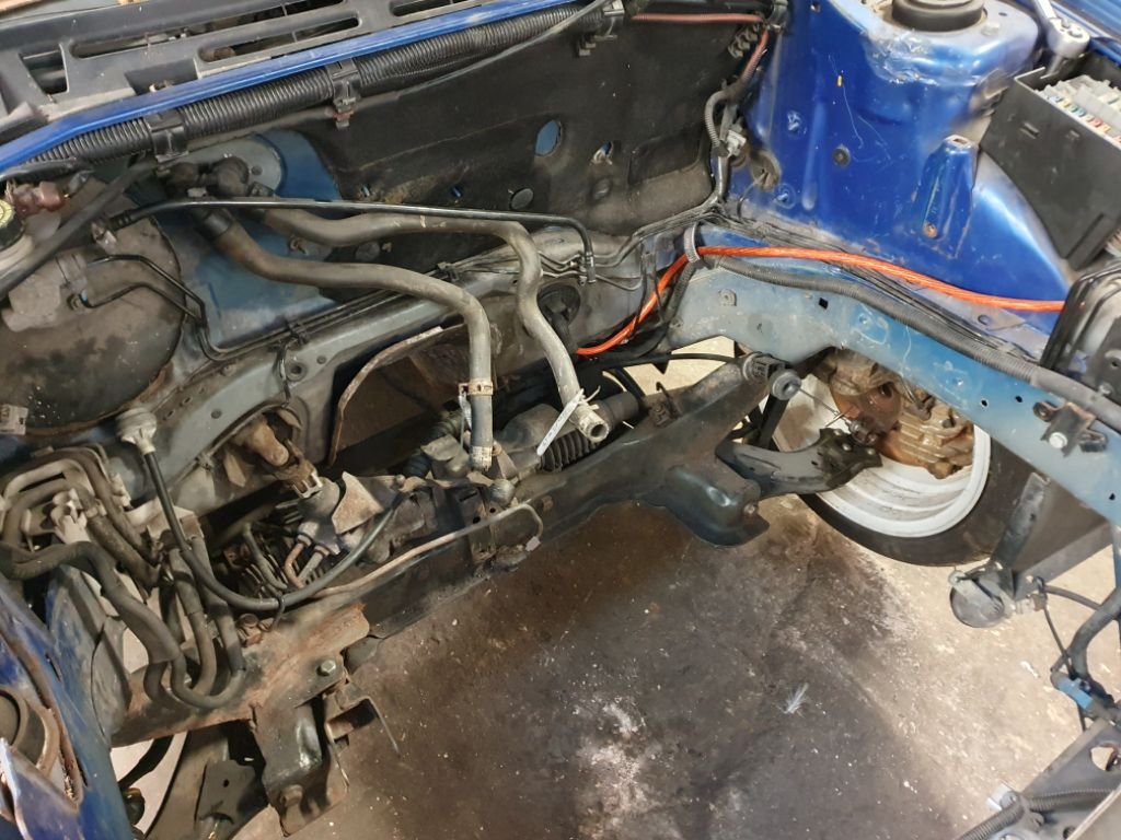

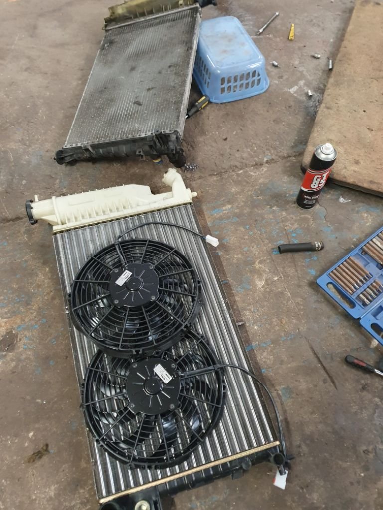

2 x 11 inch Spal pull fans going on the rad from the 2004 Xsara mkII that George is breaking, as Welshpug spotted that the new rad I'd bought wasn't thick enough.
The engine bay has been tidied up, including concealing the orange power cable going to the battery in the boot. It had to be relocated to make way for the lovely Owen Developments turbo (pictures of this next time).
We've had to make several custom bits like coolant pipes to route around the exhaust, but thankfully fitting the PAS pump was easy because Welshpug found the part numbers for the tensioner & idler. We used the pump from George's 04 Xsara.
The wishbones have been fully refurbed & we're doing the rear beam next time. Engine is back in the car now & hopefully staying in now. The intercooler, rad & oil cooler can then also be fitted & get plumbed in. The IC is a Nissan 350z version modified to have the inlet & outlet on the same end.
Thijs_Rallye
11 hours ago, DrSarty said:
I don't know what medium you used to blast this prior to the coating but it may be wise to remove the breather cover / labyrinth to check for blasting grit. I've seen a newly built engine being ruined on the Dutch forum a few years ago which still had some blasting medium stuck in the breather of the valve cover.
DrSarty
George removed the black part (baffle/labyrinth) before blasting it, & he is  also extremely thorough. I know as I had to screw it back in.
Top tip though & would be a silly way to trash a possibly £4k engine! And that's not including the Owen Developments turbo, which is a beautiful piece of engineering BTW.
