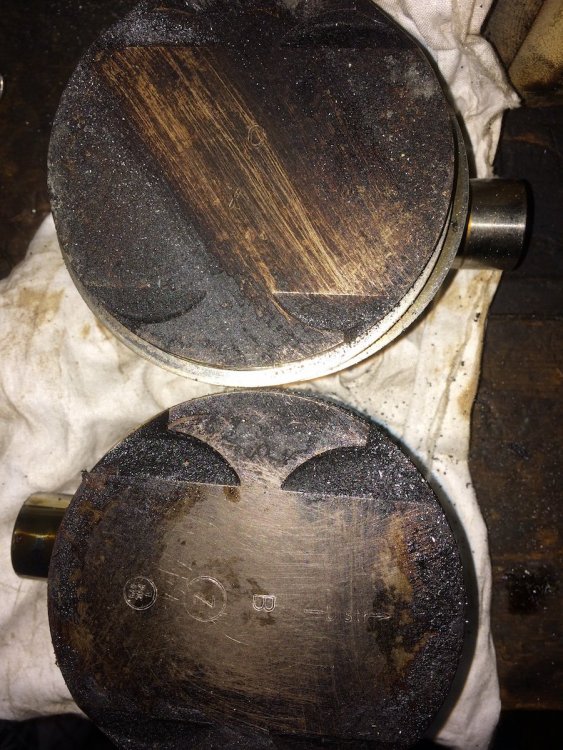

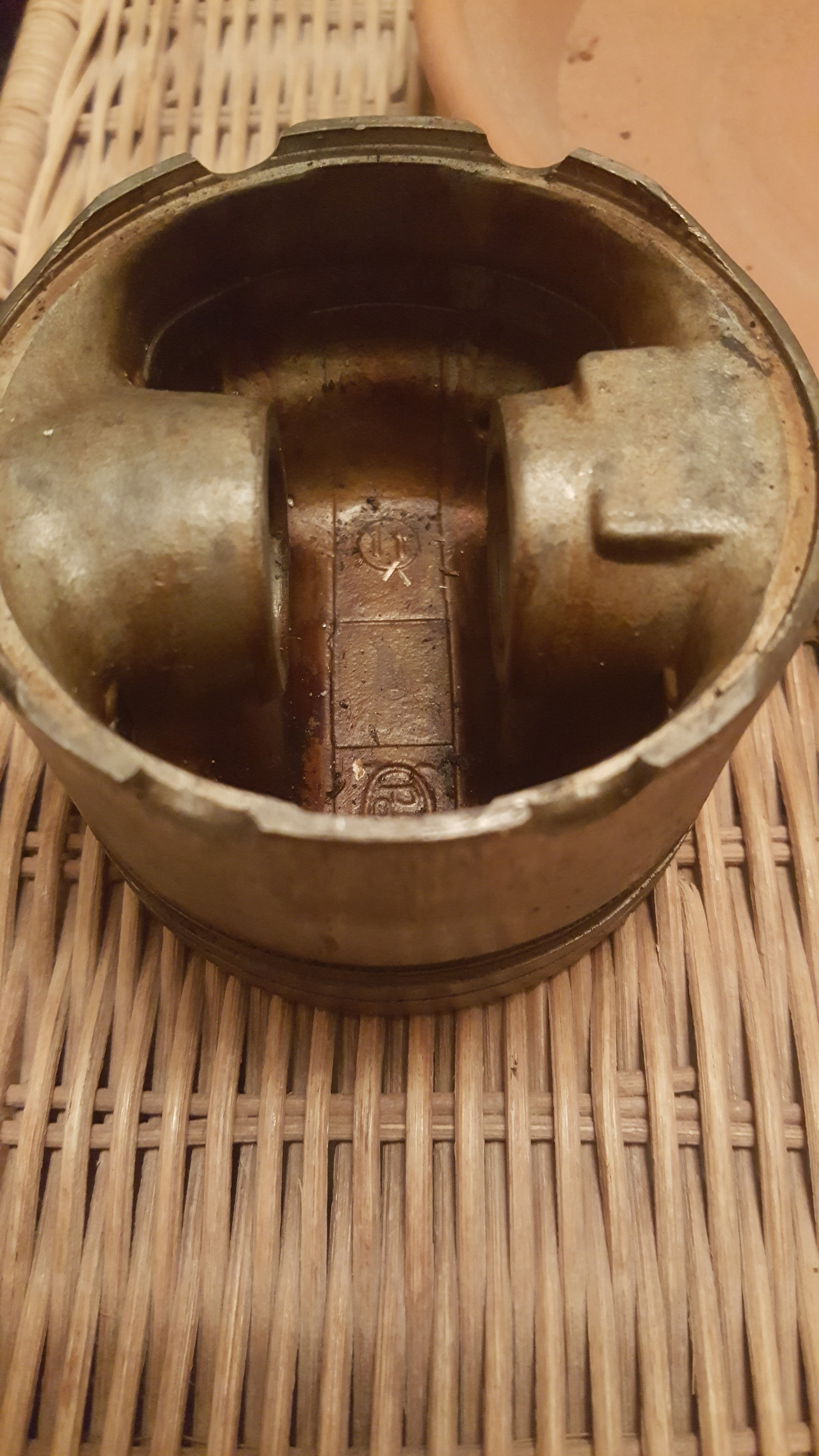

I'll try to add some pics using my phone, which should show an 'X' on the piston crown (to prove they're DFW). You'll then see the thickness of the little end of the rod is much thicker than the space available in the piston.
If these were D6C/standard Mi pistons, (a) they'd have a 'Z' stamped on the crown, and (b) would fit the little end.
I'm hoping the answer is 'yes, DFW has different rods'. Then I need to know if I need to have the DFW pistons machined to fit the rod or vice versa or a mix of both?153525454912211697051.thumb.jpg.75f24c62bfc243bd8dba91f8976f1807.jpg15352546378591168666589.thumb.jpg.6e4410c3b170375f7c93726a56a1e5b2.jpg
Something odd there. The only difference between an X and a Z piston is the compression height. The rods and pins are identical. It must be manufacturing tolerances. What are your measurements for the rods and pistons and I'll compare them to other X & Z pistons and rods I have here.

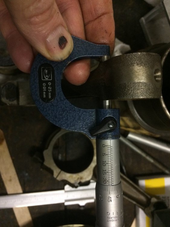

Mi rod little end about 3-4mm thicker overall.
poI0BAMyj
XU7JP4 piston still with rod fitted compared to Mi rod.
poY8D39Rj
Both pistons compared.
pnCXnhDwj
To my eye, the XU7JP4 and Mi rods are very similar, at least in terms of little end thickness, which means the difference is in the piston as stated; it might be just 2mm narrower, but 3-4mm overall extra width seems to be needed.
The only thing I can think of is that I've fished out 8v rods. But if 8v rods are the same as Mi rods, and also very similar to XU7JP4 rods, then it's definitely the pistons that are different.

I just pulled apart two virgin X and Z piston/rod assemblies. This is the best I could measure given my arm is in a sling.
Z piston internal: 22.62mm
X piston internal: 22.62mm
Z rod external: 22.42mm (at its widest)
X rod external 22.47mm
For the Z rod, I say at its widest because it's actually tapered, down to 22.35mm. ie it was never ground flat. I'm measuring just under bush, rather than at the very top. The X rod is flat.
Disregarding the poor machining of the Z rod, both rods fit easily in either piston.
8V rods are thicker at 24.70mm.
Edited by petert

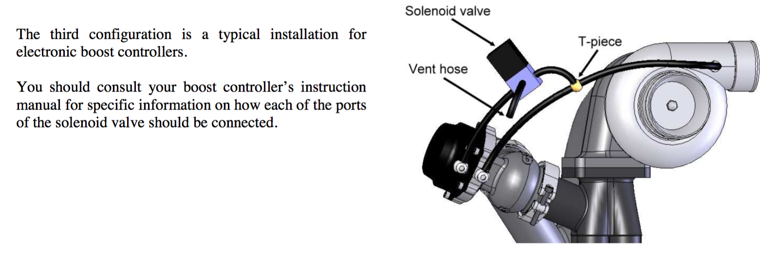

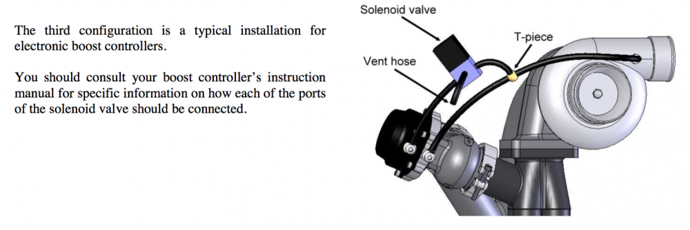

This advice reminds me I need a boost controller, but would someone please explain?
I'm not sure how well you can do closed loop boost control with your current waste gate arrangement. I thought you'd need a wastegate with two ports and a solenoid (which your ECU controls) as per the pic to get full control. Here's a video which explains the benefits:
