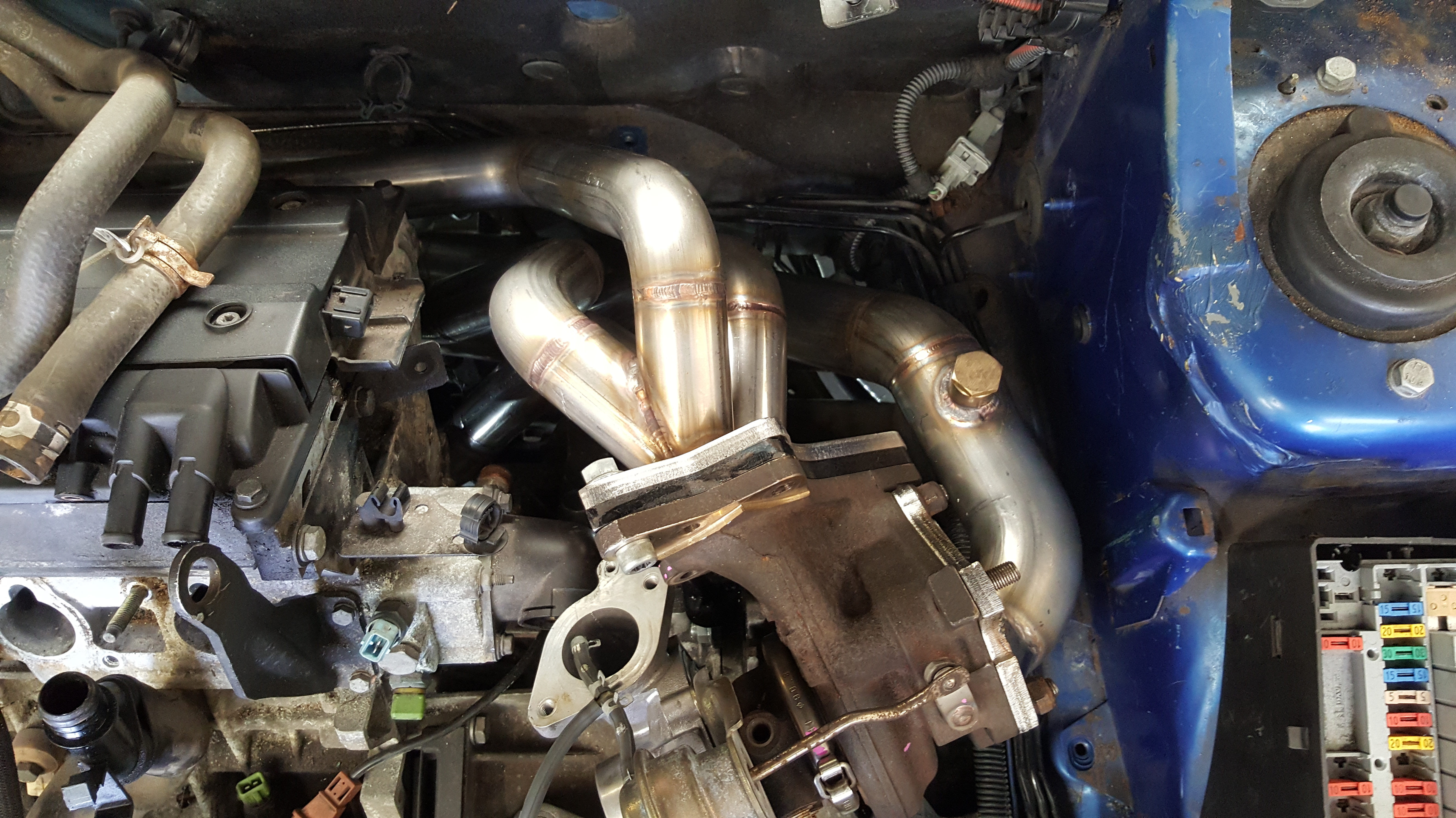

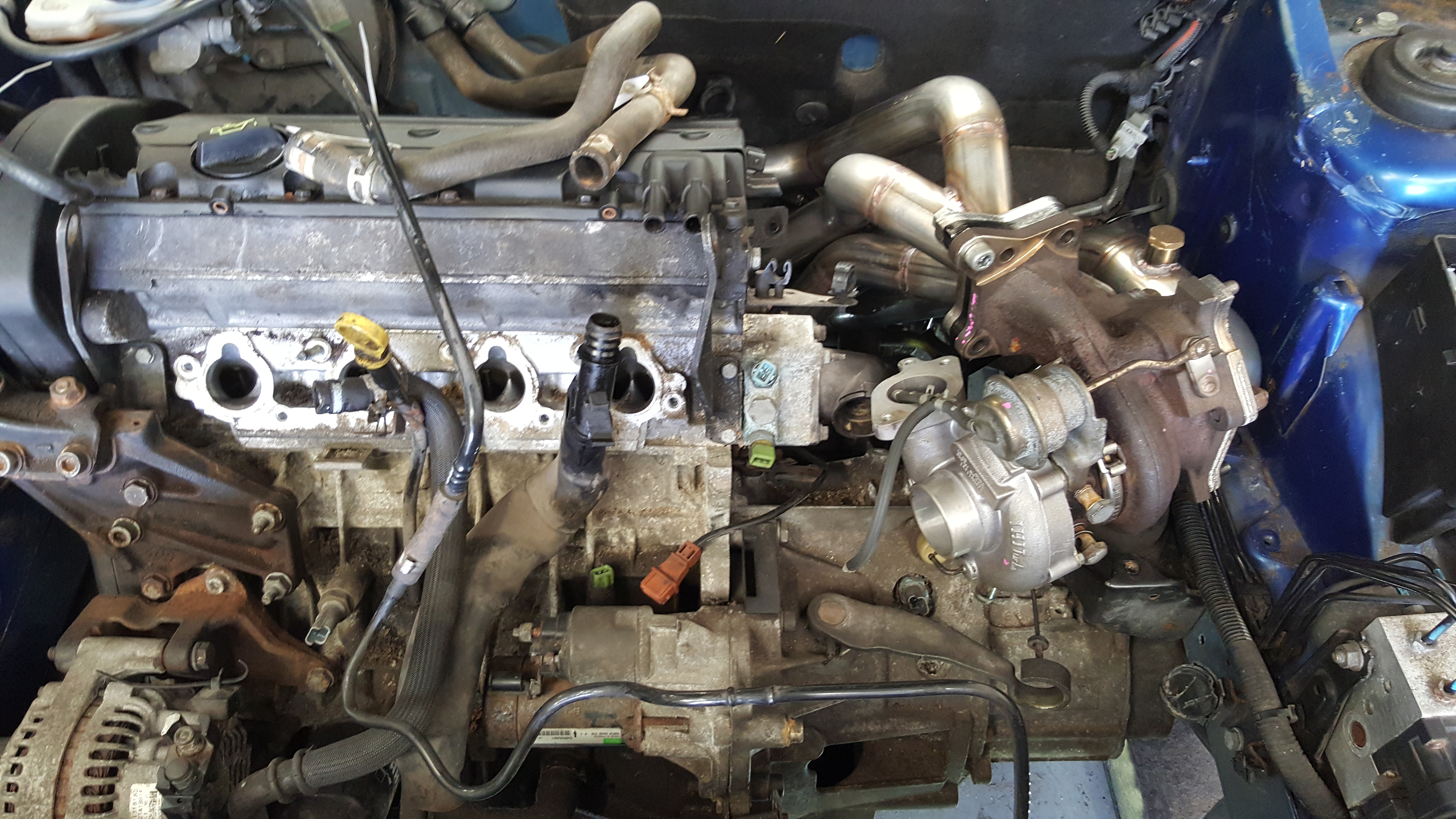

Xsara comes back to me next weekend. Mike's work is done. More pics with the old engine out soon.
4 matched exhaust runners in pairs (1+4 / 2+3) to feed the twin-scroll, which has a mounting bracket off the gearbox between the turbo and downpipe. Turbo 'clocked' so oil drain is at bottom and to aid plumbing. Lambda boss pictured with a bung on downpipe which currently ends just short of the car's underside, so rest of system (to follow in 6-8 weeks) will start there with a flange and flexi.

allanallen
Very nice. What’s the spacer between the manifold and turbo for?
the the support bracket.
allanallen
What’s the reason for doing it like that rather than directly to the manifold?
DrSarty
Quite a lot of weight for the runners to support.
It also means the turbo, downpipe or manifold can be removed independently. Everything stays where it is.
Plus it all moves together, which overall means it should last longer.
Apology: Support bracket - the black bit - is between the turbo & manifold. (Not the downpipe)
