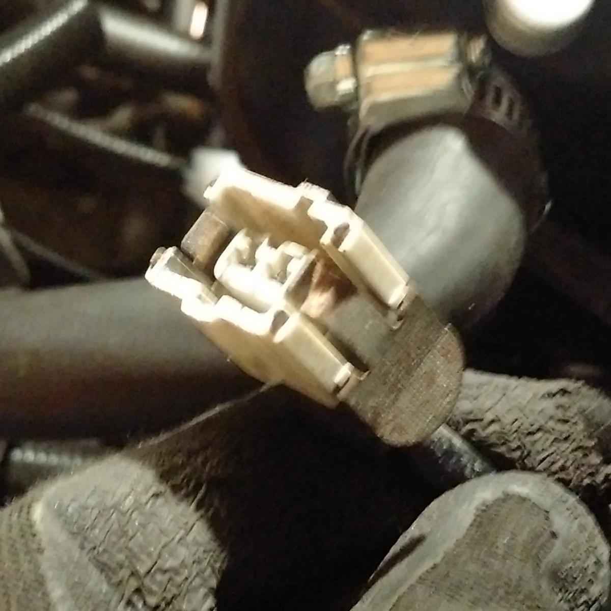

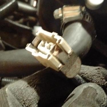

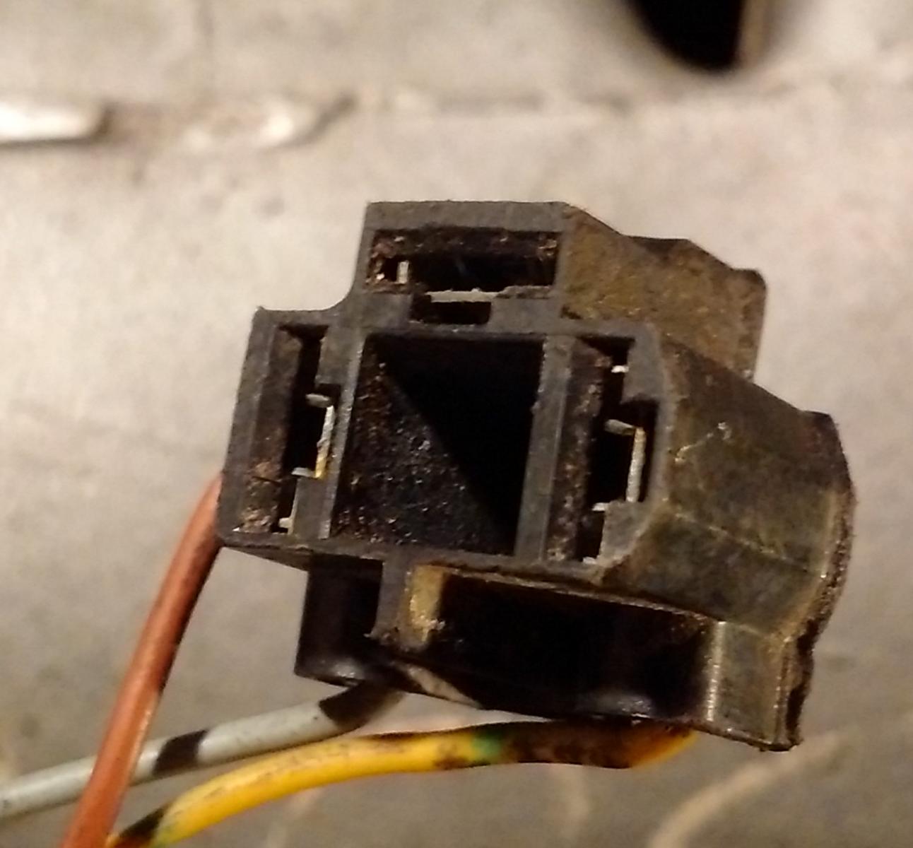

soundguy 13 Posted December 6, 2016 Hi, can anyone ID any of these loom connectors please? Do the yellow multis need to connect to the each other, because I've binned the junction that I think they were attached to - ie, the same junction that's inside the rear bodywork area where the passenger light cluster mounts. Share this post Link to post Share on other sites
farmer 328 1 Cars Posted December 6, 2016 Left one looks like the headlight bulb connector Share this post Link to post Share on other sites

farmer 328 1 Cars Posted December 6, 2016 Black connector. Share this post Link to post Share on other sites
soundguy 13 Posted December 6, 2016 Thanks, trying to upload from a phone, will have to do this from a puter. Does the black connect to the back of the bulb mount with the spring clip? Share this post Link to post Share on other sites
farmer 328 1 Cars Posted December 6, 2016 Straight plug into the headlight bulb yes Share this post Link to post Share on other sites
Anthony 1,003 Posted December 6, 2016 Hi, can anyone ID any of these loom connectors please? Black one is the main H4 headlight bulb, so yes, the one with the spring clip. The white one looks like it's the one for the ABS, assuming that it's a Ph2 car and located near the expansion tank. If so it's typically disconnected (unless you have the optional ABS fitted, of course). Do the yellow multis need to connect to the each other, because I've binned the junction that I think they were attached to - ie, the same junction that's inside the rear bodywork area where the passenger light cluster mounts. The yellow multiplugs you mention sound like earth plugs - if so, you need to have them attached to the earth point (the bit it sounds like you binned!) Share this post Link to post Share on other sites
