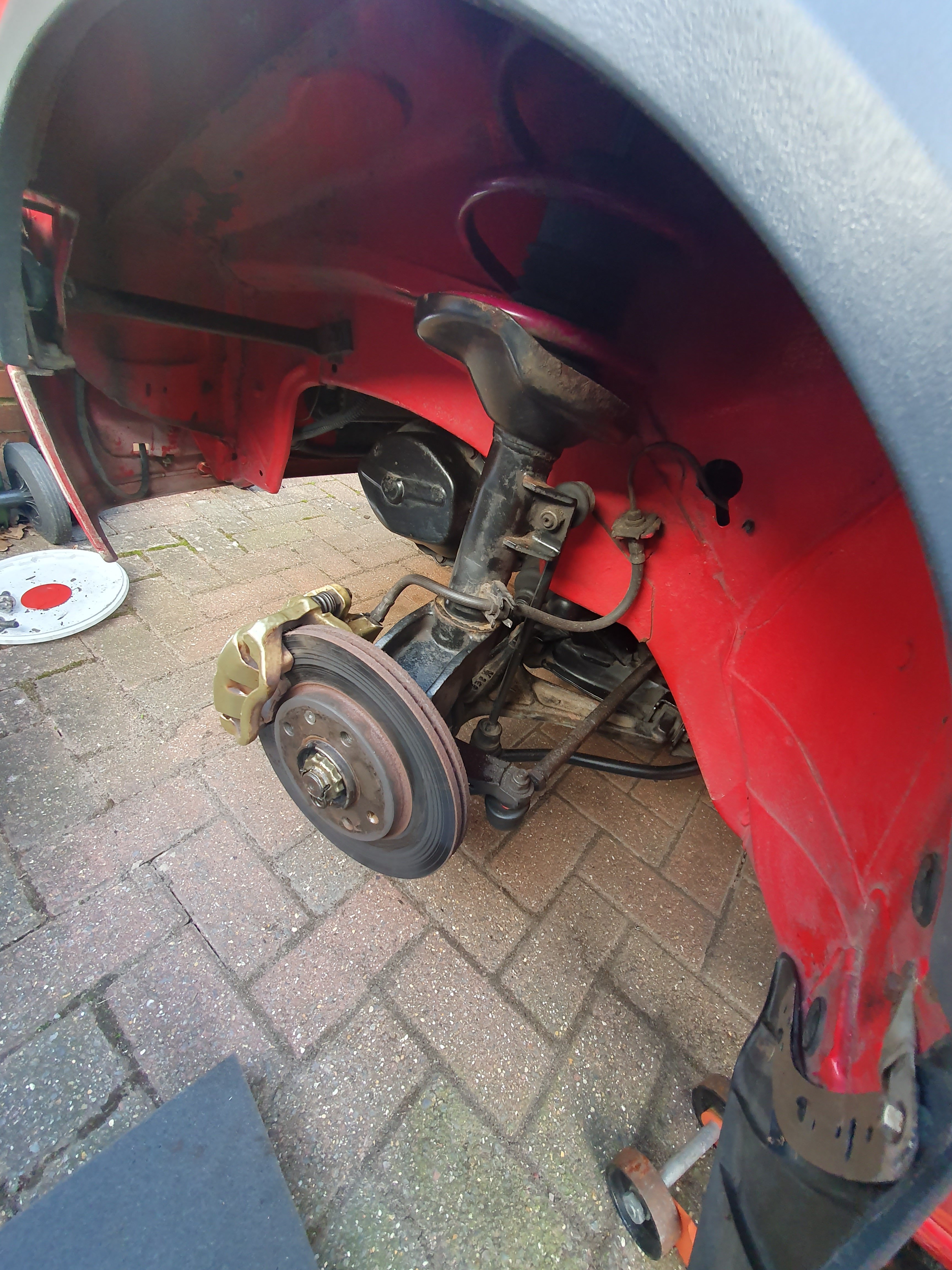

Yep. I did a bit today. An oil and filter change.. it's only done 3000 miles since the last one but that was a year ago.
Also managed to find time to inspect the front wheels, brakes, and associated suspension. All looks good , showing its age after what 5 years since I built it.

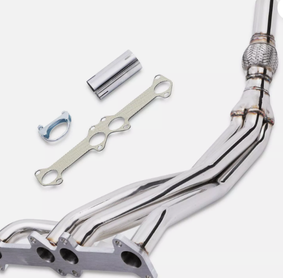

SRDT
Don't use the manifold gasket on this picture, manifolds of this kind are usually fine but the gaskests are just crap.
You'll need a firm lower engine mount too.

Telf
i was planning on using the standard gaskets I'd normally use?

SRDT
I have no experience with 8v gaskets. It looks like the XU10J2TE one with integrated heat shield could fit but I don't know if it's necessary.
What I have seen up close is this kind of gasket simply cut from a sheet with no crimped metal rings, there is one thrown into the box when you buy a 309 GTI16 stock-like manifold. I didn't use it but someone else got 110 miles out of his before it started to leak.

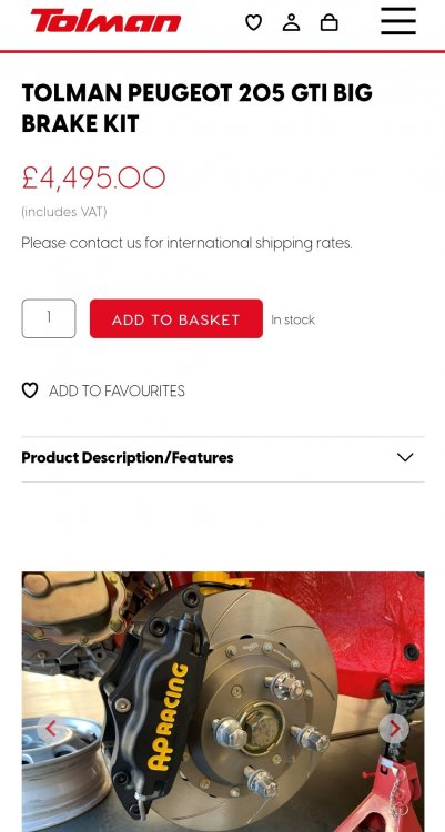

On 12/8/2019 at 10:56 PM, Telf said:
Is this for real? £4.5k for a brake kit. Can someone explain this to me please?
Leslie green
Paul it's 1500 for a single wheel of them  the prices are next level !
All approximate, calipers £1500 the pair, discs £500 pair, bells £300 pair, pads £200, hoses £100, OK still a good mark up, but we are not talking about a set of corroded 25 year old Brembos off a 406 here. I've got a set of 4 pot AP racing calipers with 295mm discs under the standard 1900 wheel, they are fantastic.
  • Thanks 1
i'll show that to Godspeed, they do an AP kit for £1750!
barneys66
Wishbones too by the look of it:
To facilitate the fitment of the kit, it includes our proprietary adjustable lower wishbone with spherical bearing and poly bushes.

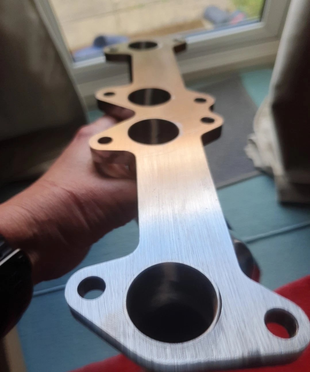

Well the manifold arrived, it seems to have an imperfection, think I may send it back!
Not really, it will only be welded on the outside of the flange.
  • Thanks 1
I dont see any issue in the photo?
  • Thanks 1
Telf
Alright thanks, I was hoping some of you would respond and say its OK. Thanks.

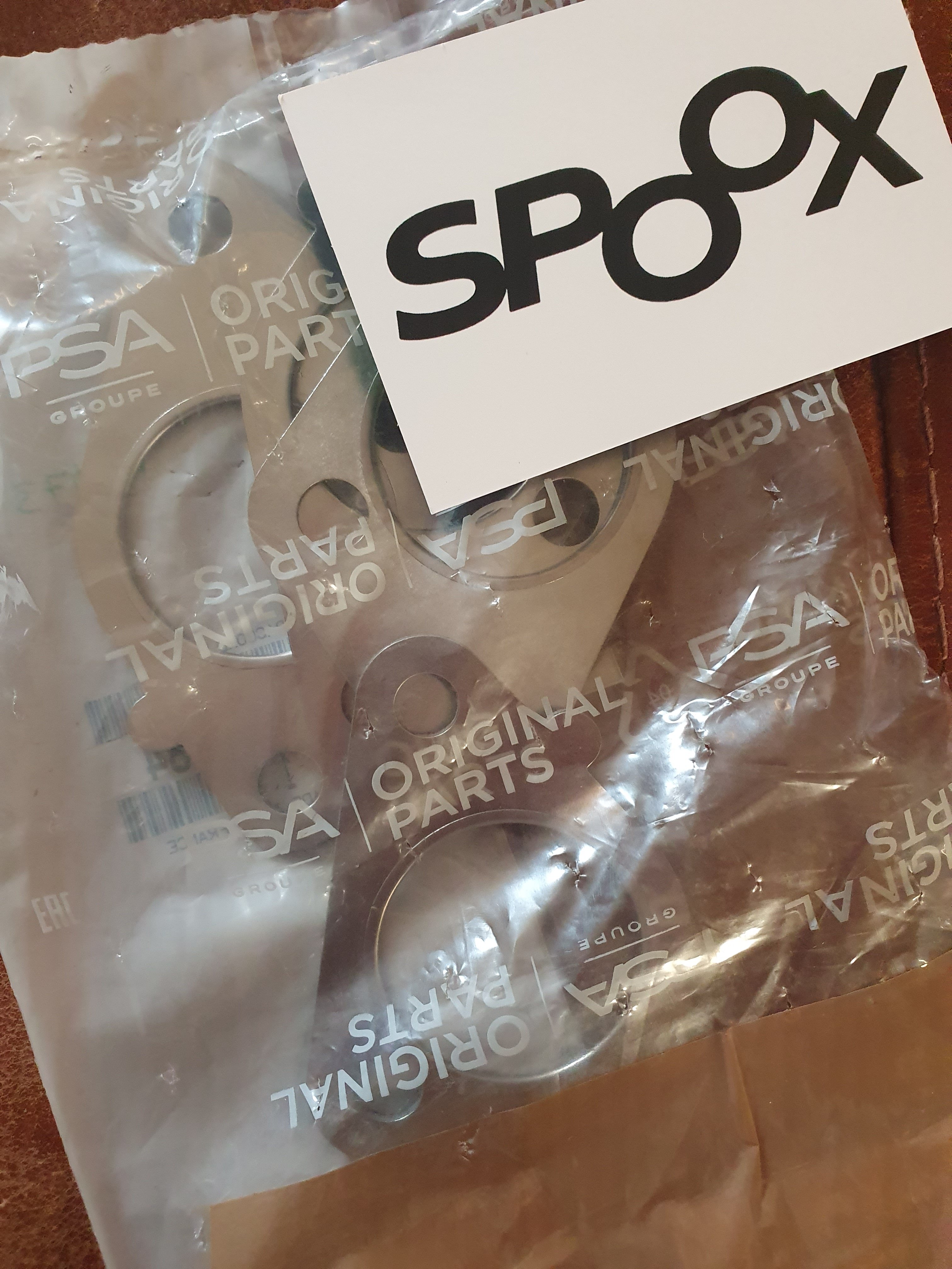

Telf
Collecting the parts to change the manifold continues,  £38 from Spoox for some genuine manifold gaskets. This has to be the most I've  ever paid for them.
