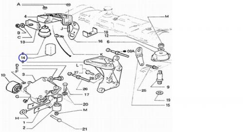

Hi,
i looked on the peugeot engine mount diagram and saw that threre is some king of engine buffer (part number 1844 18) on the right hand side engine mount.
this buffer is missing on my car and i haven't saw it on any other GTI online either.
do i need it OR it only on specific models?
i have 205 gti 1.6 (1992)
my vin number is VF320CB6224949982
chassis number OVF320CB62249499820
Ido
idoari
I just want to know it this buffer was on my car when it was new or it's for a different model.
Anyone??
no idea what that is, its not a part I recognize from any XU 205.
looks like a spurious listing, its also listed for the XU9J4 where they have a brace over the top of the engine mount arm with a rubber block sat in the top to prevent upwards movement, the 205 never had this brace
