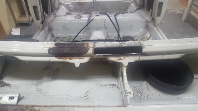

Another area of concern be came apparent when I took the scuttle panel and windscreen out. Rust at the bottom of the windscreen aperture right in the centre, must have been gathering water here for years. Again dont know if anyone has dealt with this could give me some advice -

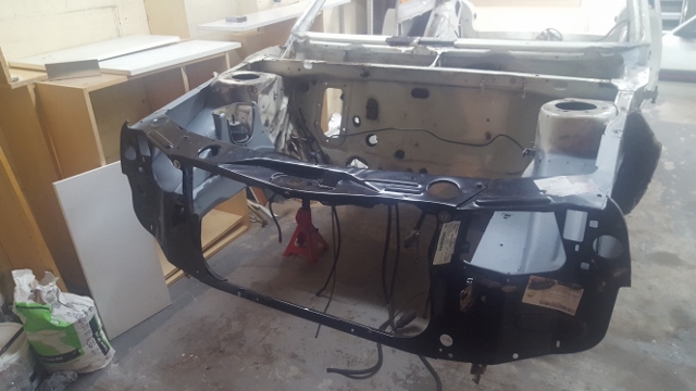

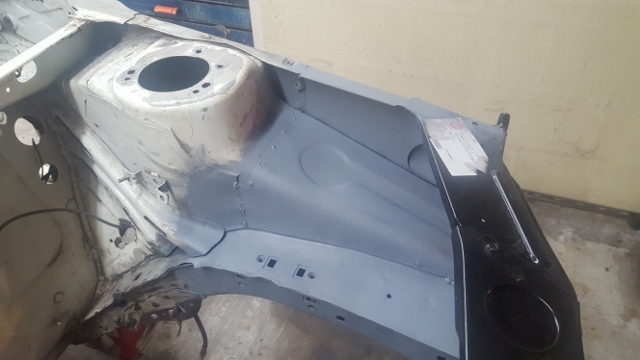

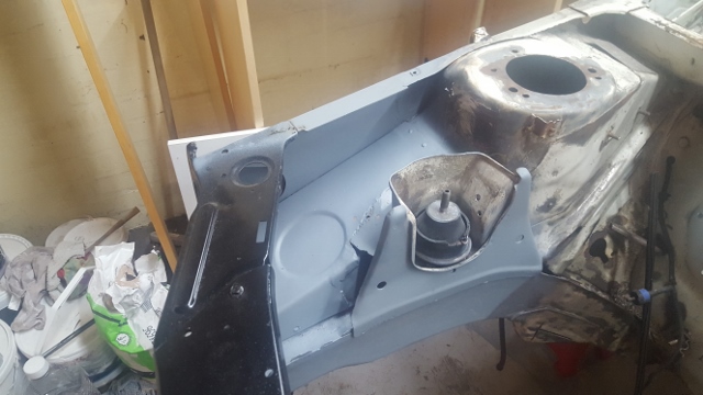

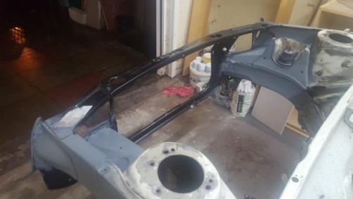

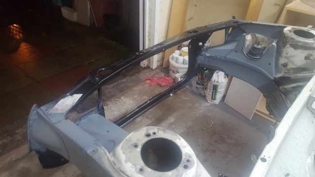

Front panel and inner wings were nakered so cut the old ones out and welded some new repair panels in, a lot of time measuring and "adjusting" to make sure the front end was nice and square. Then just put some rust prevention/primer on them to protect them until its painted. Pictures below -
Also has anyone ever patched up the lower windscreen surround, looks like it has had some water collect there at some point and it has rusted back. i have tried to make a patch for it but not had much luck due to the sweep and tight radius's. could ideally do with another donor body to cut the section out of.
