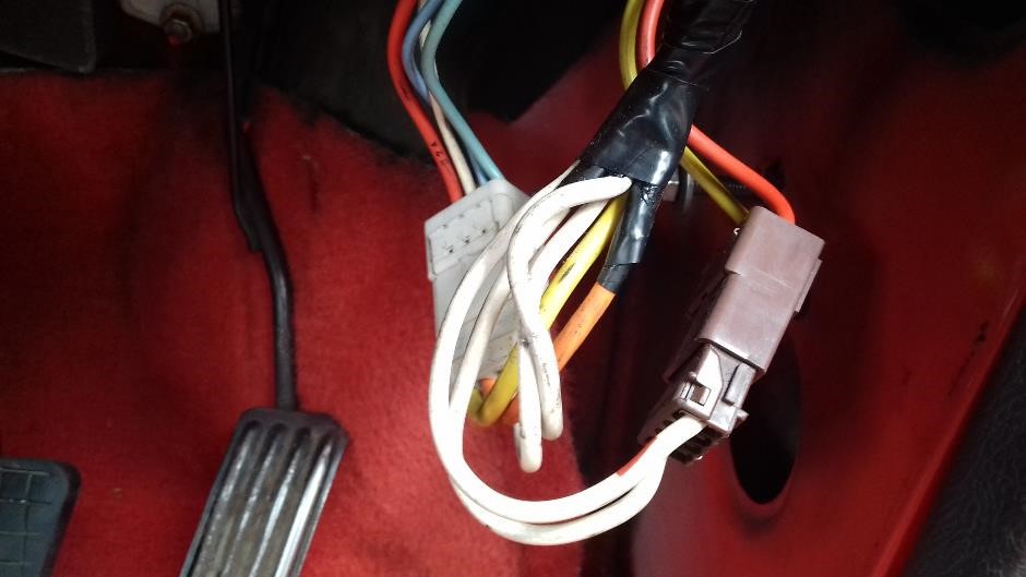

It sounds like a bad connection either in the ignition switch or wiring.Try un-plugging and re-plugging the smaller brown connector under the steering column just to the side of the heater.It starts when jump leads are connected to a running car as this bumps the voltage to 14.4volts which overcomes the resistance.You could also try disconnecting the smaller of the two plugs and connect a good 12volt supply to the thick blue wire which should make the starter turn.

I also split the brown multi plug as I believe the solenoid wire passes through there. The contacts all looked good but I cleaned them anyway. Will look again tomorrow, thanks all.

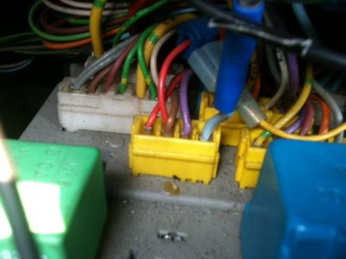

Starter solenoid wire connection in fuse box area

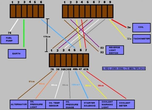

and here is the pin out for the brown plugs (as linked)
Solenoid wire under dashboard is on the brown connectors as follows:
here is the wiring details for the 205 two brown plugs under steering column (as shown earlier),this is how they were on mine:
9 Pin plug
52 Reverse light (dark grey)
53 Reverse light (purple)
47 Coolant light (yellow)
47a coolant gauge (red)
7a Alternator light (dark grey)
30 oil pressure light (purple)
30a oil temp gauge (white)
30b oil pressure gauge (grey)
32a tachy relay (yellow)
6 pin plug
76 fuel pump (white)
M ignition amp (green/yellow) (Permenant earth)
112B tacho feed (grey)
112c not connected ( green)
2a switched live (red)
46b starter (blue)
with a diagram:
