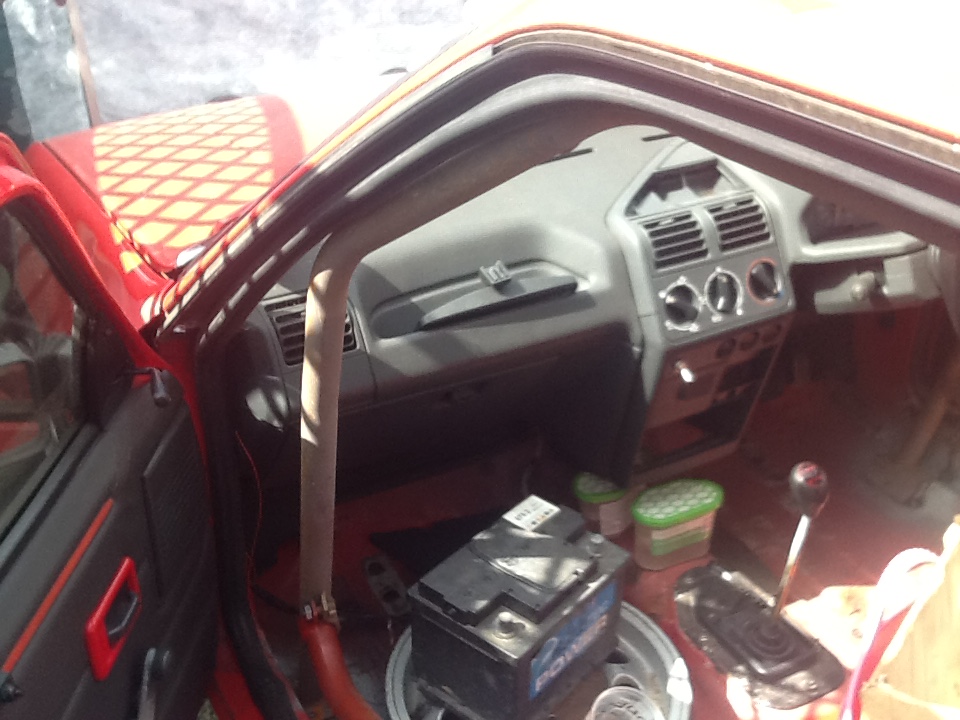

I've got the above cage I'm trying to fit into my xs road rally car having a slight issue with figment and can't figure what's the best thing to do.
Rear half is bolted in place quite well.
Problem is the front legs. Passenger side sits nice and tight in line with the A pillar but the drives side is lower and intrudes into the door aperture more than the passenger side. It looks like it needs the foot plate to be boxed in a few mm to get it to align as nice as the the other one.
My question I guess is, can I do that? Will both legs need to be done the same which makes one look great and one not? Or it's an old car most likely be because it's twisted somewhere and just get it to fit as best as I can using any method?

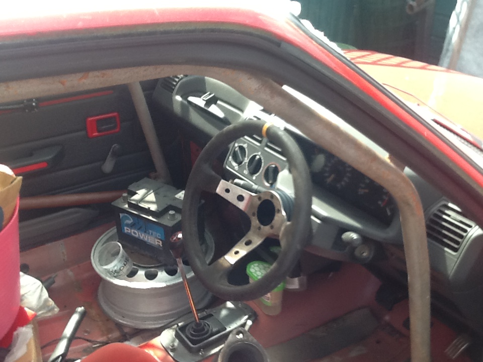

Here we go guys some photos to explain the difference with the front cage legs.
Worth worrying about trying to sort or just carry on as it is?
Simmo
Prob won't get it much better than that! Looks similar to mine tbh
