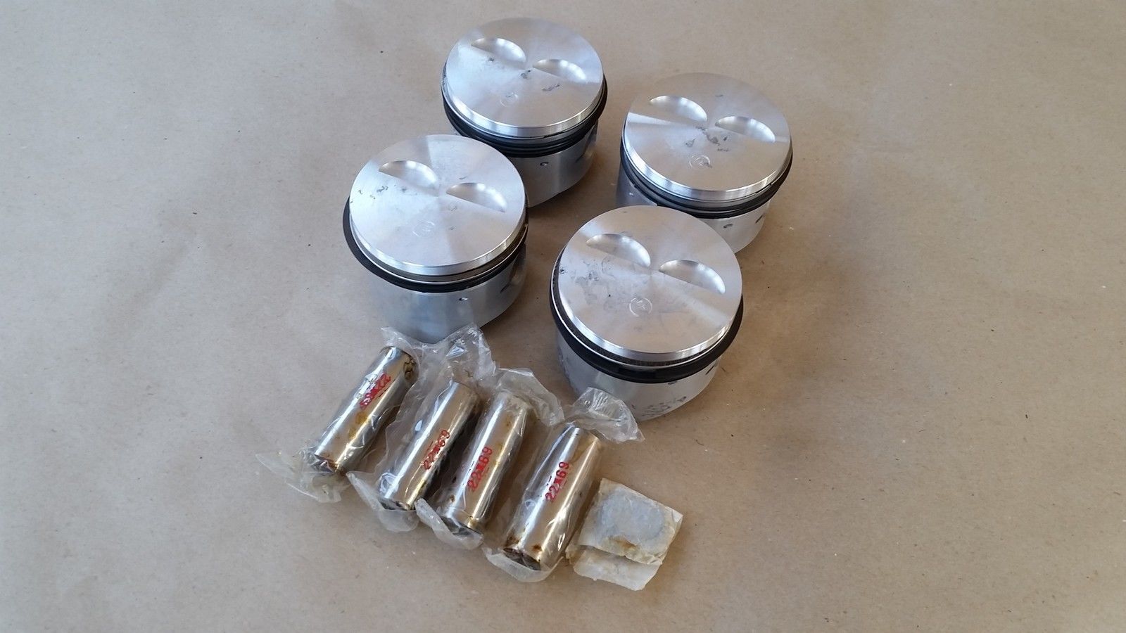

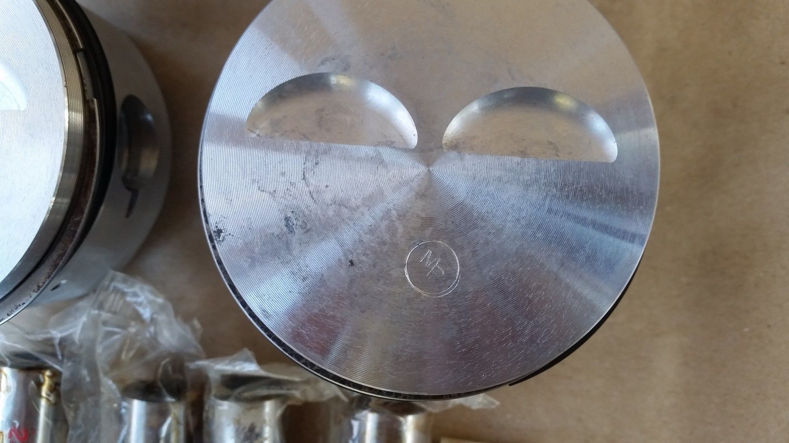

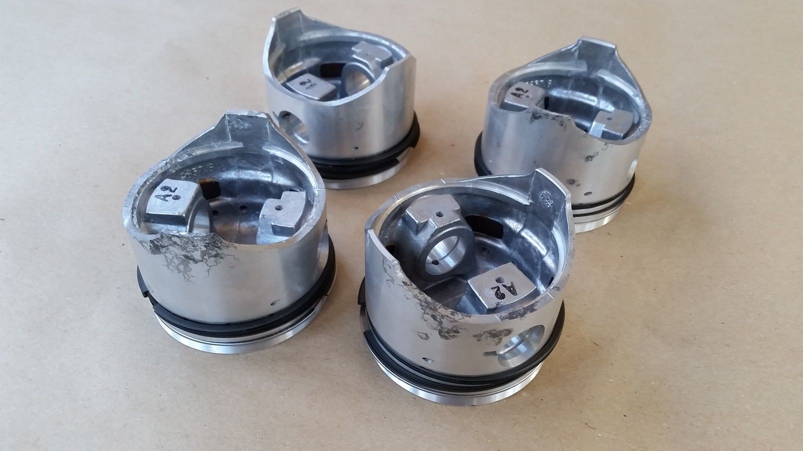

Hi, im gonna build a xu10 8v with a diesel crank and i would like to change the std pistons in order to raise the compression and i would like to know if these pistons are duable, going to show some pics of it:
xu10 8v pistons spec:
Standard Size [sTD]:
Top Land Height [mm]:8,5
Recess Depth 1 [mm]:5,02
Bolt length [mm]:62
Compression Height [mm]:40
Production Number:86 V 131
Component Number:1. R 1.5
Bolt Ø [mm]:22
Machined:with cut-out for oil jet
Cylinder Bore [mm]:86
Length [mm]:65
007.jpg​‹
The spec of the ones i would like to use:
Valve Pocket Depth 1 [mm]:2,6
Bolt length [mm]:69
Compression Height [mm]:34,7
Production Number:86 V 32
Component Number:1. R 1.5 CrP
Bolt Ø [mm]:22
Cylinder Bore [mm]:87
Length [mm]:77,3
Are they duable or not?!??!
205freak
The cylinder bore on these pistons are 86mm instead of the 87mm as shown! Will they be sitting below deck since they have a smaller compression height than the std ones??!!
Any thoughs would be helpfull!!!
