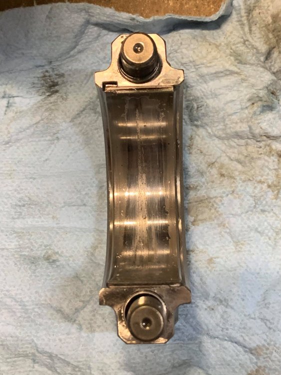

A sad day though. The pressure hose from the dry sump pump blew on lap 1. Eight litres of oil on the track. End of the day. Hopefully engine protection in the ECU kicked in fast enough. I haven't looked at the bearings as yet.
That is a disappointment . The late great Guy Croft had a view on oil lines. If they were not high pressure lines with swaged fittings they were not going anywhere near any engine with his name on it . No help now though. Let’s hope that the engine did indeed shut down whilst still having oil in its bearings .
Good advice, as always.

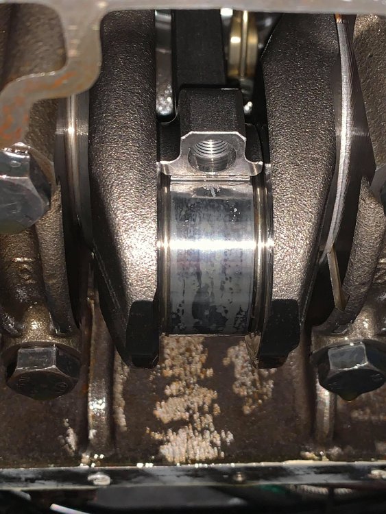

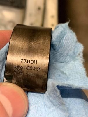

We dodged a bullet today. Looking at the logs, the engine shut down as intended. It was doing 5200 at the time of failure. The rod bearings just started to flake, no damage to the crank.
It was an ACL Race Series bearing, 4B7700H. Hopefully we can get some more.

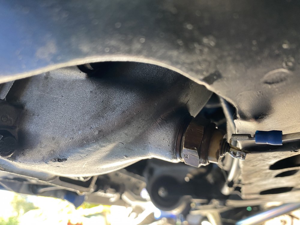

Look what fits in this hole! I’m keen to map gearbox temperatures. I found a stripped sensor, mapped it on the stove with some cooking oil and used a spare channel on the ecu to datalog it. With a thick copper washer, it only just clears the crownwheel. Next race on 10 July will be very interesting. The plan is to start with 75W-90 and then swap to 75W-140.

Nice innovation. Have you had any trouble with gearbox of diff reliability or is this more of the curiosity thing?
speaksgeek
Very cool. I'm going to have a look at my drain plug setup now - I think maybe it doesn't have that boss to make clearance.
Super interested in the results.
I wanted to get a base line before I turn up the hp. Then decide if cooling is viable.

It would be easy to make you a new plug from some hex to suit one of these ebay sensors.

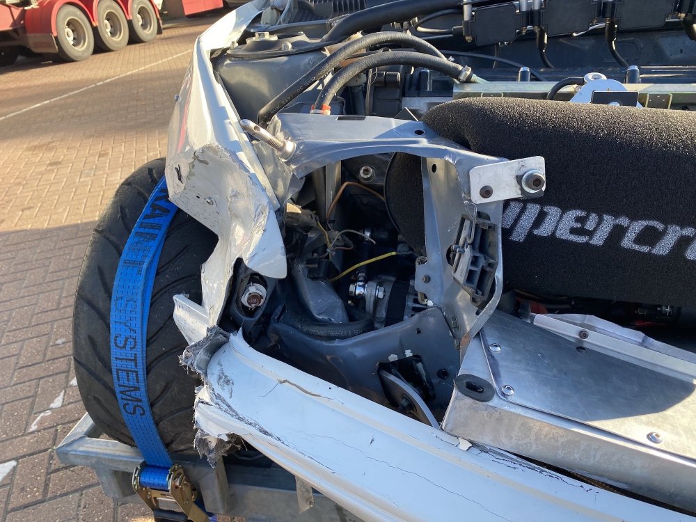

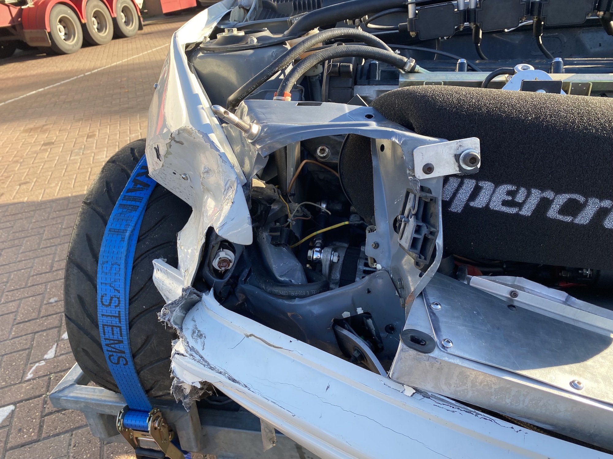

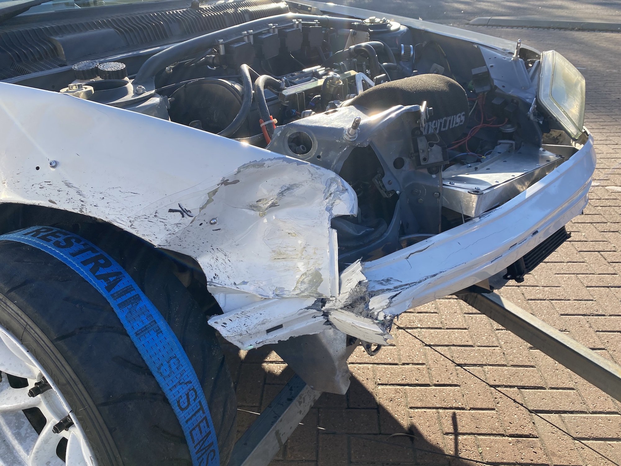

Our poor 205 took a massive hit in Race 1 on Saturday. The both rails are in the wrong place and just about everything is broken, other than the engine and gearbox. As you can see, there's lots of special bits in there. I think even the RH hub/upright is bent. It's a very rare Group A item.  Oh well. We'll pull it all apart and repair regardless.
  • Sad 4
Andy
Oh dear Peter. That was a proper accident . Looks like it will take more than 5 minutes and a bit of sticky tape to fix as well. Ouch . Wallet damaging .

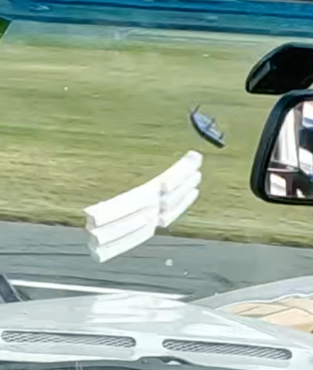

This still from the video footage of the crash is GOLD!
