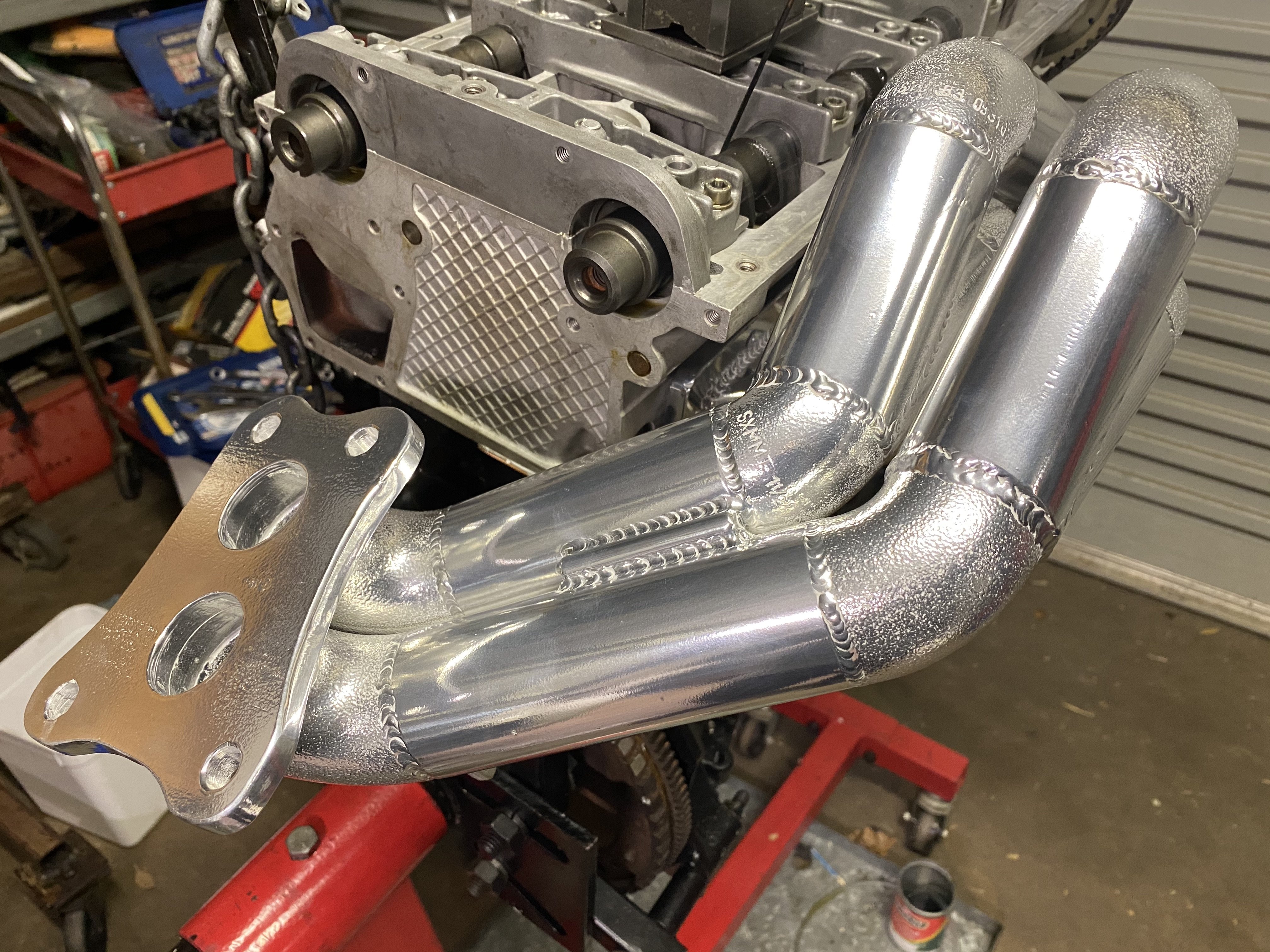

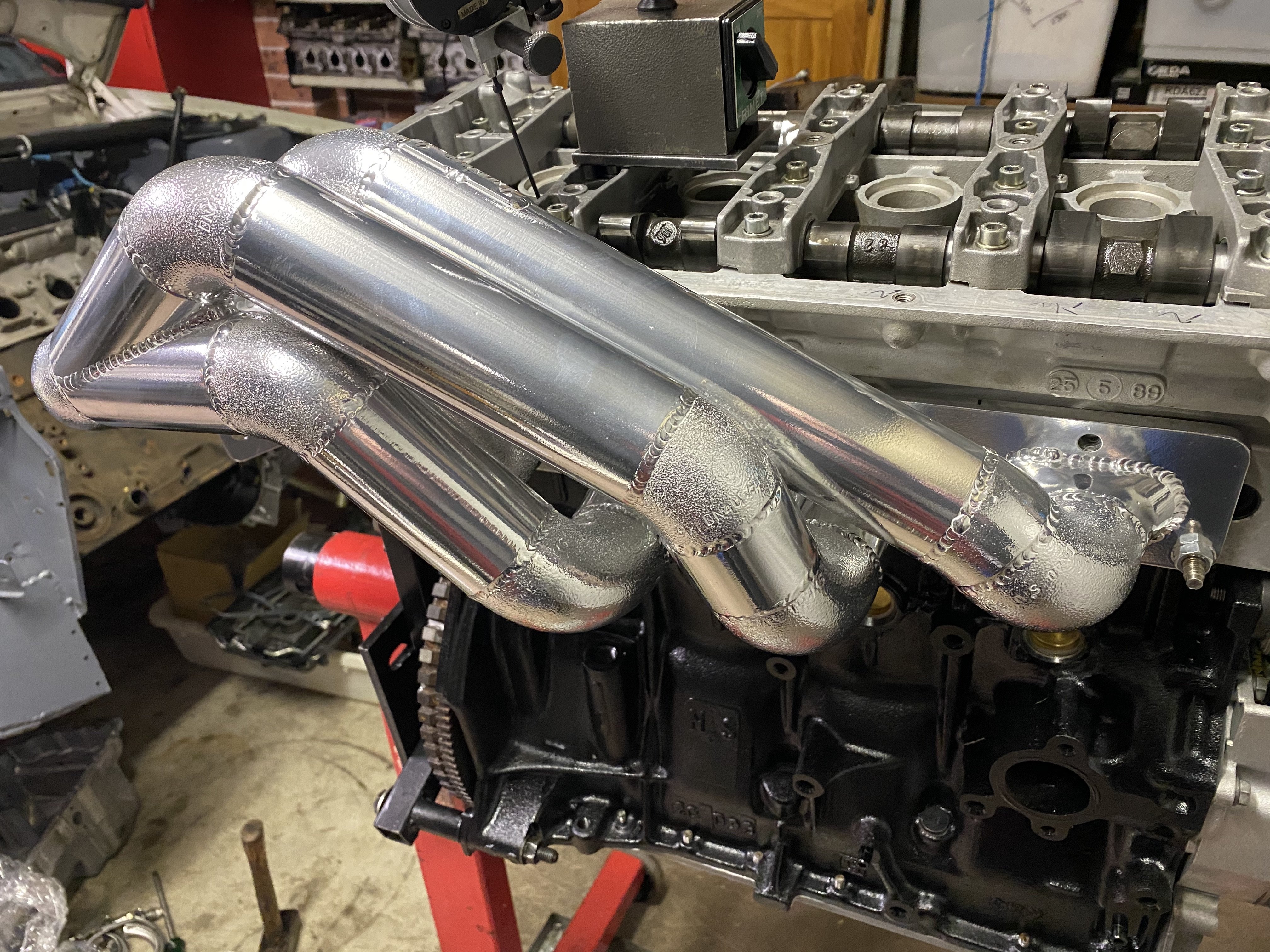

I've had the 205 at a local fabricator, having a turbo manifold and downpipe built. Normally work I like to do myself, however for the money it's just not worth my while. I'm really pleased with his efforts. It's twin scroll, if you can manage to trace the paths. Next task is to pull it all apart and get the pipes ceramic coated. And of course save up for a new gearbox and stronger driveshafts.
Looks really nice Peter!     And so much room in a RHD.... just unfair....
Wrt to the interconnect between the runners; don't you think it will create extra stress in the manifold when it heats up?? Or will it just make it more rigid?

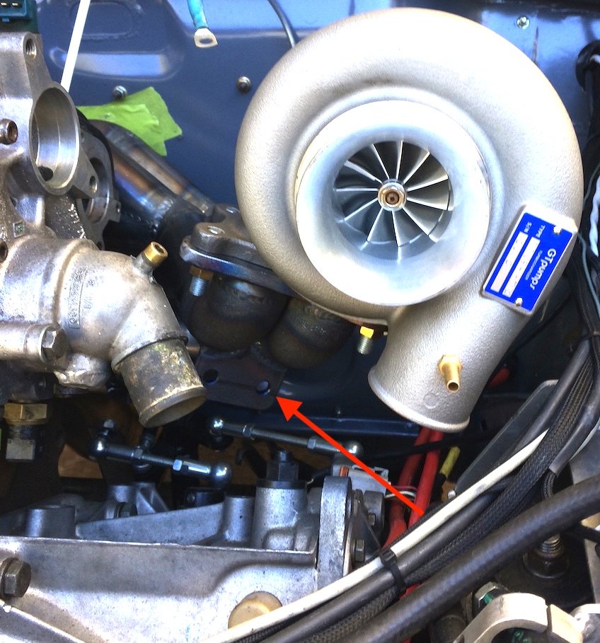

It will all be stiff/rigid. In this pic you can see a tag with two holes, under the manifold. I need to make something to tie that down to the PAS pump holes on the gearbox.
Peter I'm sure you know this but don't constrain it as that will ask for issues. Some sort of support rods using rose joints perhaps to take the weight off the manifold a bit but allow it to move is what I'd look to do.

16 hours ago, jackherer said:
There are pros and cons, have you seen our throttle, clutch and speedo cables? :lol:
The speedo cable would go inbetween both runner on a LHD and the brake cylinder would sit in the turbine housing of the turbo.....
But indeed different challenges.....
Wrt to the support of the manifold, I tend to agree with Tom; the manifold will expand more than you engine, so turbo would move left and right as result of EGT. But you don't want vertical resonance.
For sure, I was told to elongate the holes but I'll confer with my turbo expert friend.
wicked
Please share his expert view with us, as I can only reason from theory and have also an ongoing build with similar construction.
A rose jointed turnbuckle it is.

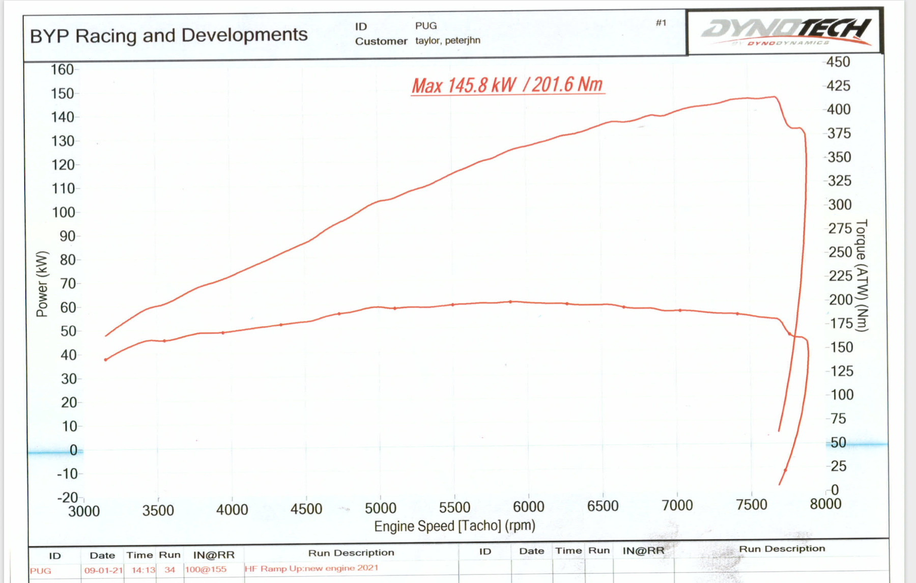

We finally got the NA engine back together and on the dyno. It's been a long road, after spinning a bearing and bending two valves pre-covid. This will be ample for Under 2L racing this year, whilst we work on the turbo build. The RPM on the chart is not accurate, as the rev limiter cut started at 7900
Edited by petert
Andy
Morning. Bet you are pleased with those figures. The torque looks beautifully flat just about up to the Rev limit and the power hangs on even better . Excellent work Peter, and the rest of us need to remember that this data is at the wheels. This is some engine you have built. Top work.

That is a very nice Graph Peter! So this now has the Argo's in it and the fancy head with the shimless buckets?
Can't wait to see some vids of it on the track this year!
Argo rods yes. Shimless no. The cams I had planned resulted in insufficient valve-valve clearance. Additionally, the huge inlet cam was hammering the buckets into the valve tips, ie the valve springs weren't good enough. So I went back to a combination of cams and springs I knew would work.

That torque curve :wub:
emi16v
It is the big valve head this time though? Good to see that plan B still makes very healthy power!
With any luck it’s the picture of reliability too so you can get on with the turbo build, which I’m sure everyone is watching with interest :)
Yes, it has 36.5/30mm valves. A mistake in retrospect, as being that big limits camshaft choice. Just too greedy! A better combination would be 35.5/30.
