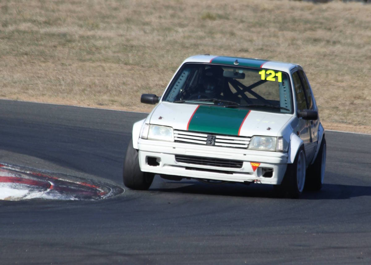

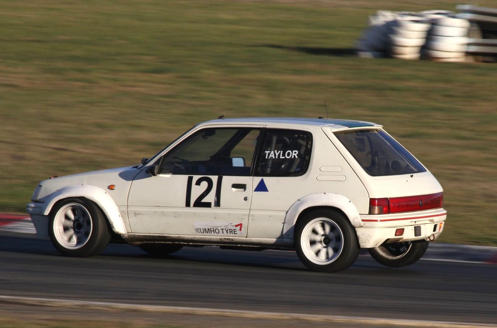

A great pic from the weekend. Front fully loaded on 500lb springs, rear wheel in the air as usual, on a high speed sweeper.
Increasing rear springs to 650lb made a significant difference. Thus increasing the front to 650lb to square it back up.
camgti
Nice one Pete. Are you seeing improved lap time from the changes or ease of consistent lap time?
Indeed both!
Andy
I will display my ignorance here by assuming that with the spring rates you are using, there is almost no suspension movement at all, which is presumably you are trying to achieve to enable the road/tyre contact to remain uniform as the chassis changes direction?
At the g's we pull there's still a lot of suspension movement, even with 500 front / 650 rear combination. Way too much body roll. Look at the pic in #80. So yes, trying to keep contact uniform.
Andy
Yes. See what you mean. The centripetal loads must be pretty high!!!

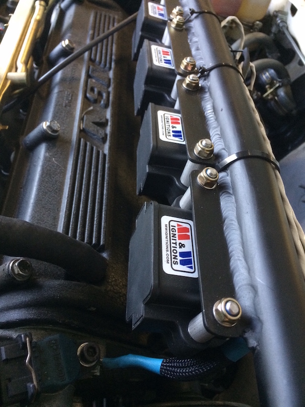

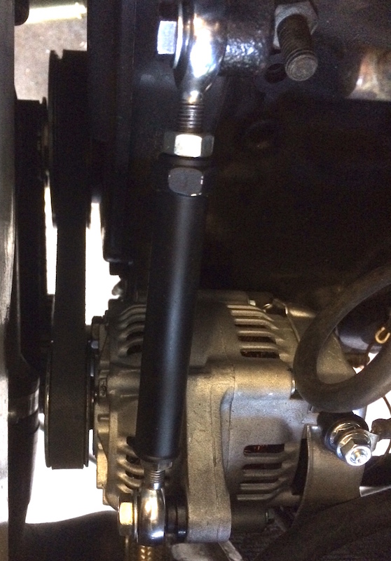

I've been fighting a niggling miss above 6500 all year. It's finally got to me. I've replaced plugs, coils, leads, ignition harness and had the CDI overhauled. I've also replaced the alternator with a new 35A item. Hopefully that's every possibility and it will perform flawlessly in the race on Sunday.
