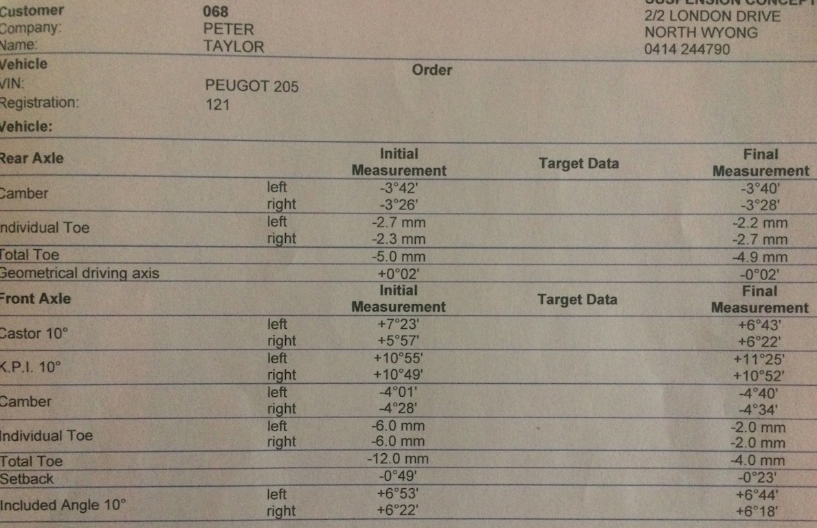

Wheel alignment, balance and new AO50's this week as well. All set now for the upcoming race season.

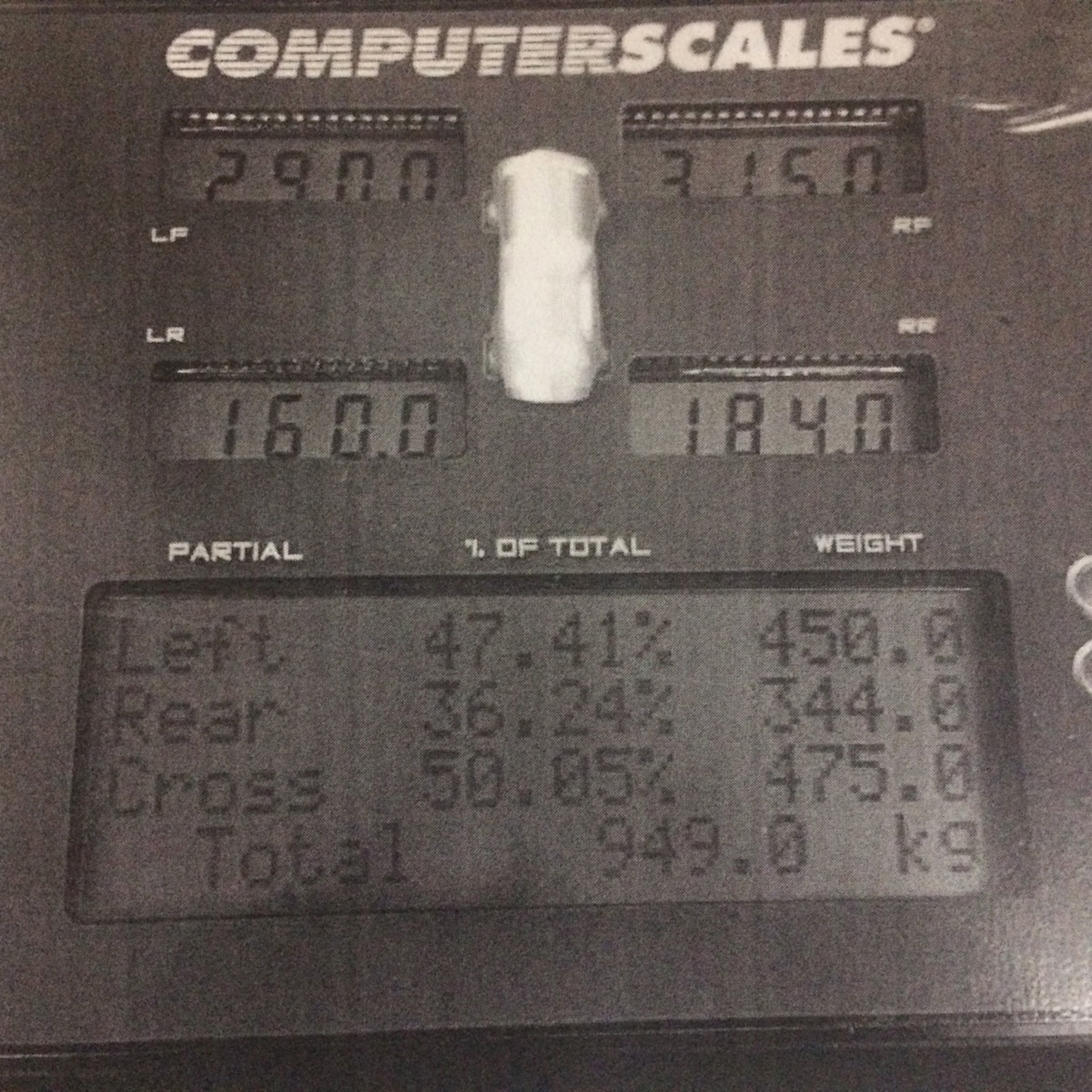

Why is the car so heavy ? Regulations? My 205 has Race ready 750kg.
That includes driver. Car still has original doors & windows. It would be nice to be lighter. 400lb is too light for slicks or AO50's. Currently have no ARB but we are going to do some testing before Race 1 with various size bars.

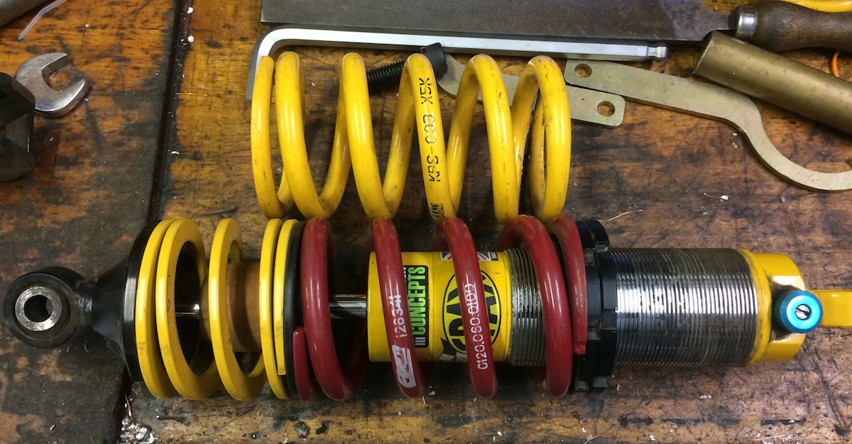

Here we go again. Increasing the rear springs from 500lb to 570lb. Hopefully we'll be able to run a light ARB or better still none at all.
what does that translate to in wheel rate?
570lb
surprised you even need a roll bar at all then :lol:
With 500lbs, 25mm was an improvement over 19mm, which was better than none. Thus bigger springs necessary and hopefully none.

Nice work. We ran yesterday with 570 and it was definitely better. Next meeting 650.
