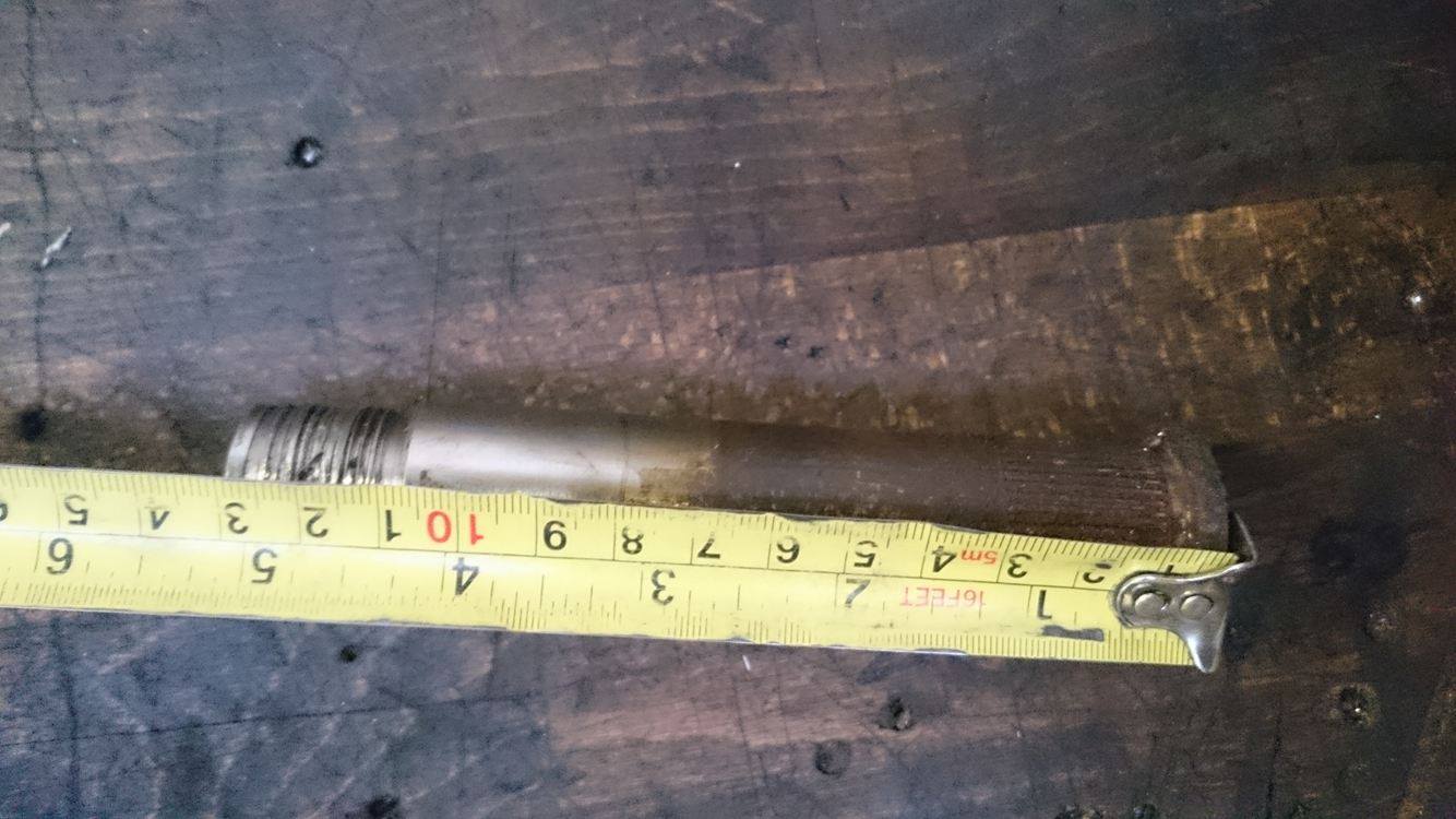

could anybody clarify if this is a 309 GTI stub axle or not, brought a replacement 309 gti one but its longer, not sure which one is correct.
jimmi
A 1900 205 GTI is same as 309 GTI stub pin /axle - approx 132mm long overall. The m22 thread on the end is 22.5mm long. From the end to the shoulder of the plain shank is 127mm long.
Bearing spacer is around 13mm long. Pins are 25mm diameter. Pins for models with drum brakes are shorter.
And
Mite be wrong but that looks like the longer 306 one
