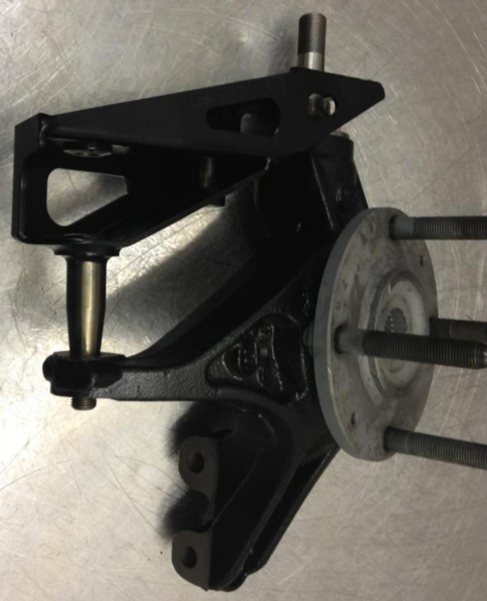

petert 585 Posted April 4, 2016 I run 405 driveshafts with Grp A hubs. Top mount centre position is very different however, if you want to stay between -3 and -4 deg camber. Share this post Link to post Share on other sites
