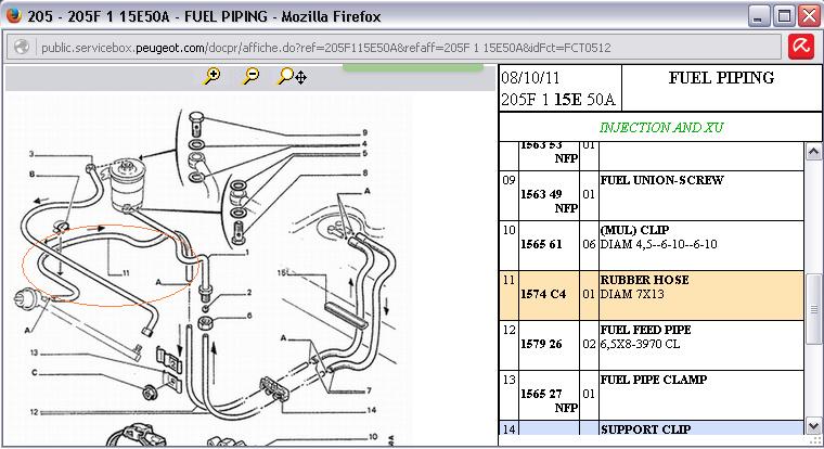

Inspection shows that one of my fuel lines is perishing. Peugeot want £54 for it, so has anyone used any good quality, reliable alternatives?
Its on the back of the FPR, screenshot shows the one i'm after.
Cheers.
I've always replaced that with some generic 7mm fuel hose from a motorfactor, cost probably about 5% of what Peugeot is asking.
There's nothing special about that one, just a straight hose. And yes, it seems to be the first one to perish - it's needed changing on most (if not all) 205's I've ever owned.
its the only non plastic fuel pipe in the engine bay, not under any pressure so some generic injection hose would do the trick.
