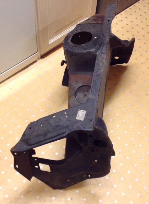

Ive got one of these but drivers side anyone done a thread on what's involved in swapping?
A lot of work to do it properly, unless the turret is rotten or damaged I would not personally fit the entire piece. It's easy enough to make a repair section for the area that usually goes rotten.
cleggy
It's not rotten there's just a bit of a bend in the one that's on the car at the moment! Had the part a few years now in the house, been meaning to have a crack at it for ages
cleggy
A bend I didn't notice when I bought it, the perils of buying in the dark I guess
Juttie205
shouldn't be that bad to do but you will need to drill all welds from chassis leg to do and make a jig so everything lines up. you say its bent where as if its the chassis leg then fitting a new side wont loose bend.
Where's the bend? most likely ahead of the subframe mountings, better to get it on a jig and pull it straight, then fix any rust.
cleggy
It's not the leg, it's a crumpled mess behind the headlight! Botched up by previous owner I think
I'll post a picture in the morning, my mechanic mate wanted to cut a bit out of the new bit and stitch it in
Juttie205
the leg goes all the way to headlight panel
cleggy
I'll post some pictures in the morning
I would not replace the turret for what you are describing. It would be like amputating your leg for an ingrowing toenail. Just repair the bit that needs it!
cleggy
Haha sound I'll take a look!!
