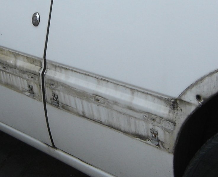

The metal clips fit on the bottom row of rivets. Fit the clips first and slide the trip up under them. Then the rectangular plastic clips go on the top row of rivets which are sticking through the holes in the middle of the trim. The red inserts clip over the top of the rectangular clips and cover everything up.
This is the metal clips fitted:

Thank you Ryan that makes sence.
