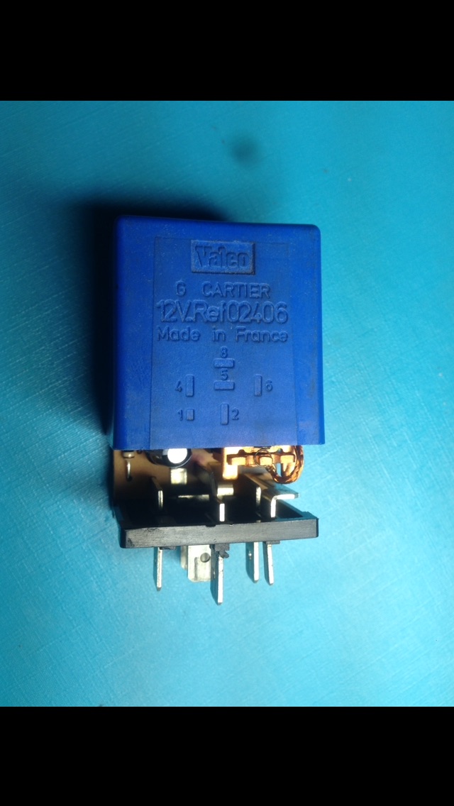

First thing is to remove cover

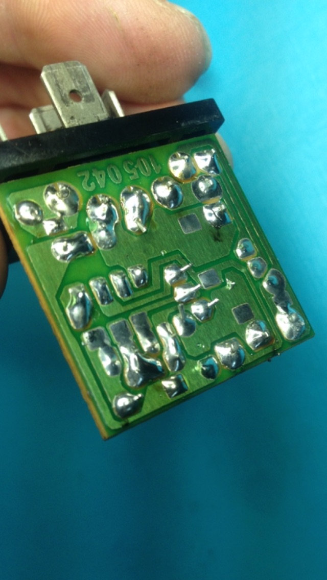

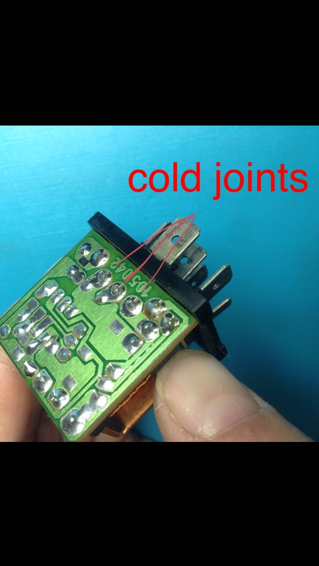

Noticed the cold and cracked joints

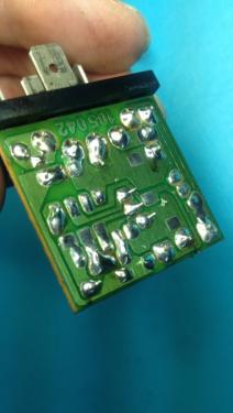

Using new solder and a solder gun , just need to "reflow" the joints so they melt and hold back together .
Make sure you don't "overflow" the joints .
That's it I think. Maybe something to try before you decide to toss the relays away.
