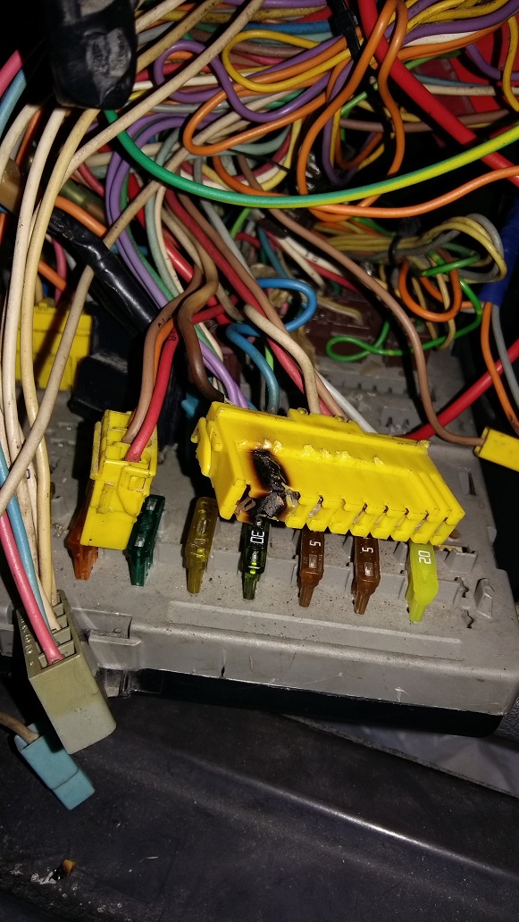

I found the culprit. Turns out, something went wrong.
This was the connector coming from the combination switch to the fuseboard. I replaced the wire and the connector from a spare harness I had. I've also taken the time to install two relays for dim-dip, and the difference in the lights is amazing.
Still don't know what caused the fire though.
Are you headlight bulbs higher wattage than they should be? That's always been the cause every time I've seen that.

The melting of the plug happens over a long period of time.
When I've seen it the cars have been working fine for multiple years with excess wattage bulbs then eventually the lights cut out.
Sometimes the bulbs have even been removed after the damage has been done but before symptoms show.
But every time I have seen that plug melted there has been a high wattage bulb fitted or the owner has admitted to me they've had them fitted in the past.

The current bulbs are 60/55. Only thing is, one bulb is an osram and I have no idea where it came from. It probably came with the headlight.
I'm now running two relays for the lights, so I don't foresee this happening again.
