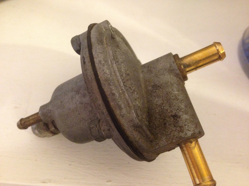

Does anyone know how I can test this regulator?
Bin it and buy a fixed one is the best approach!
or fit a gauge.

Ha, I agree - what I want to know then is, what fuel pressure should I have?! :)
I seem to remember it was about 3bar, Golf 16v injectors... Might see if Emerald can help too, thanks!
Does 3 sound about right?

Cool, I found the injector code too and that also says 3, awesome! So next question, where do I get these from?
The ones I have found so far all have a far larger sized inlet diameter.

get what?
the FPR, Standard weber/bosch unit would work just fine, you just need a holder for them, are you still using the 8mm push on hose?

Yup, same hose :)
Thanks, I'll check that is going to give me 3bar and get it ordered, cheers!
