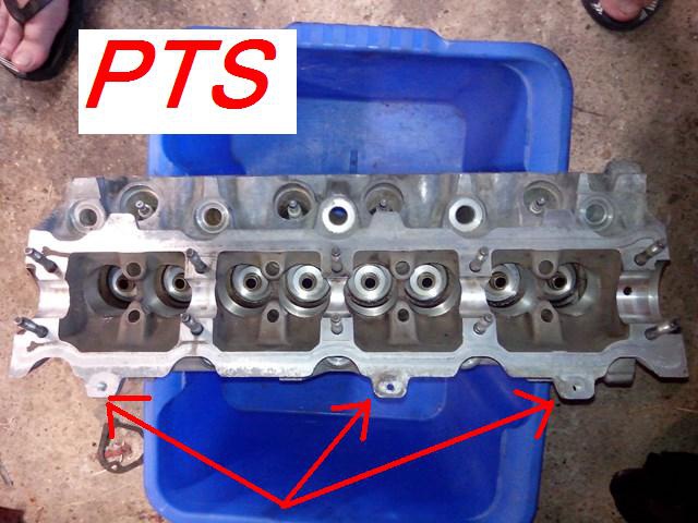

Attached all i have on 125 kit at the moment.
Notice they use the 84 earl 85 head...

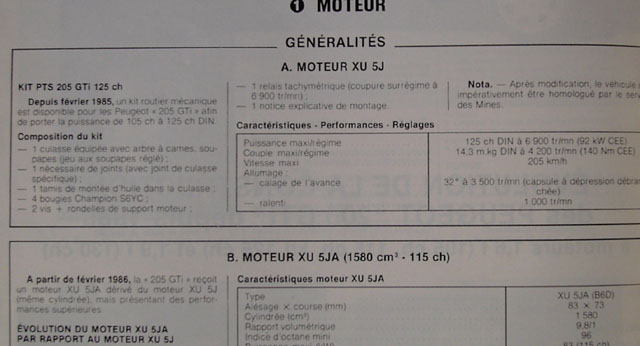

205tunerke

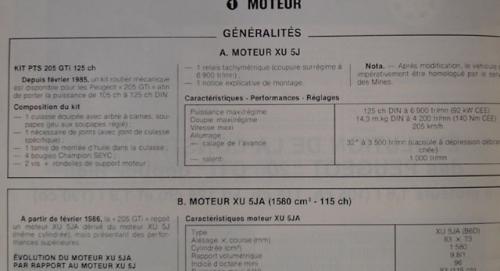

Got my hands on a tech sheet.
Seems the pts kit used a cam identical to the later xu5ja 115bhp 230°cam.
Or actualy the cam was so good they used it in there later production models.
The pts kit used 41.6mm inlet valves, 34.5mm exhaust valves.
These valve sizes can be found in late model 1.6 or in 1.9 engines.
Further more they changed the Angle of the valveseats.
And they beefed up the compression ratio from 9.8/1 tot 10.3/1.
Other sparkplugs: champion s 6 yc
And a special head gaskett.

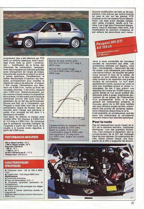

The 105 BhP engine died at 6250 rpm probably by black of breath...
Keep in mind the 125bhp kit:
They used valves large enough to run later Models 1.9 engines
They used 2mm more lift then on a 1.9 cam with the same duration!
If a1.9 could breath good on these spec, imagine how good a 1.6 with 2mm more lift would breath...
The engine's crompression ratio was improved...
The short stroke plus great breathing allowed it to run vivvetly up to the rev-limiter...
If you take a look at pictures above you notice the 125 bhp has not reached it's turning point jet, just stopped by rev limited.
So a 125 bhp setup without rev limited could reach even higher figures ( nog verry much more, but still imagin...).
