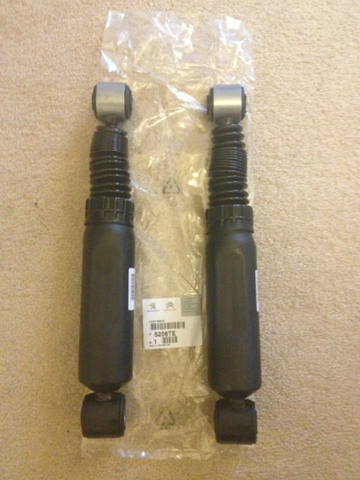

Alan77 78 1 Cars Posted July 29, 2015 Sorry, can't help with the dimensions you ask for, but here's a pic of 5206TE for reference, which I put on my car a couple of years ago. Share this post Link to post Share on other sites
