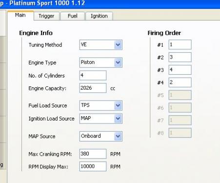

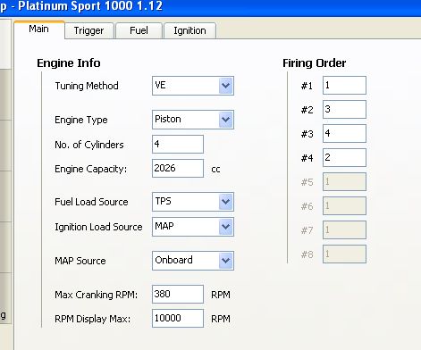

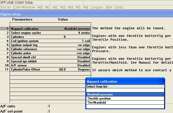

It's certainly a fascinating subject. As you can see from my setup, the fuel is still mapped from TPS as the primary source, but the method is VE. Haltech has only included this method in recents years. Motec & Autronic have always had it as the only option, even though it's not called VE, regardless of whether you choose MAP or TPS as the source.
