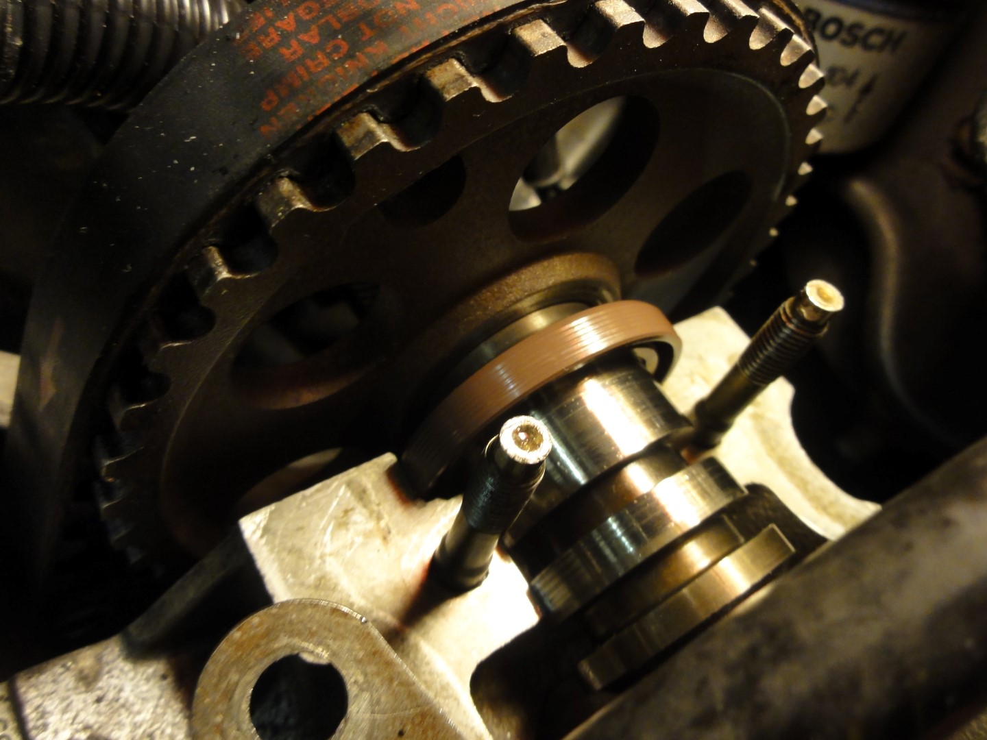

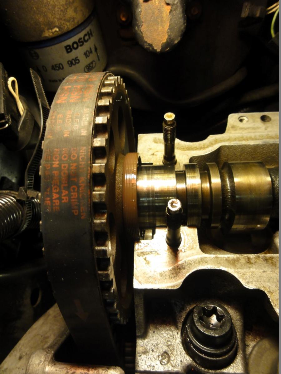

It was difficult to spot exactly where the oil was coming from and I did a lot of poking about with cotton buds but not massivly successful. However I did notice that the cam seal was sticking out significantly and when I compared this to my spare head, it didn't look right.

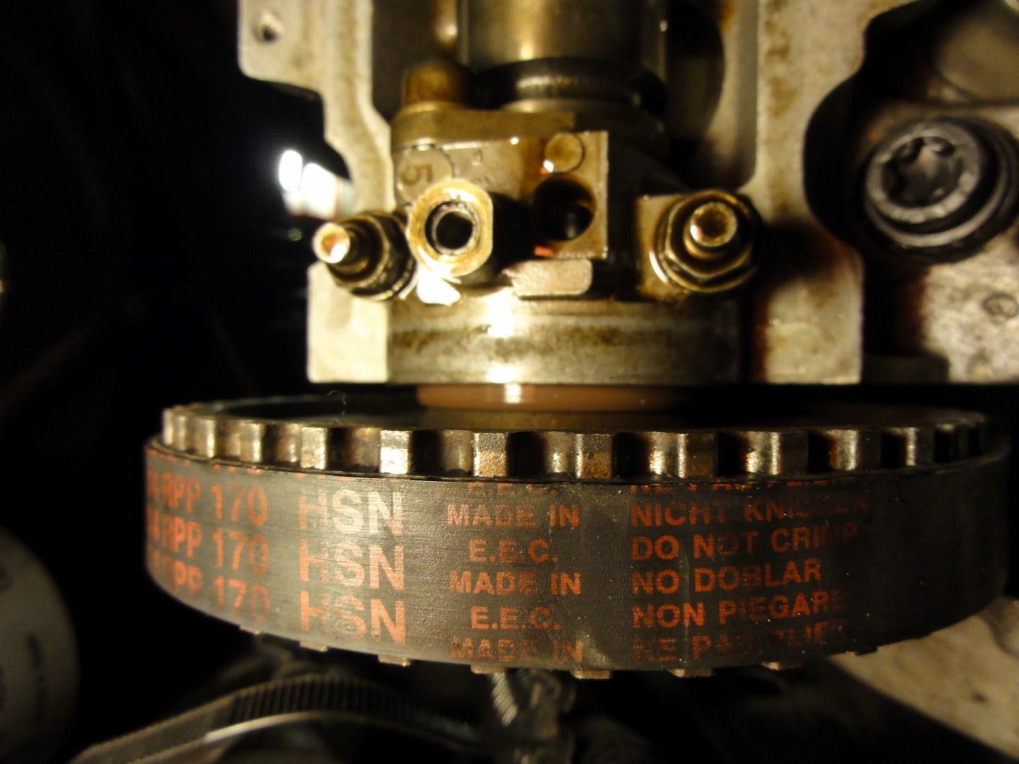

So I removed the bearing cap and saw this:
It didn't look right!

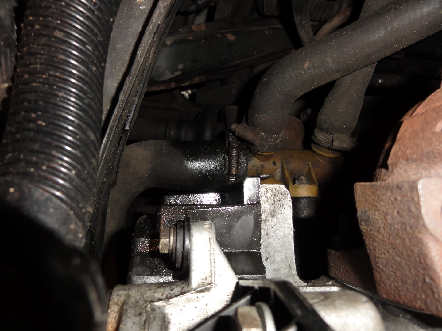

So I pushed it back flush and applied a very thin layer of sealant to the mating surfaces and torqued it up. I also put a layer in the seal face just in case the cam seal was working its way out as I am sure I would have spotted the seal sticking out so much when I fitted the cam pulley:
I have run it up til the fans came on and no leaks as yet :)

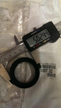

So a year later and the seal is popping out all the time. This is the cause of the oil leak I have removed the bearing cap again and cleaned up the flat mating faces as it was not leaking from those. The seal will push back in with ease so the seal housing has either enlarged or the seal (Payen) is undersized.

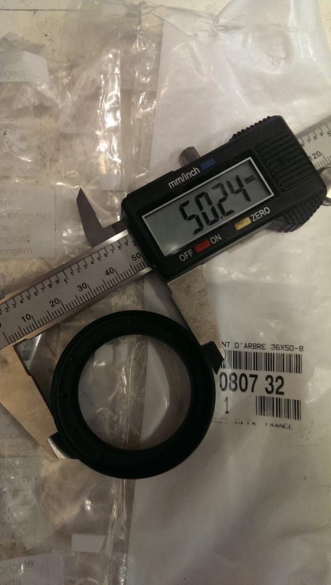

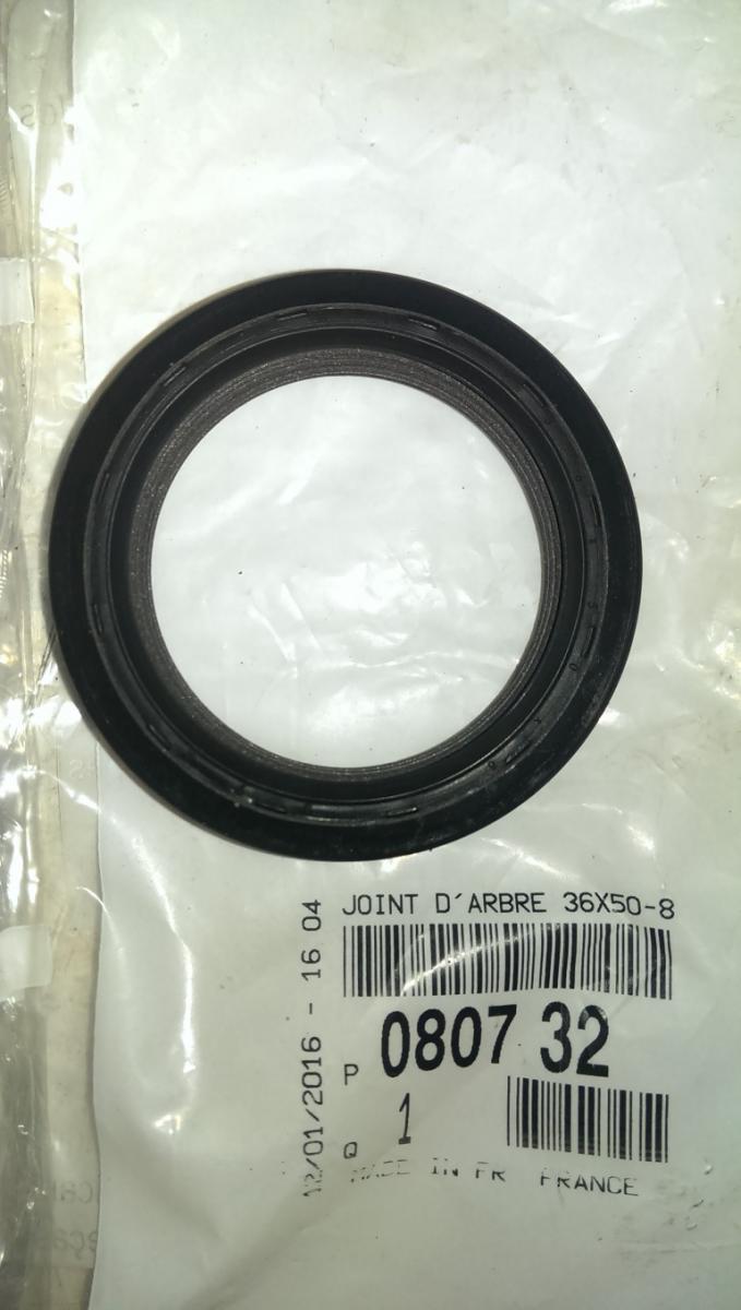

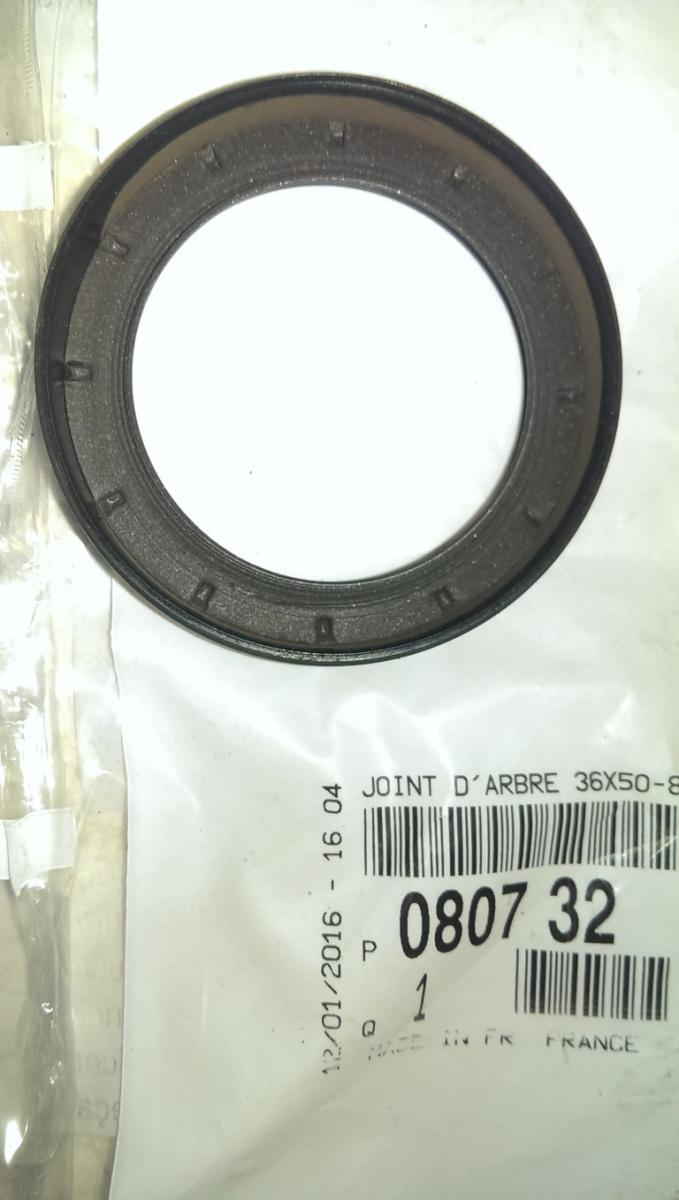

I have bought a genuine Peugeot seal (Part Number 0807 32 @ £13 with PSC discount) now to see if that will fit and solve the issue. I noticed that the design is slightly different as the Peugeot one is slightly wider and only has a 45 degree taper on one side.
I took the timing belt off (god I hate belt covers and the fatter aircon bottom pulley), and also the cam wheel, cam cover and bearing cap off to get the seal out as I had pushed it back in with a screwdriver previously.

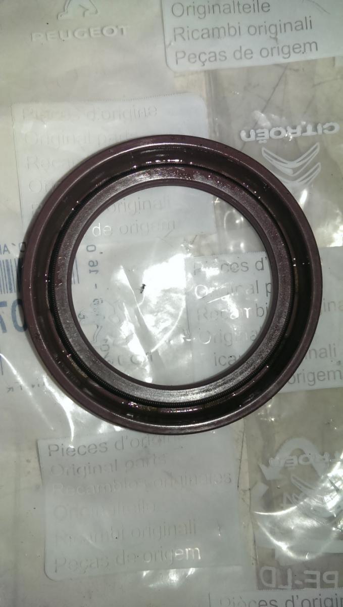

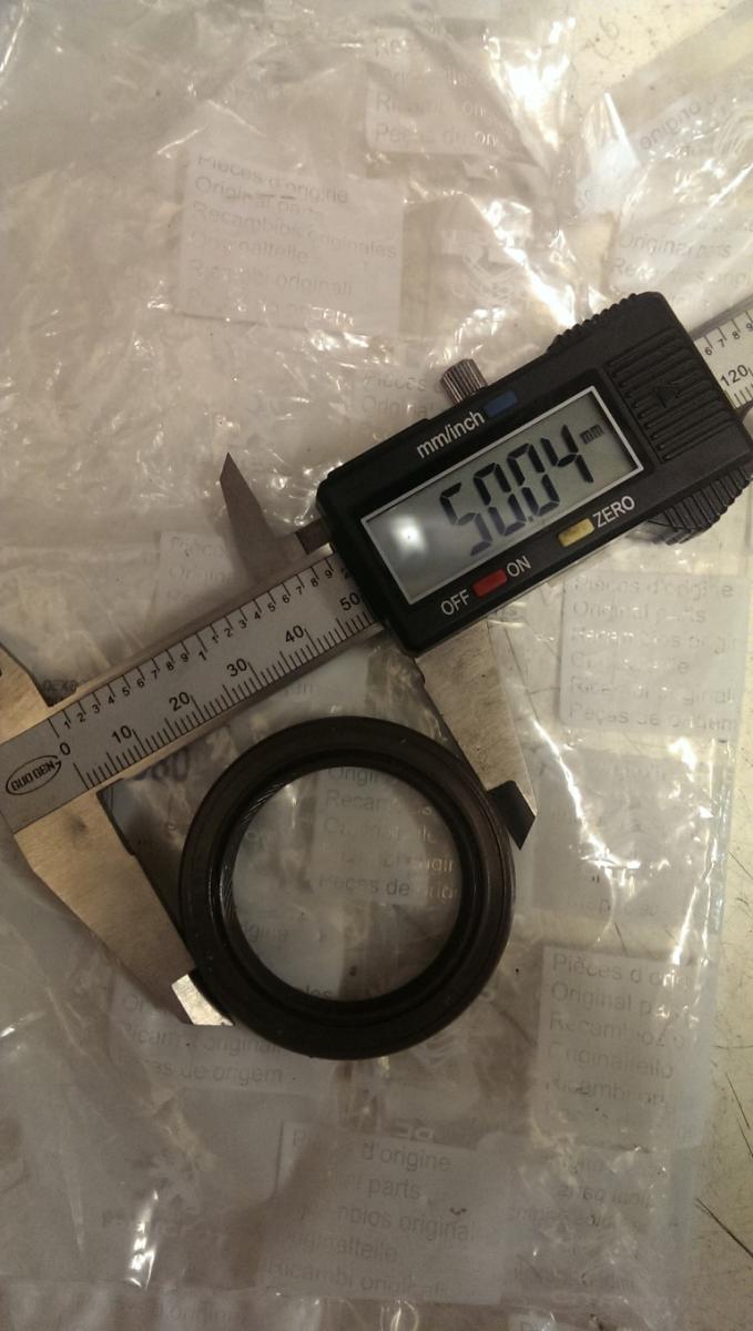

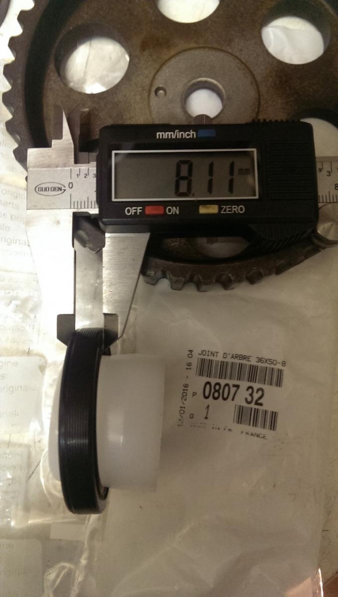

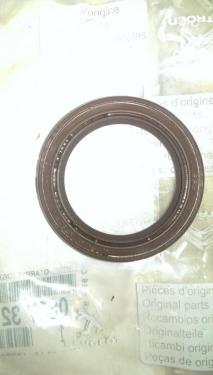

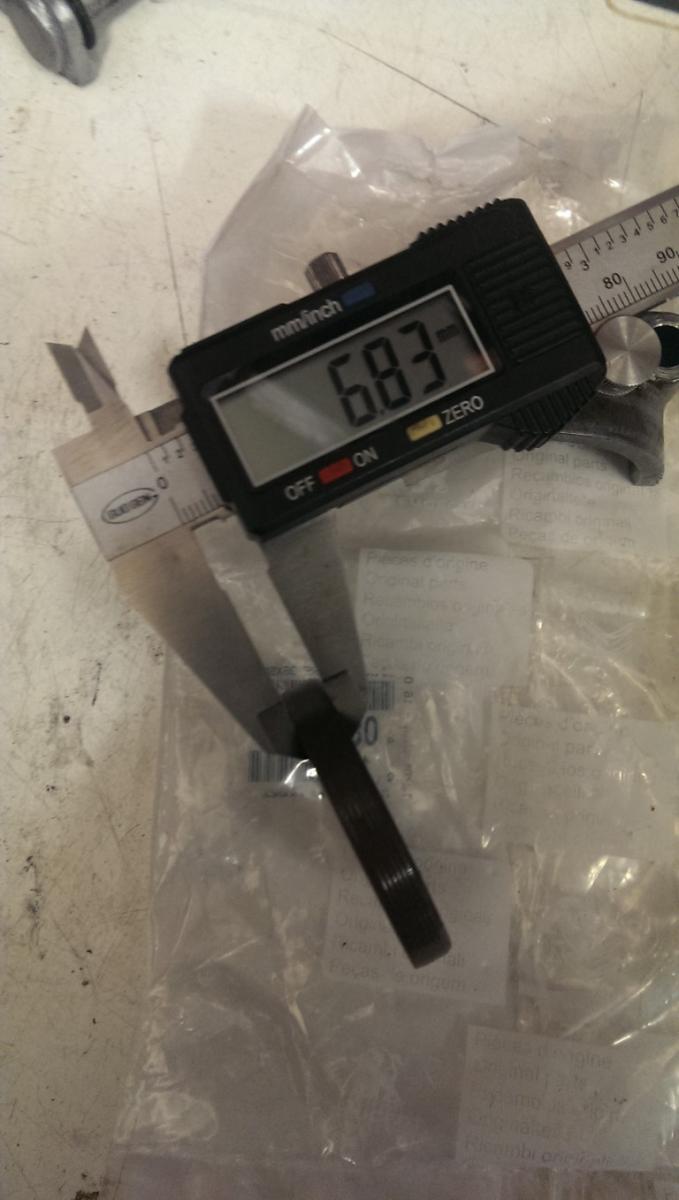

So once out, I did some measurements and the Payen and the Peugeot one are quite different, so here are my findings for reference:
Peugeot on the left, Payen on the right
Conclusion:
The Peugeot seal seems to be a better design as it is wider and has squarer shoulders and more ridges. The Payen seal has a wound spring to provide the tension on the seal lip, where the Peugeot one has a plate whicj is notched and under tension. I was surprised that the Payen one seemed not to standard as I regarded them as a quality part and perhaps even the original equipment manufacturer.
Hopefully it will solve my leakage issues as is 0.2mm wider in diameter, but I am debating whether to glue it in anyway whilst it is all apart or fit it dry, using the old seal as a spacer to press the new seal in, using the cam pulley as a flat plate and winding the bolt in. Once in, I can remove the pulley and the old seal and torque up the bolt. It is hard to tap a socket in as a press when in situe.

New cam seal has been fitted (not glued, not centre-punched) and I have done about 10 miles of a hard blast around the Peak District and all seems find so far. More miles are really needed for a definitive answer.
So, unless I just had a duff one, the Payen one which came with the head set was undersized for my 1992 Catted 1.9 engine. Buy a genuine one if you are doing this, or at least measure to make sure the seal is greater than 50mm
