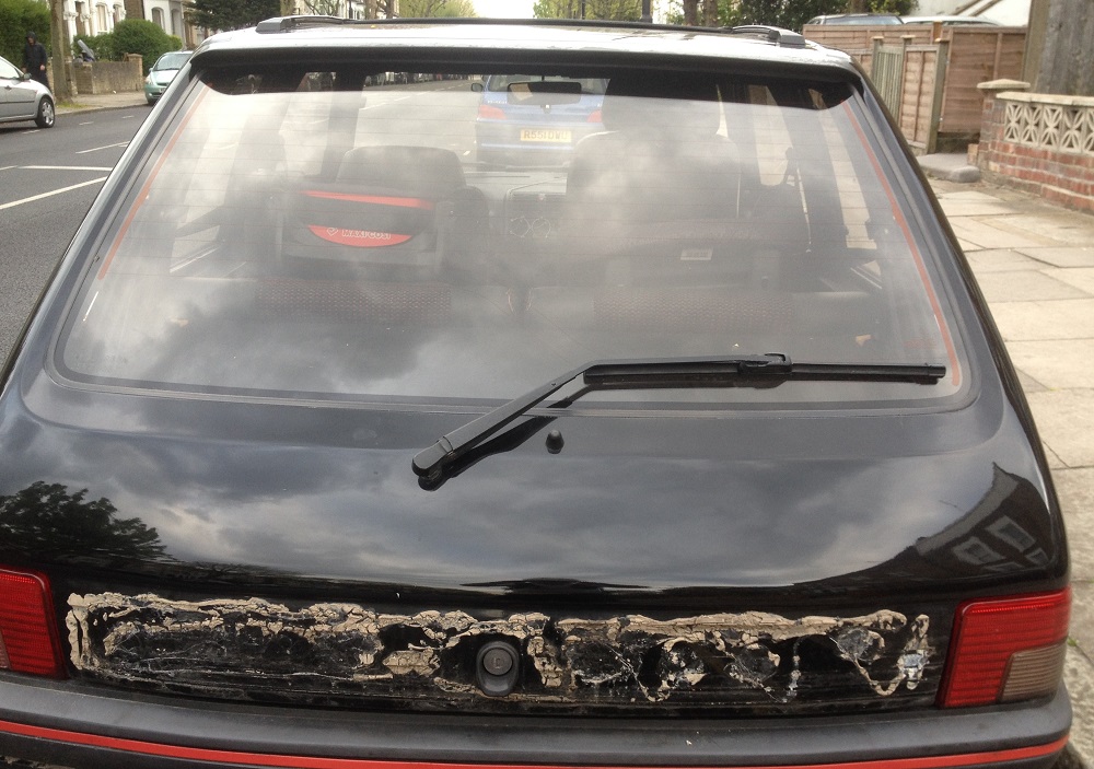

This is the mess at the moment. Can't see any obvious mounting points

Sorry picture didn't post from mobile. This is the mess at the minute.
Thanks for the help here folks, Mac Crash or anyone else who has clips, I'd definitely be interested.
If not will need to get it stuck on better.
Anyone got any thoughts on cleaning this up?

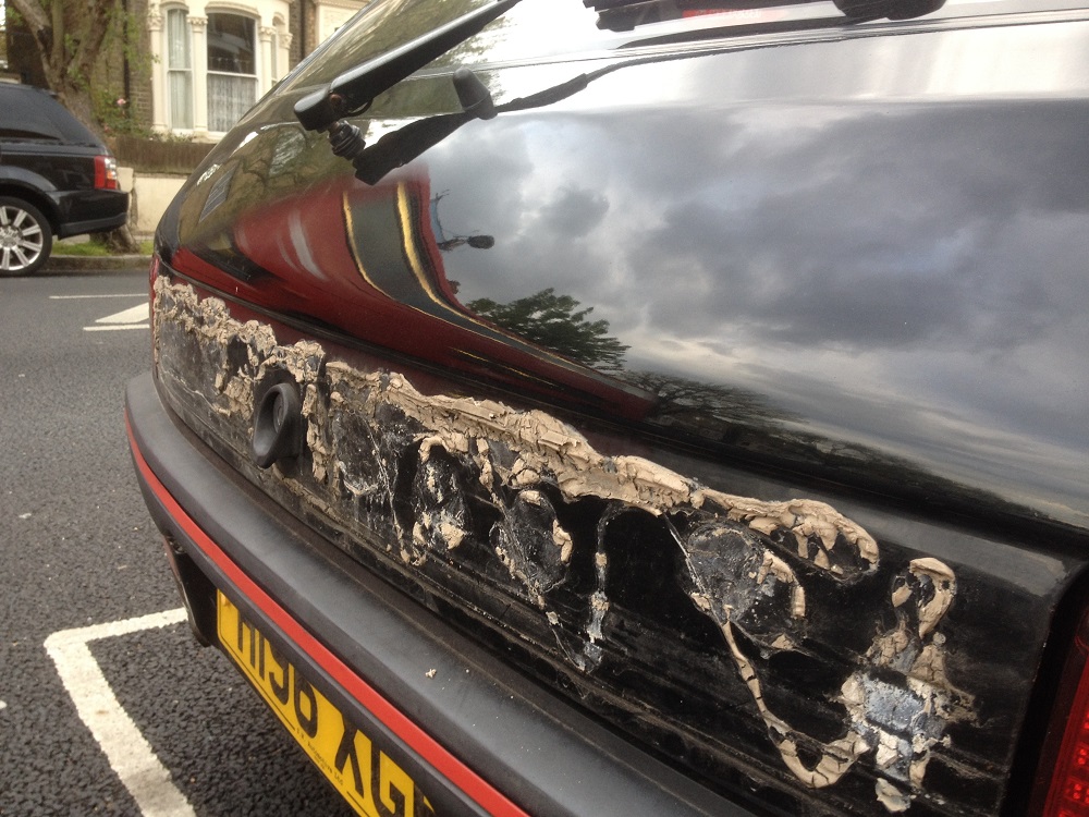

Here's another shot

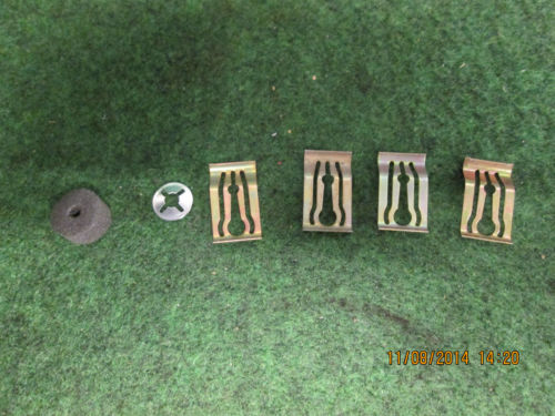

I have over 100 of the clips.
£1 each plus postage

Think you'll need one of those rubber wheel drill attachment things to get that off. The rivets will be in there somewhere i would think.
The rivets that the clips go over are behind where the tailgate badges would be, two each side.
I can't obviously see them in that picture, so I wonder if they've been ground off previously to make a smooth panel?

Rear panel appears flat from what I can tell with the adhesive still caked over it. Am guessing they are big enough to be felt even with that crap on there.

Farmer, I think I'd definitely be interested in some clips, please. How many do I need?
Thanks folks. Really helpful as ever.
farmer
You need 4, if you are missing the rivets I can supply them as well.

Farmer, I'd be glad to take a set of clips and rivets off you if possible, please.

farmer
£10 delivered
4 clips and 4 rivets
