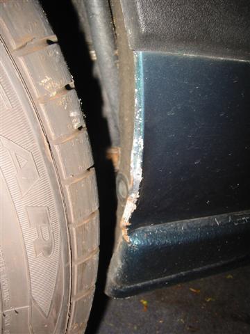

Hi I have a recuring problem.that needs sorting sooner rather than later....
What it is, the passengers side rear wheel keeps scraping the inside of the arch near the sill and Ive recetly had it welded up to reapair the damage it isnt hitting the top of the inside of the arch just the front near the sill its only the passenger side. The car has been lowered by moving the torsion bar 1 spline itwas okay at first but is now becoming a expensive problem
Any ideas as to what it might be?

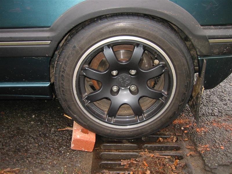

I had this on my CTI. If you lower the beam it does tend to bring the wheel forward.
This kind of catching?
The wheel still looked central though

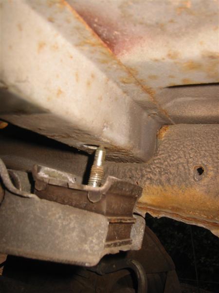

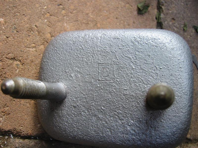

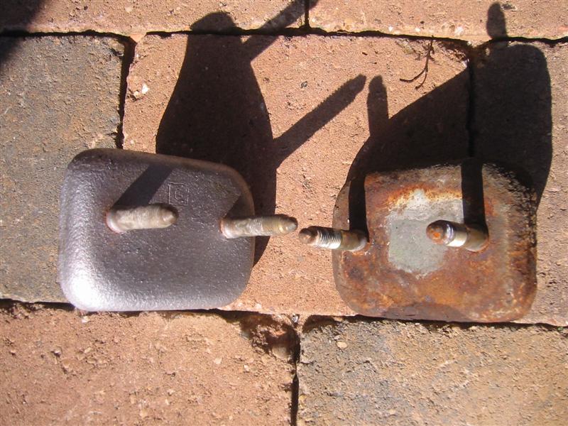

What might be the problem is that you are on 1.6 rear beam mounts and if you switchedto 1.9 mounts, then they are sided and will move the wheel back slightly.
1.9 mount on the left, 1.6 on the right
1.9 mounts have a D & G (not Dolce & Gabbana) but Droit & Gauche (Left & Right)
You can see how much they move the rear mount back as the sandwich rubber is still set for 1.6 ones here
Other way around, droite = right, gauche = left.
