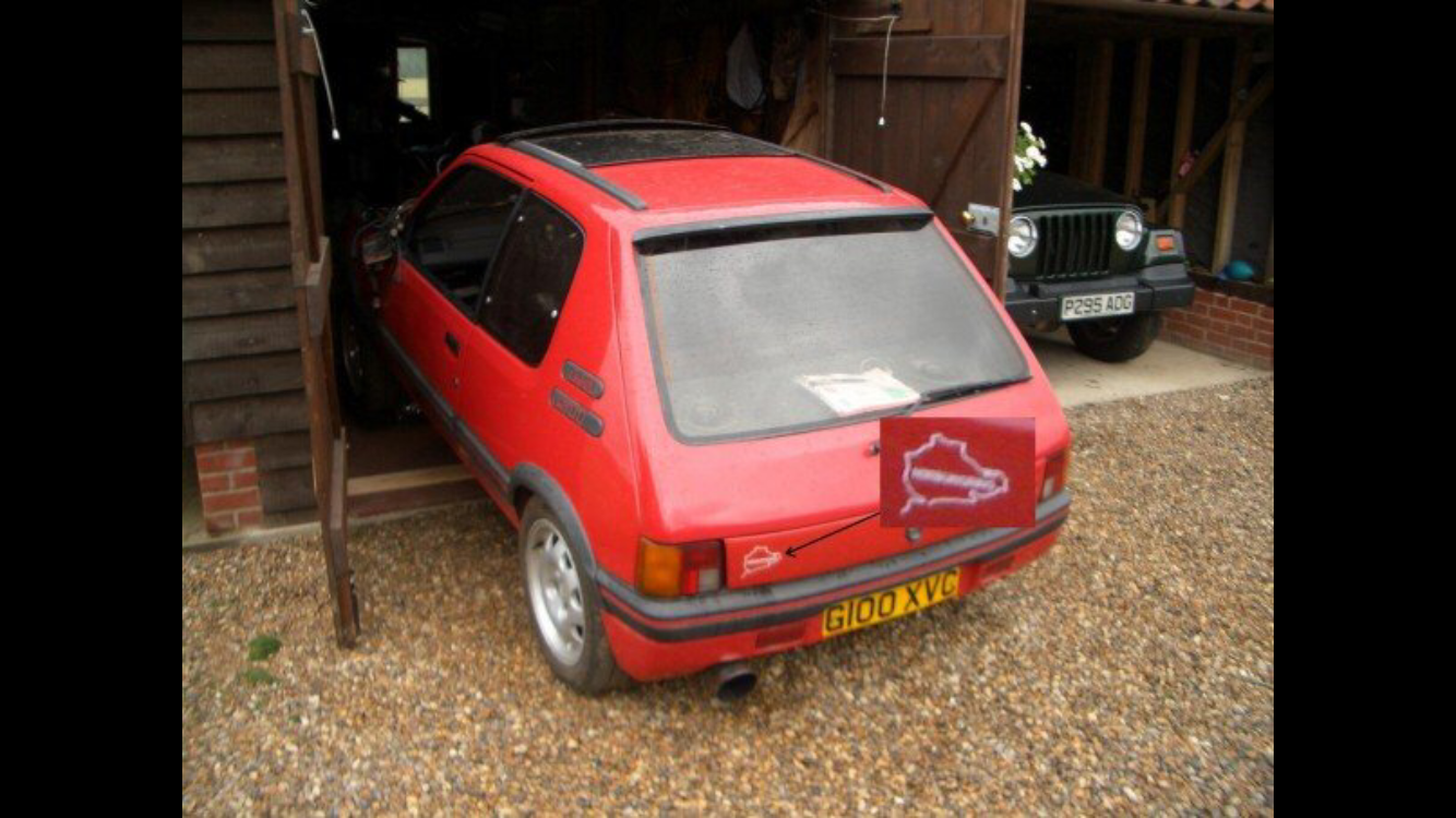

gibbz
Not the first Picture as they are printed on that funny old shiny paper stuff.
2003 -Check the bean can! and Nurburgring sticker... i was such a LAD! ha ha

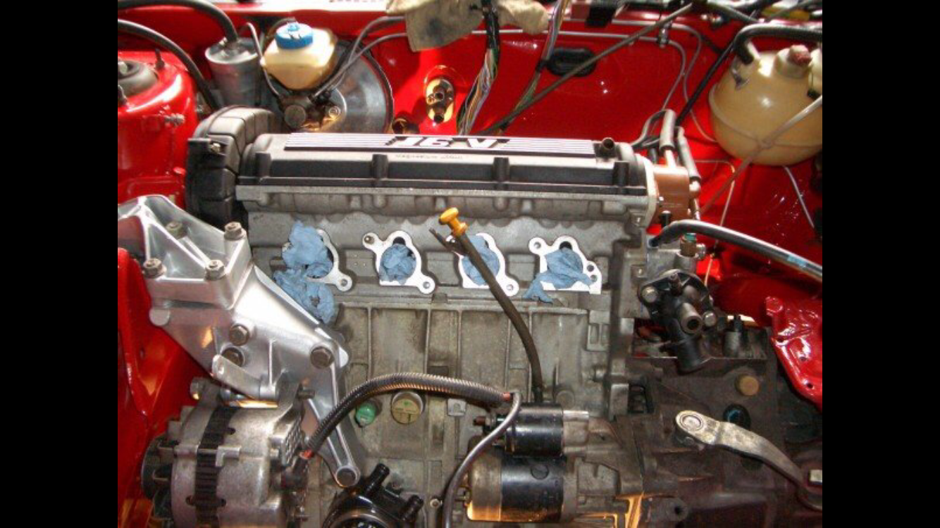

2005 - Second time the Mi went in but this time with a fresh Uni rebuild.

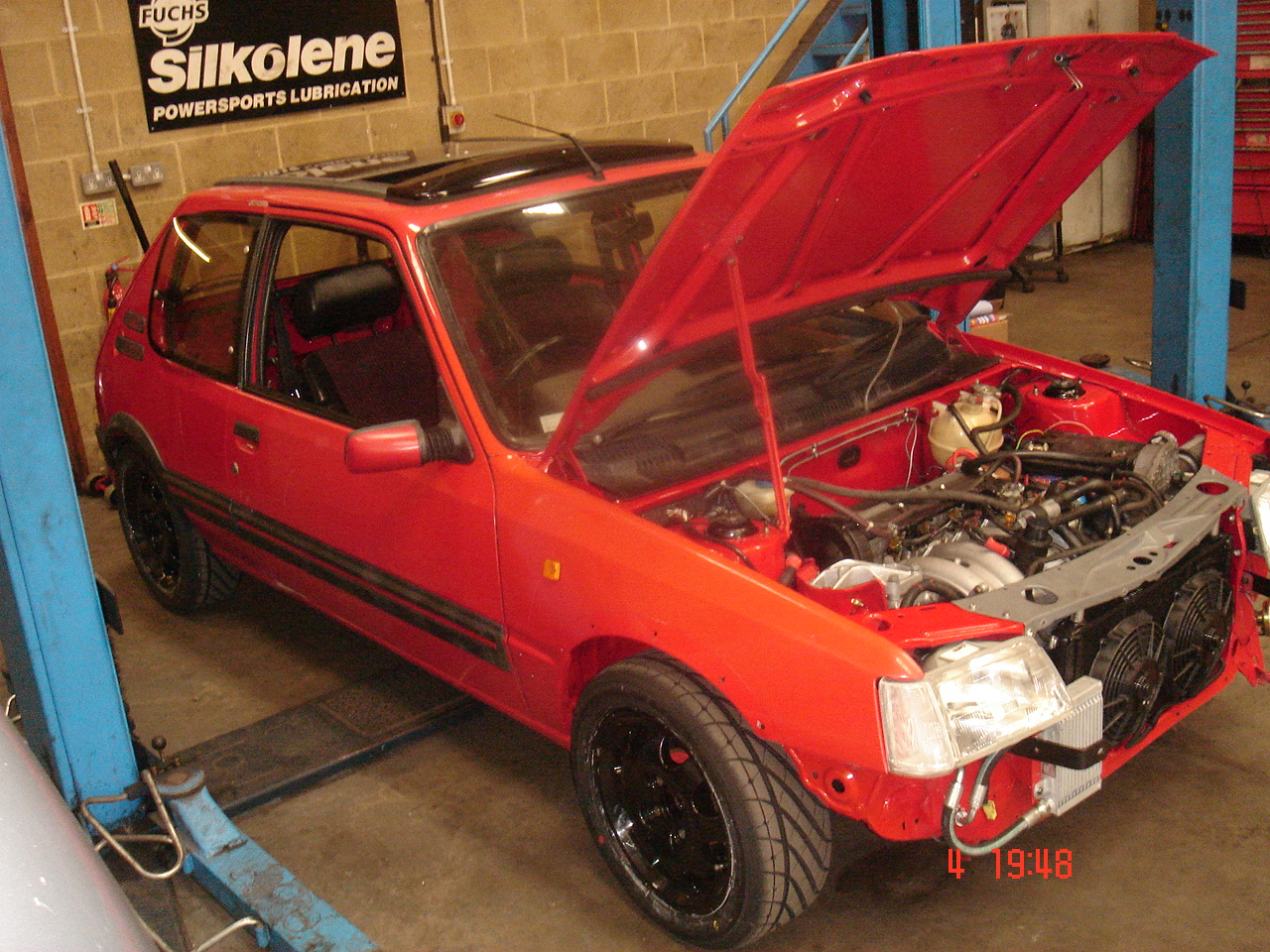

2009 - Third time i revisited the Deux - Cent Cinq spending money on shiny bits

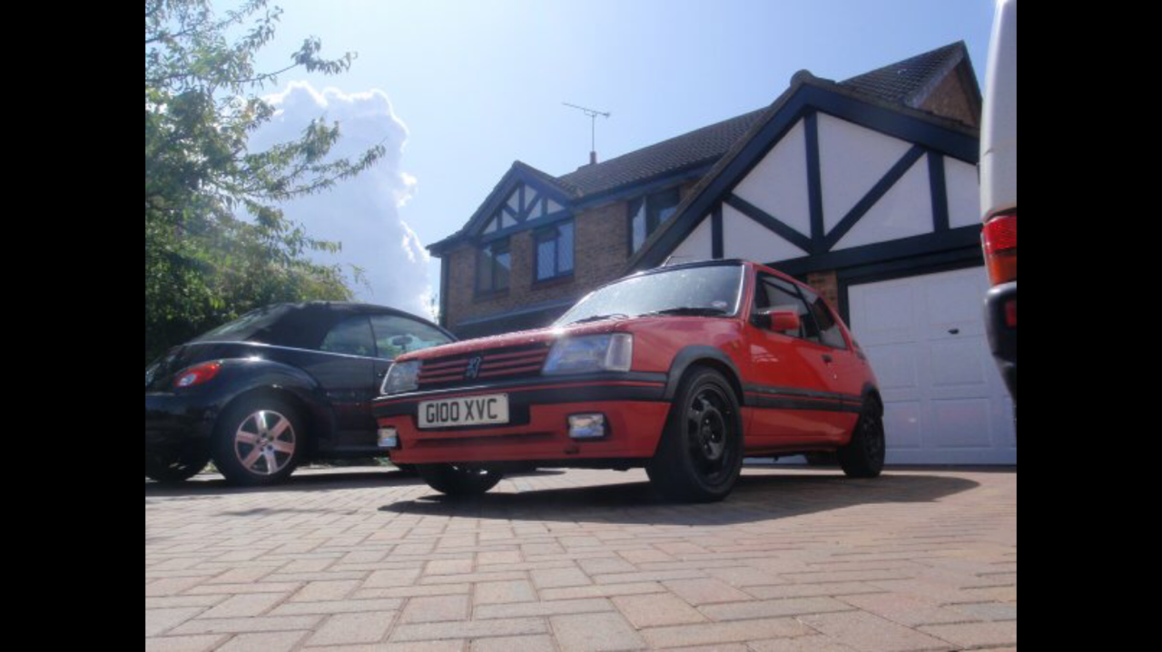

Couple of shots when it got to its best to date in 2009/10
Good times :)

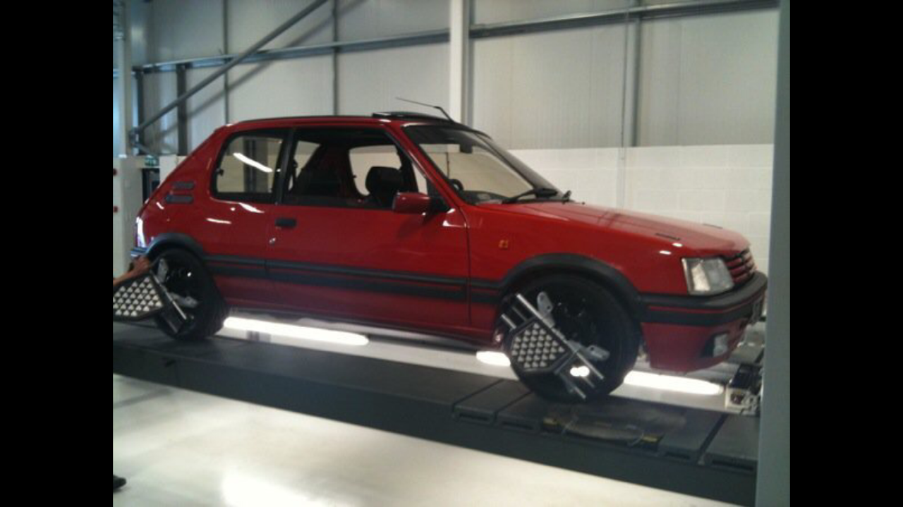

Four wheel Align!
Anyway after being of the rd for a couple of years its now mot'd again and being enjoyed. but my next step is a new full exhaust system with itbs and cams also soon to be on the cards!

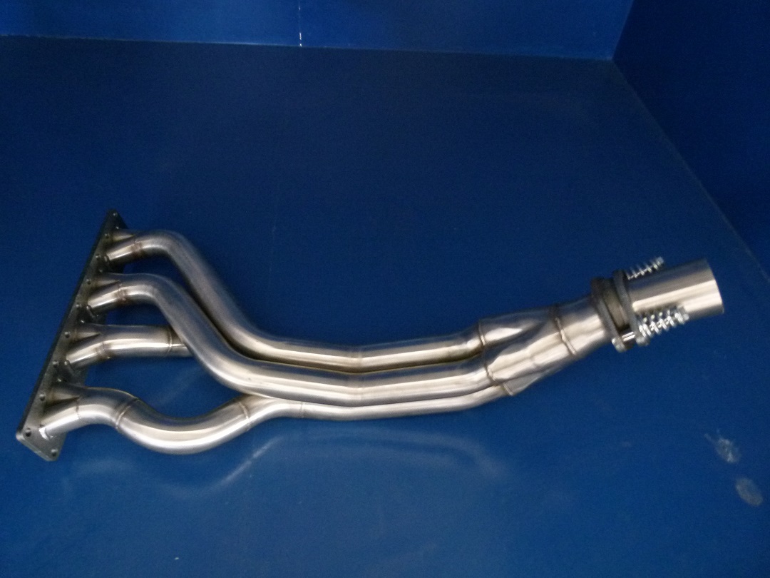

So MI16 exhaust manifolds - looked and read a lot on here and it all heads in two paths!
  • Maniflow 4 -2- 1 or longmans 4 - 1 (both mild steel)
  • An the main man Miles, sweet manifolds (Mild or stainless)
I did some research and reading and found a couple of other manifolds not tried or tested that after a few calcs also seemed may offer some gains to power and torque from 3 to 5krpm.
two other options..
  • Swedish Peugeot Tunning specialist 8 4 2 1 - (stainless)
  • Dutch tubular manifold Specialists 8 4 1 - (stainless)
So after running my Calcs past the resident engine guru at work, it pinpointed to the Dutch manifold.
I will add some pictures tomorrow of the manifolds as it has now arrived!
Edited by gibbz

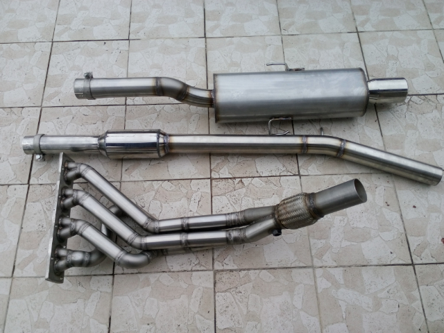

gibbz
Swedish Peugeot tunning company Manifold with exhaust
Dutch Tubular Manifold
next i plan to have an exhaust Fabricated locally but i am not sure if i should go for a Twin box system or single larger rear box... im after an original raspy 205 Group N rally note obviously not to restrictive and not to loud.. definatley not boomy... it will be tig welded and 304 Stainless 2.25inch with mandrel bends thats about all i know for certain.
any thoughts or help with this would be much appreciated?
