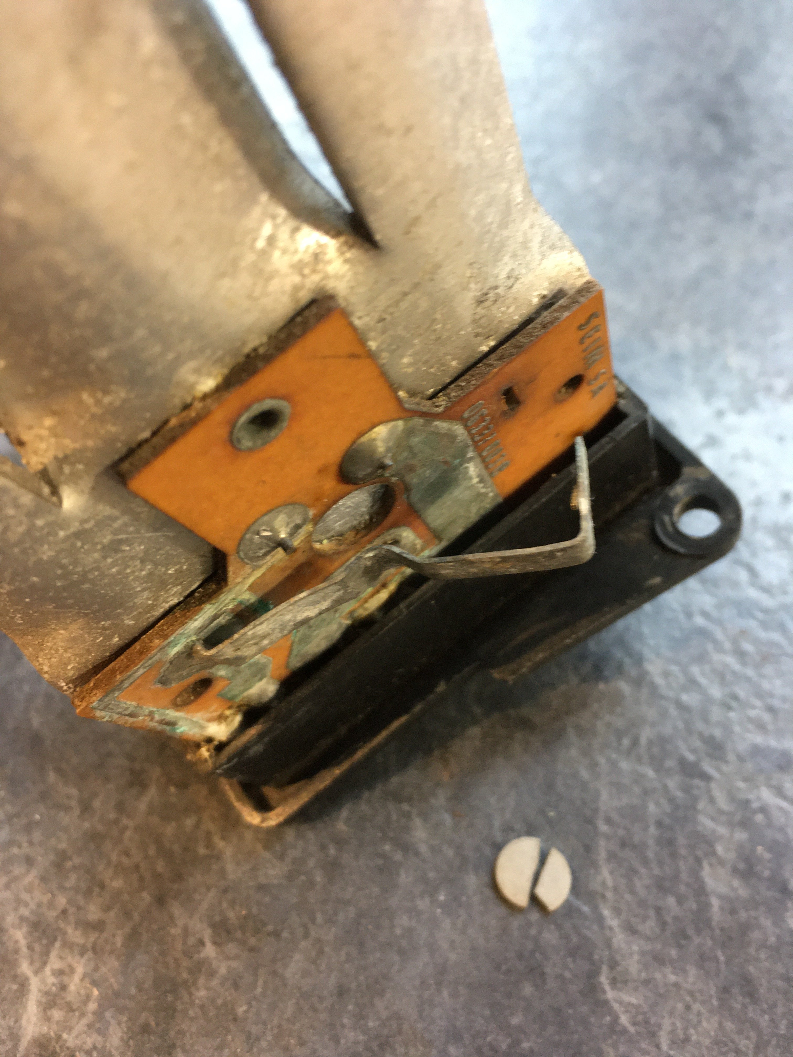

SootySport
Just been fiddling with my 4 pin resistor as above.   The spring can be released from the circuit by reading the clip in the hole in the circuit board. You’ll then see a small metal disc sandwiched between the spring and the transistor, it will fall out when you invert the board. My metal disc was broken in two pieces. Clean the metal disc, spring contact point and surface of the transistor as in previous post, replace the metal disc and retention the spring for good electrical contact, press end of spring back into circuit board.  My fan now works at all speeds again.
