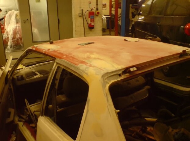

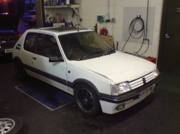

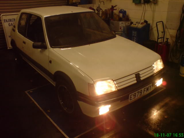

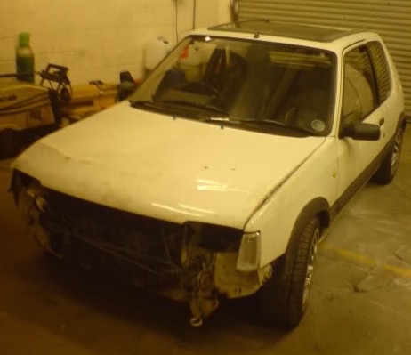

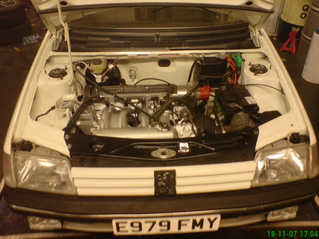

thirdtimelucky 3 Posted January 1, 2015 Some of you are aware of the existence of this car, I've done some work on it over Christmas, so this thread will be some background and an update of the work I have done so apologies if it's a bit wordy. Because this is a rebirth of an old project I thought I'd start with some background about the car. The car was a £200 ebay buy about 8 years ago, it had some crash damage to the front and the owner was third party and couldn't afford to have it repaired. The advert said it would need to be trailered away because the oil cooler and rad had split. I didn't have a trailer at the time so I turned up with a spare rad, oil cooler and a bag of cable ties then drove it back much to the bemusement of the owner. I got it back to the workshop and pulled some metal work about so I could fit headlights and a bumper. After a couple of months driving it I decided to respray it and fit a 1.9 mi16. I prefer the non sunroofs so re skinned the roof, when I re skinned my previous 205s roof I got a new one from Peugeot but they where on back order so I used one from a scrap base model. In February 2009 I was looking on this forum one day and came across a thread about a Euro trip coming up that May, my brother and I had always fancied a trip like this so put our names down. I'd always wanted to do a 4wd conversion on a 205 and had the running gear from an mi16x4 for years sitting at the back of my workshop. 3 months of evenings and weekends and the conversion was done and we set off for the 3000 mile trip around Europe. The car was great fun to drive, handled well on the twisty stuff in the Alps. It didn't miss a beat the whole trip. We had a worrying moment when driving on a motorway in torrential rain in Switzerland, a loud rumbling noise started, it stopped when we got off the motorway and I didn't work out what the problem was till I was back in the uk a few months later driving in torrential rain again. The rubber donut on the prop collected water and through it out of balance and because the prop was so close to the exhaust they rubbed. I took it of the road at the end of 2010 because I pillaged it for parts when I built a 205 v6. It's been off the road and used as a shed ever since. I can't find any photos of the original build but I'll take plenty this time. Ok so the plan is to build a road legal track day toy, I'm going to do this in 3 stages because it will take me a year doing it in my spare time to complete and I want to drive it soon to keep my interest in the project. Im always asked, why bother you can buy a better performing car of the shelf for less money than it will cost to do this. If this is your train of thought you won't enjoy this project. If you like project binky hopefully you will like this. Stage 1. Tidy it up and bolt it all back together so it can be MOTed. Main jobs and modifications at this stage will be to sort out any rust, fit the gti6 engine I built up with the mi16x4 transfer and gearbox back in the summer. The rear diff is solid mounted ATM, so I want to rubber mount this for 2 reasons, it's bloody noisy when driving on the motorway and I want to put a 1 piece prop on to give me more space in the tunnel. The rear diff needs splitting and resealing because it leaks. Fabricate a fuel tank to go under the car, it had a 20 litre tank mounted in the car when I first did the conversion, this isn't ideal for safety reasons and a 20 litre tank is really annoying when doing long journeys, especially 3000 miles in 10 days. The front and rear subframes need to be tidied up a bit. I hope to get all this done by Apri. Stage 2. Strengthen the shell, roll cage, some decent suspension and brakes. I want to do this by July. Stage 3. Power. There was no real point in me converting this to 4wd other than I like the engineering side of big projects like this. It won't out handle any other track prepared 205 infact the extra weight will slow it down. The advantage of 4wd over fwd is more traction when accelerating with similar tyres and suspension but only when the power is more than fwd can handle. This is the part of the project that I don't have any clear direction. Its mainly going to be used on track days so what do you track guys think is a good power target. I'd like to stick with a Peugeot engine, I think forced induction to to get decent power and that's an interesting project on its own. Im not closed to the idea of using a non Peugeot engine. The Toyota gt4 engine and running gear would be a cheep. Mitsubishi evo engine and running gear could work if I used the mi rear diff as some have matching final drive ratios. If I stuck with a Peugeot engine I'd have to spend a lot on up rating the mi transmission or make a Mitsubishi evo box and transfer fit? Share this post Link to post Share on other sites
