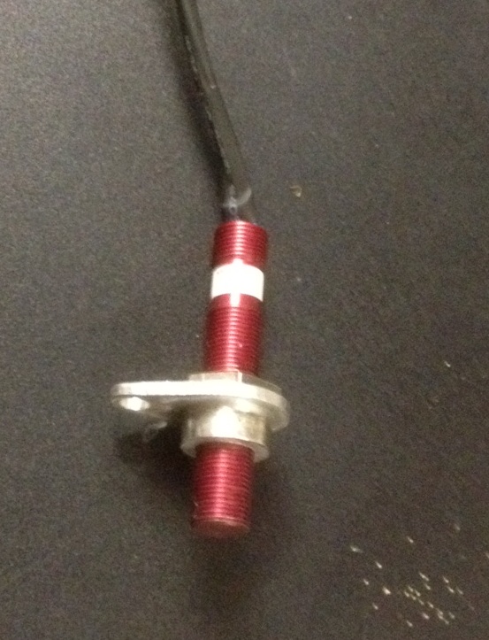

It came from Haltech and I made the adaptor to mount it. It's a 12V hall effect sensor however, not a low voltage motronic trigger. The main benefit being shielding isn't as critical and the signal doesn't get knocked around by other stray high voltages. Your ECU needs to be able take a 60-2 Hall Effect trigger.
