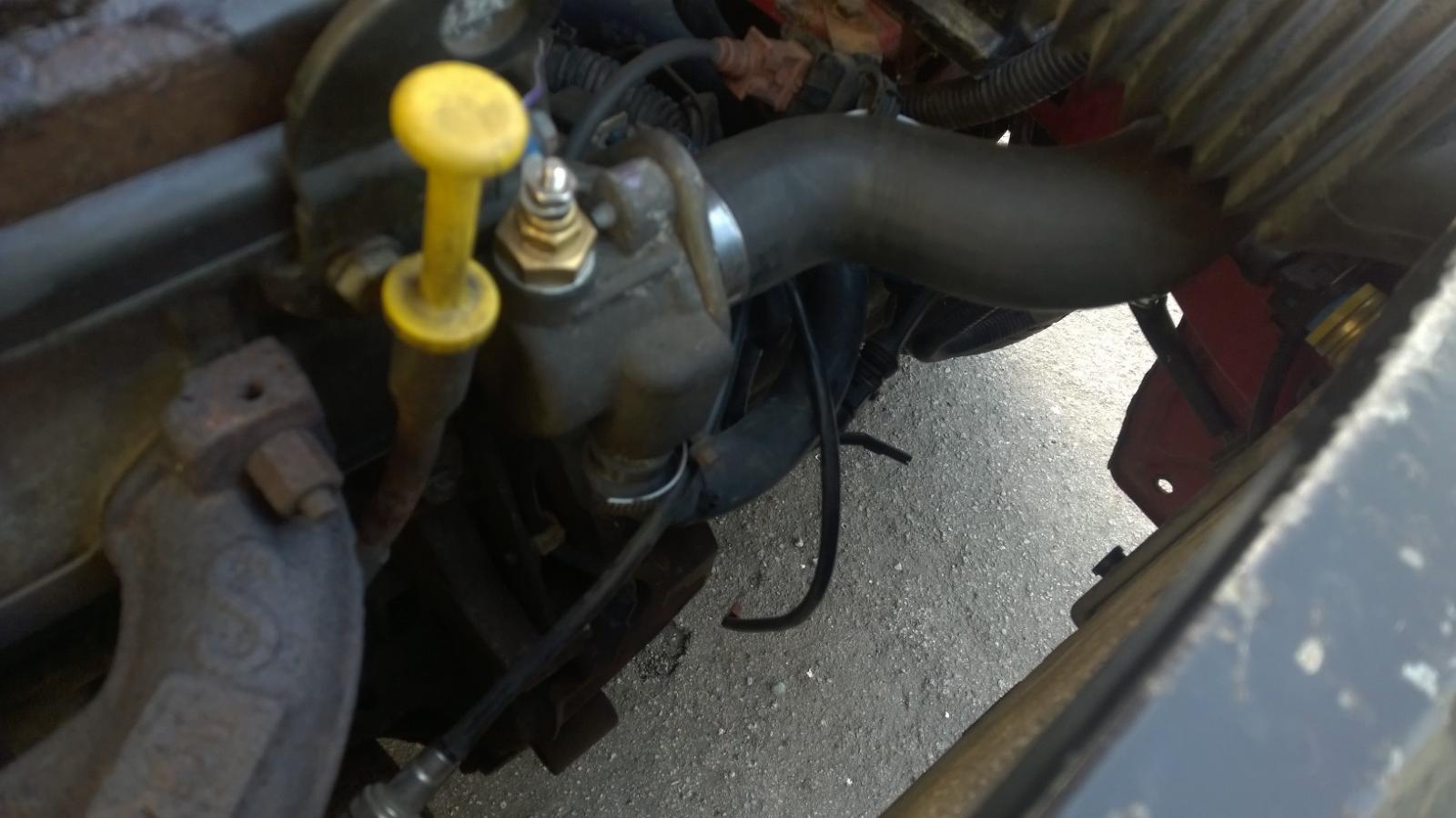

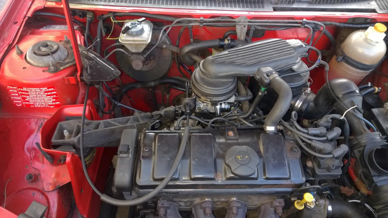

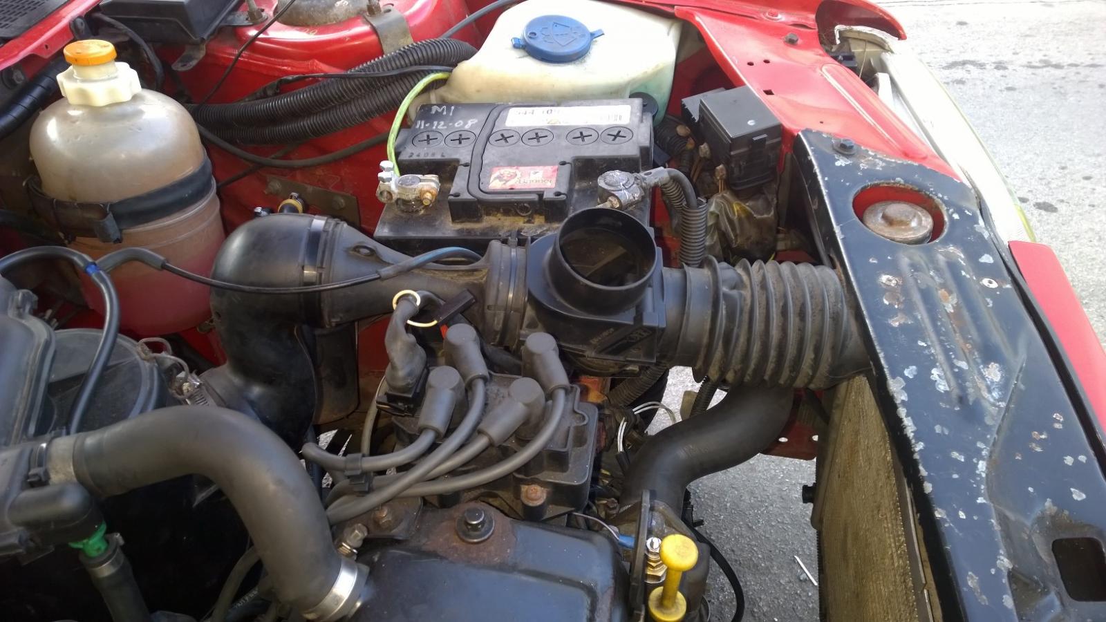

Once it warms, you wouldn't think there was an issue, when it gets low revs when warm, it will increase the engine speed slightly until it feels it's alright again. I've attached some photos since it looks like stuff is either unplugged or not there, around the air outlet in particular.

That's a single point injection engine isn't it? One thing I can see is that there should probably be a bit of tin on the exhaust manifold which has an outlet for some ducting to go to that spare connection approx 2" diameter on the inlet pipe. It looks very much like the hot air feed for cold starting is all missing.
Bit hard to explain but I think that the part just next to the HT leads in the top photo should be spun round so it's pointing towards the dipstick, then with the exhaust sheild in place it would have some foil hose to connect the two.
It's probably the cause of your problems to be honest! Plenty of cars with that engine in a scrappy, could be a nice little fix.
