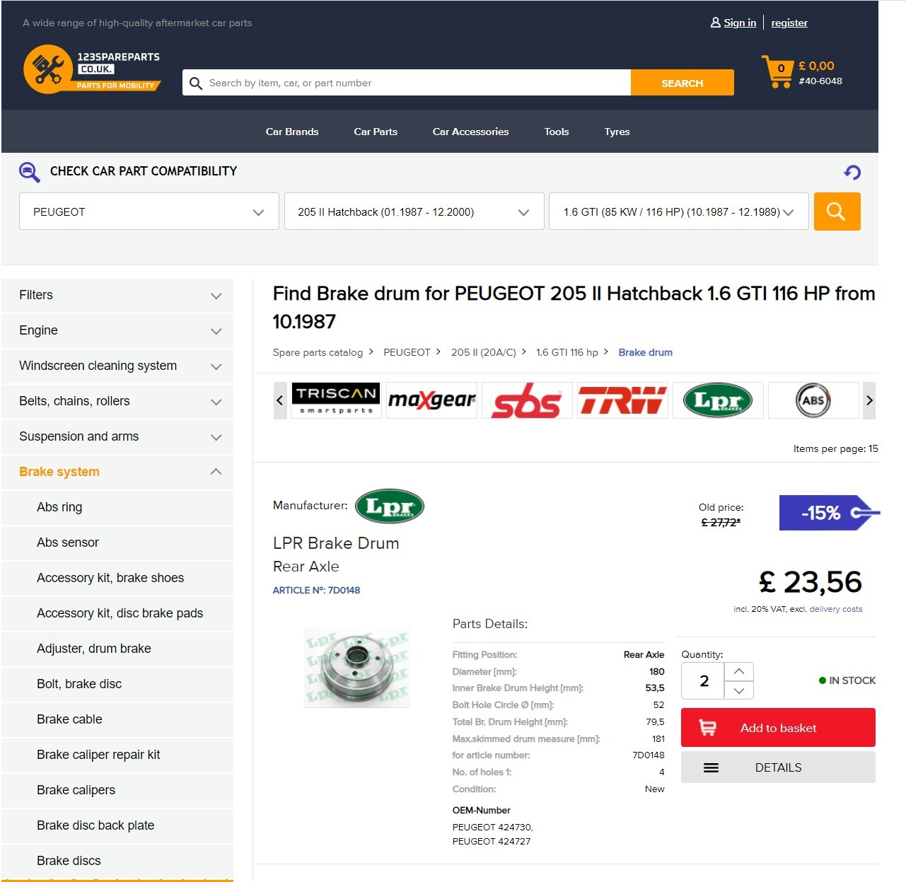

Thanks - I see many advertised on ebay (not OEM) with compatability listed for non GTI models but are 180 x 40.
I need the 180 x 40 for my GTI - so am I safe in any 180 x 40 drum, or is it not that simple?
Eg
Drum Diameter = 180mm
Internal Shoe contact width = 43mm
Hub Hole = 52mm
Problem is I don't have my old one with me to measure!

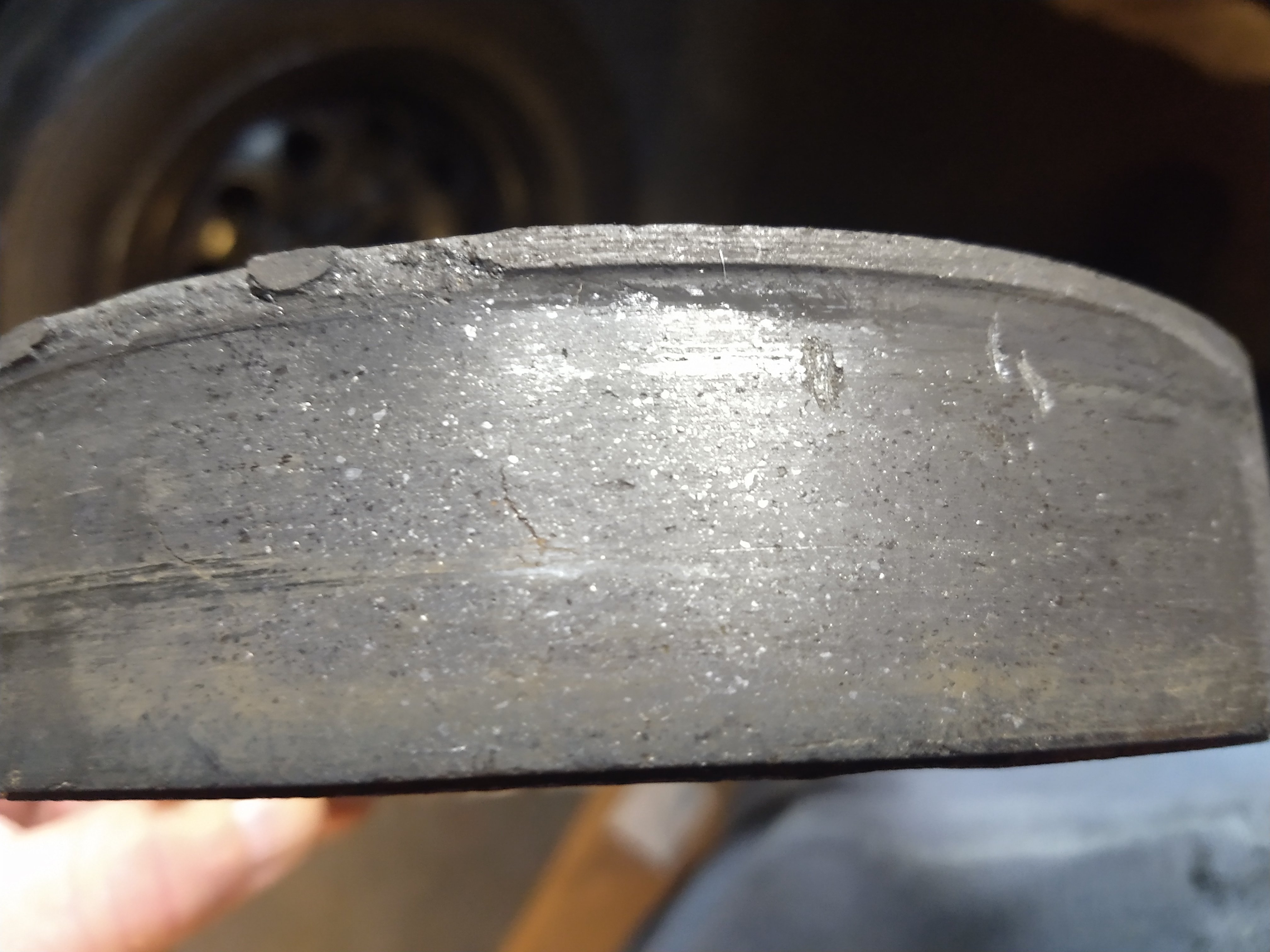

Thanks Bryan.  I have included some pics of how the shoes (all4) and the set fitted before the, have worn.  All 8 of them have this step at the back of the shoe, about 1.5mm tall and 3mm wide.  What intrigues me, is there is no matching recess on the inner surface of the drum... :wacko:
The step could be filed off quite easily, but we have bought new shoes to see how they will wear in the new drums.

Hi Arthur,
If there is slack in the bearing it allows the drum to cant over  (top-in, bottom-out). The axle stays horizontal but the drum tilts.
Cleaning up the wear on the one above would probably reduce the shoe beyond recommended minimum thickness.  You would have to alter the curvature as well. A tedious, if not futile, task with a file.
Your new shoes will save you all kinds of frustration.
While it is all apart investing in a pair of new hydraulic cylinders will ensure that the old ones don't spew fluid all over the new shoes.  Check whether Girling or Bendix by shape of hole in backing plate. Right and Left are a mirrored pair. (side specific)
The old seals will be working in a different part of the old cylinder when they are pushed further in to fit the new shoes. Further back in the cylinder is where moisture can sit and corrode the cylinder wall if the seals have been sitting towards the outside ends with older worn shoes. Fluid can seep past the seal if the cylinder is slightly pitted.
Bed the new shoes and drums using the handbrake on/off without too long periods. You don't want too much heat to build up. Drive the engine at a fairly constant speed and pull handbrake on for 5 or 10 seconds, cool for 10 to 20, then repeat as necessary. If you smell them give them some extra cooling time.
The foot brake puts most of the force to the front discs. No need to wear them in the process.
When they settle in you will find a noticeable dip in the rear of the car when you apply handbrake at low to medium speed. You can also tell if they are pulling down evenly. The car will pull down more on one side if they are not adjusted and bedded-in properly. There is some discussion on shoe adjustment on this site.
If you have been driving with the shoe above you will be in for a pleasant surprise in the improvement from the new ones. If your bearings were badly worn you will also notice an improvement in steering and general tracking.

Thanks again Bryan.  Your suggestion that the step is caused by bearing wear is one I hadn't considered - it could well be the cause of the taper across the shoe surface, but I still struggle with the cause for the step.  On the drum, the machined surface is lower than the raw cast surface -so if anything, the step should be a recess :wacko:.  It is also identical on the top and bottom shoe of each pair.
We are replacing the bearings as they fell apart when we removed the drums for this off-season overhaul - but hadn't shown significant play up until now.

if bearing wear was causing that shoe lip you would definitely know it, the wheel would be flapping about noticeably!

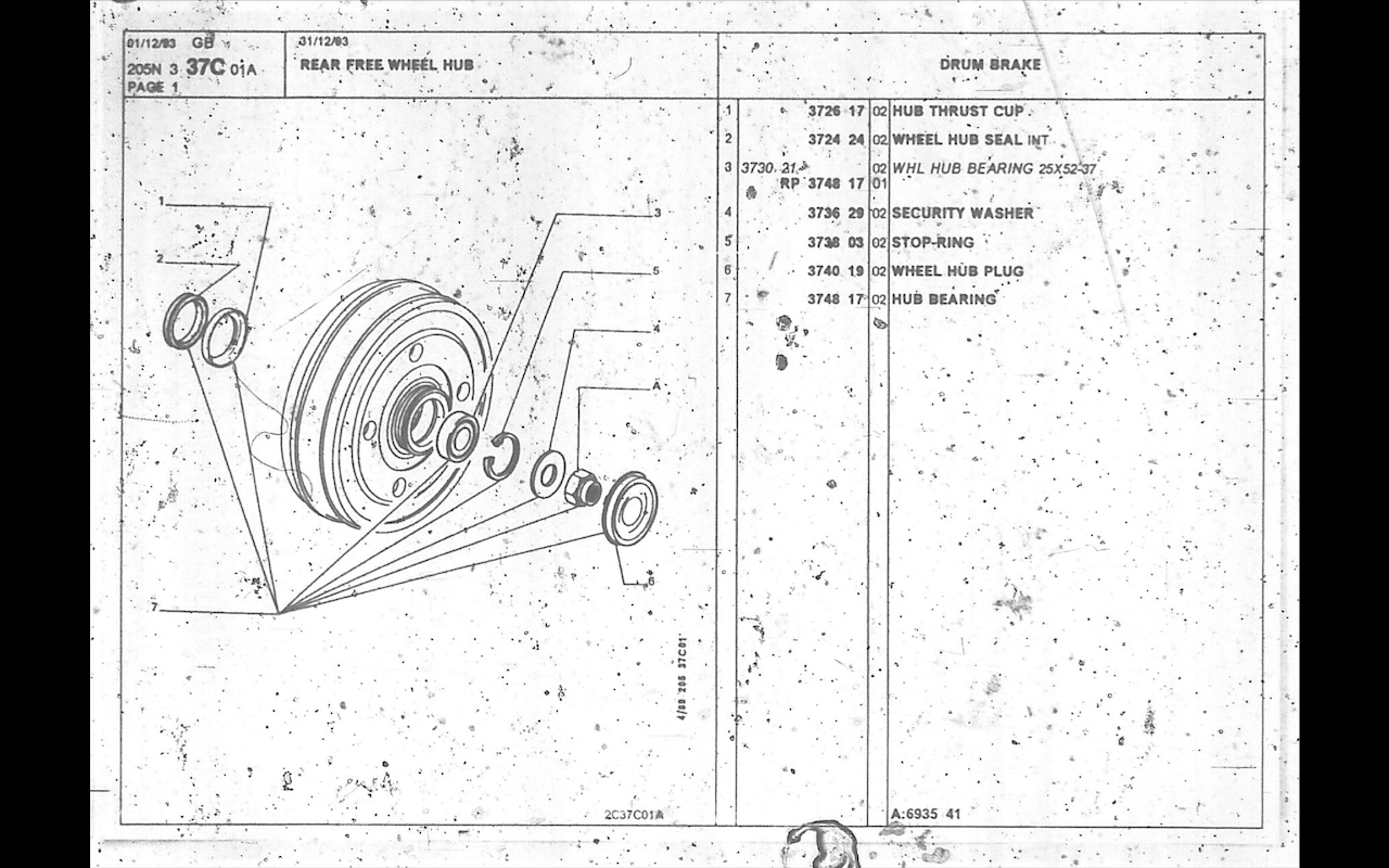

We are confused by the rear oil seal.  The new SNR kit includes a passivated steel 'retainer' and a rubber seal.  When we dismantled the drums we had the retainer, but no rubber seal that matches the new ones.....
The outside edge of the rubber seals is an asymmetrical 'V' profile.  The only thing the inside diameter seems to fit is the spacer that first goes onto the stub.
We assume the retainer should be tapped into the back of the hub - but flush with the outside - or down to the bearing?  And how should the rubber be fitted?  Facing which way?
I have found a very crude schematic of the assembly, but it doesn't have enough detail to answer these questions.
TiA
Gohn
arthur, this the 'crude schematic' you've already got ?
(I think 7 is supposed to read HUB BEARING KIT but anyway)
could you check the other side for retainer and seal assembly ? or that's already off too ?

Thanks Andrew, yes. it is the schematic I have seen.  It is items 1 & 2 that I am referring to.  Both sides are stripped down :rolleyes: - and, I'm still confident we never removed any rubber part with an OD as small as item 2 (Wheel Hub seal (internal)).  I think Item 1 should be fitted with the flange on the outside of the assembly (facing the training arm), it would look odd the other way around, but the rubber seal is asymmetric and I can't deduce what is the correct way around.
